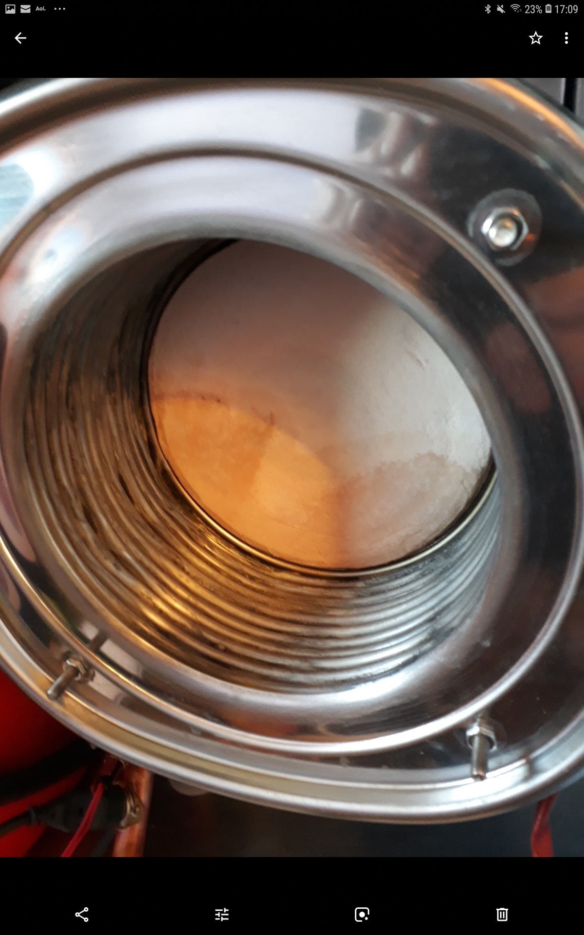

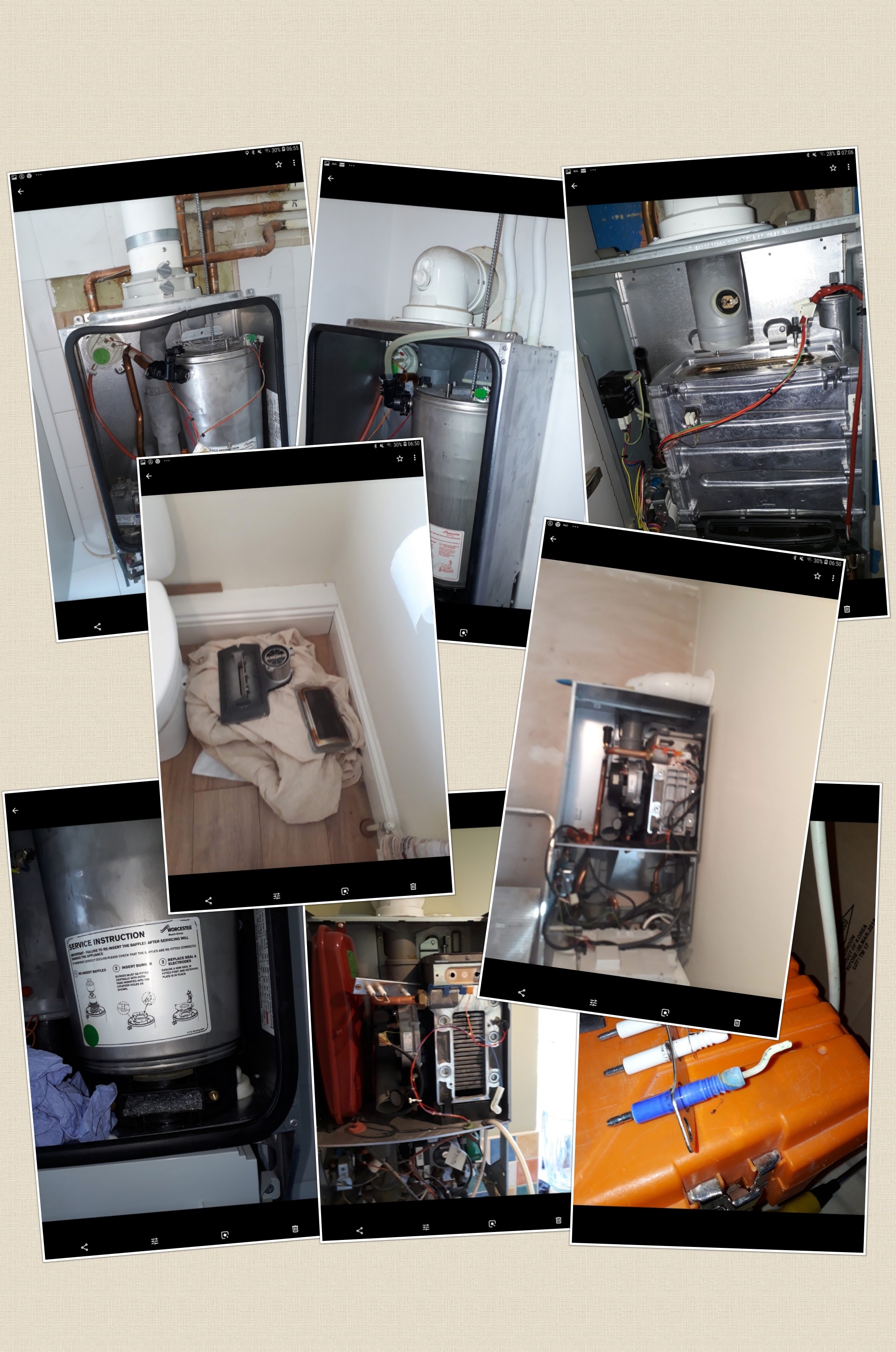

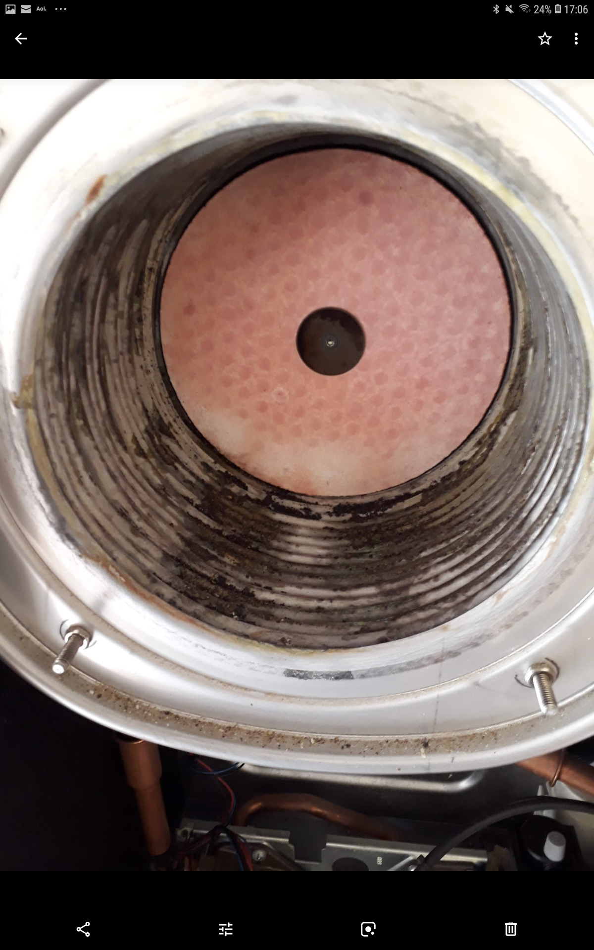

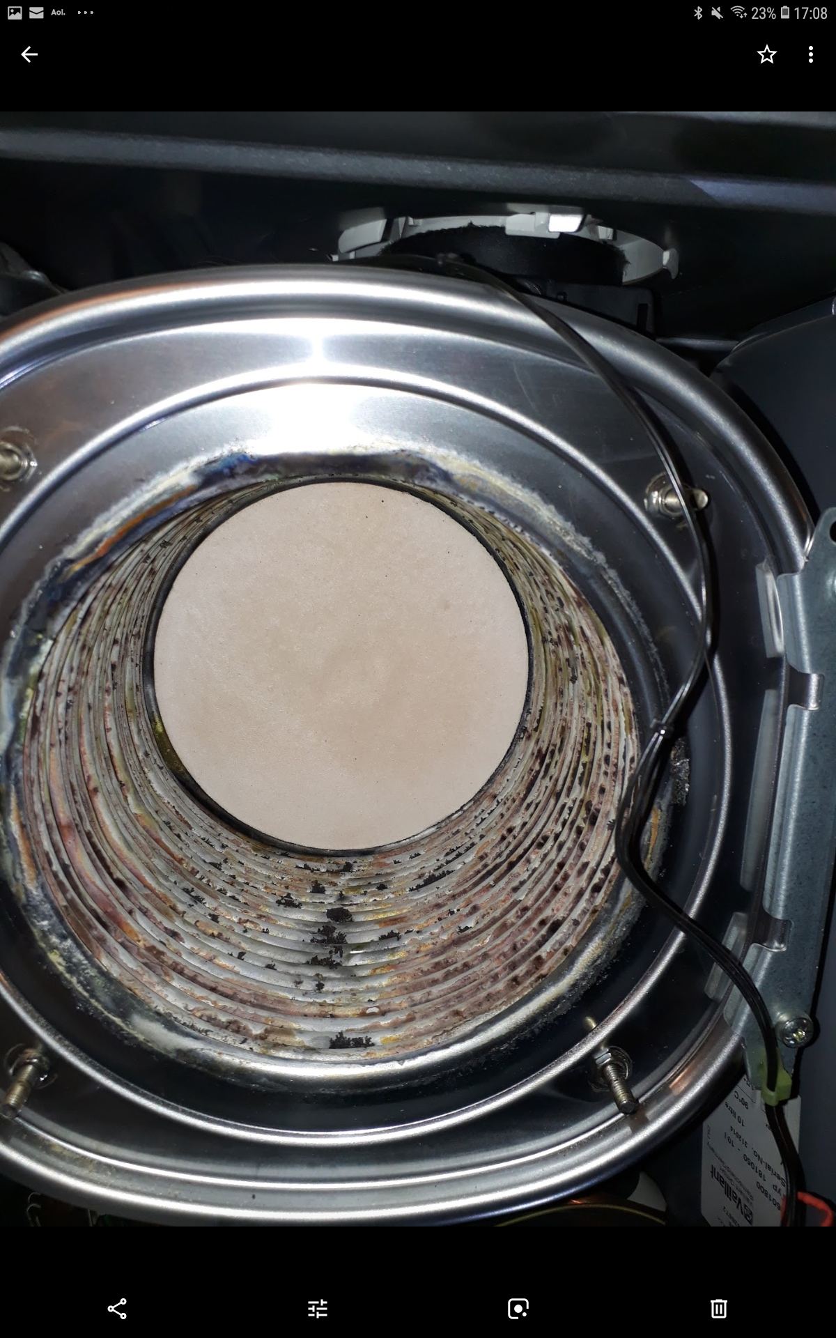

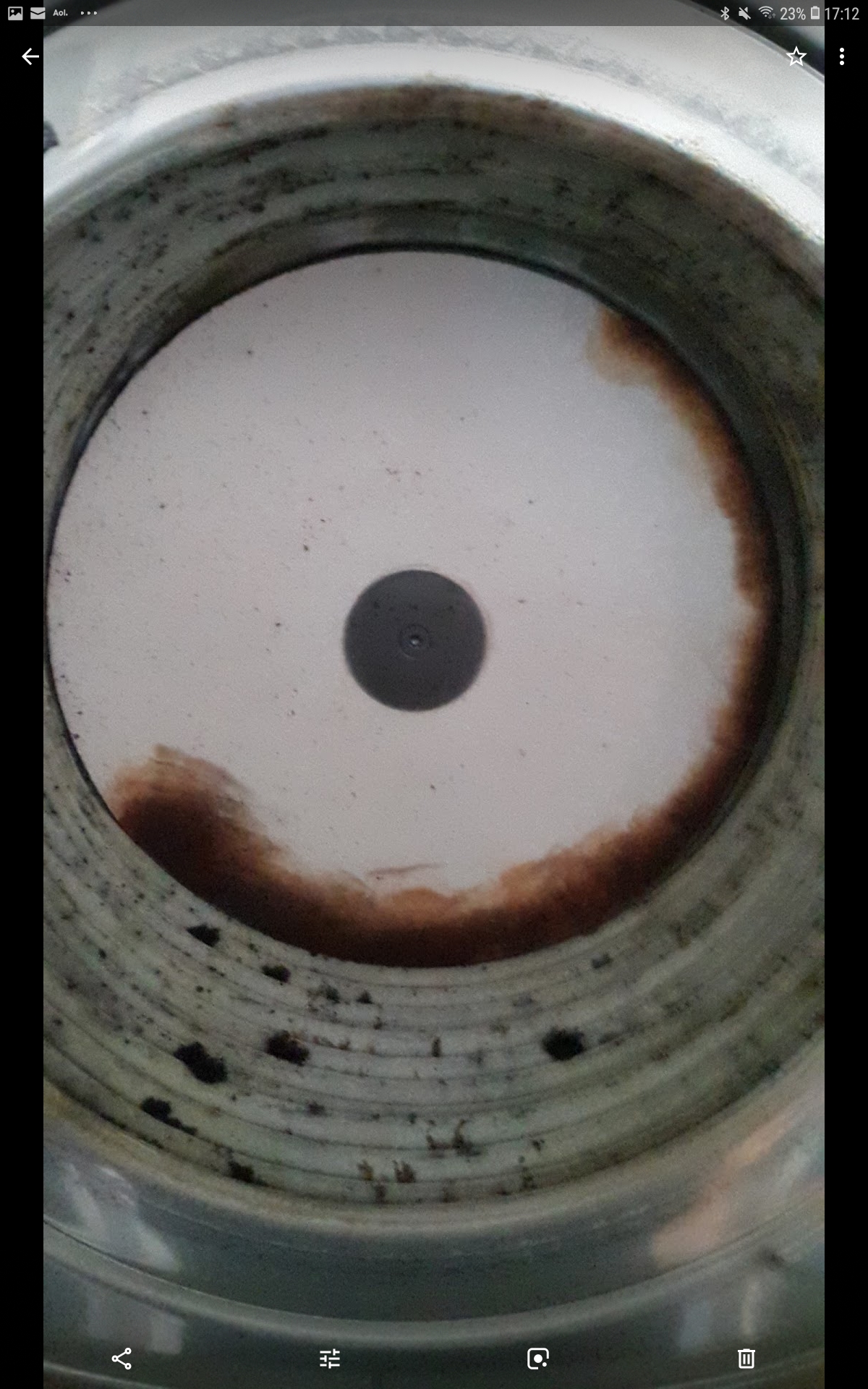

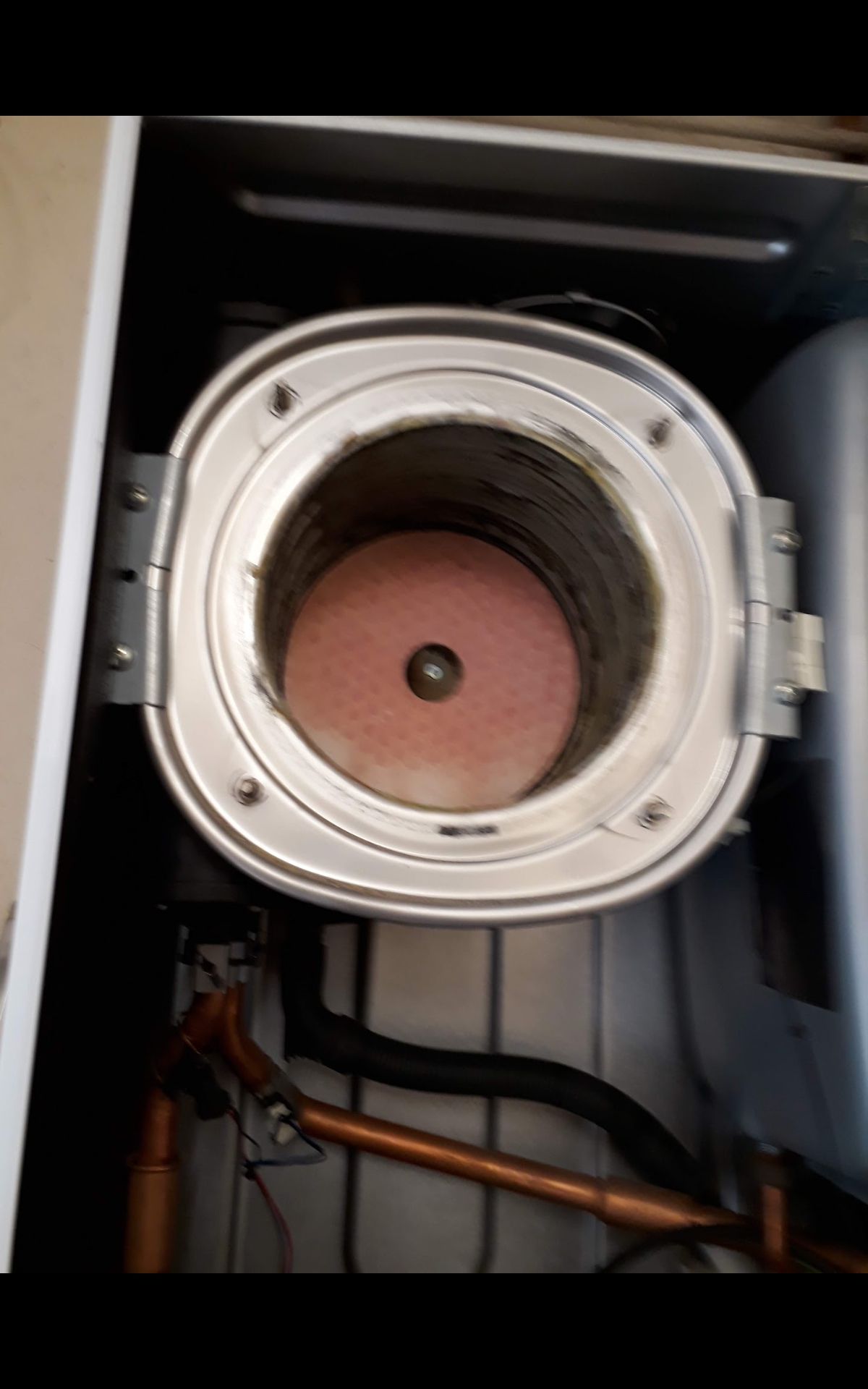

Greenstar classic 34cdi combi Ron looks a bit different when stripped mate , agree with you the valliants I service get a heat x clean a flush through and a new G10 seal each year what do you use to clean yours . Kop
Nice service too.
I change on each service the graphite seal G10, electrodes, clean main heat exchanger, flush it out, clean siphon, drain expansion vessel, re charge the vessel, fga, gas rating and my ****.
To be fair I use a lot of elbow grease as I can’t get hold of a special spray for boilers here in uk. Now, I use hard plastic, soft plastic brushes. I used to buy a toilet brush and cut to size which works very well. Viessmann has got a special tool to clean in between the riffles which is a great tool though.
Once all done I use the supplied lubricant before I close the burner. If the heat insulation foams require changed I always do if required.
On Worcester I am taking the exchanger out which is done in 10min and then flush and brush through.
Tomorrow I’ve got an old turbomax apparently serviced each year 🙂 will see what I am going to find
You could use something like Conel Care 270 that’s designed for oil boilers and gas boilers which have a silicium or stainless steal heat exchanger

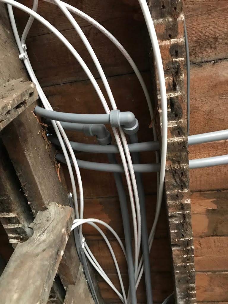

This will make you laughter look what I saw today called in to see my electrician mate on a job this is a new heating first fix pipework install shocking in my opinion and a disaster waiting to happen some people !!!
Why did you need to phone GS? Only thing potentially above NTCS is if it was too close - and then only with signs of distress. Not all cookers need any space.
I phoned because I wasn’t sure how to judge this therefore I called them up. The way it looked and was installed, i would have AR without second thought. I phoned the cooker company and made sure about the space though.
Yep sure did they know its total s---- !The problem is the installer is local to me and I often bump into him but had to say something personally I will never mix manufacturers pipe and fittings and I am sure theres better ways of first fixing that job . Kop
  • Agree
Did you actually say something to him in regards to this shocking work?
No Ron just made the client aware that it's not acceptable I am not involved in the actual project so have no say in it i am afraid . Kop

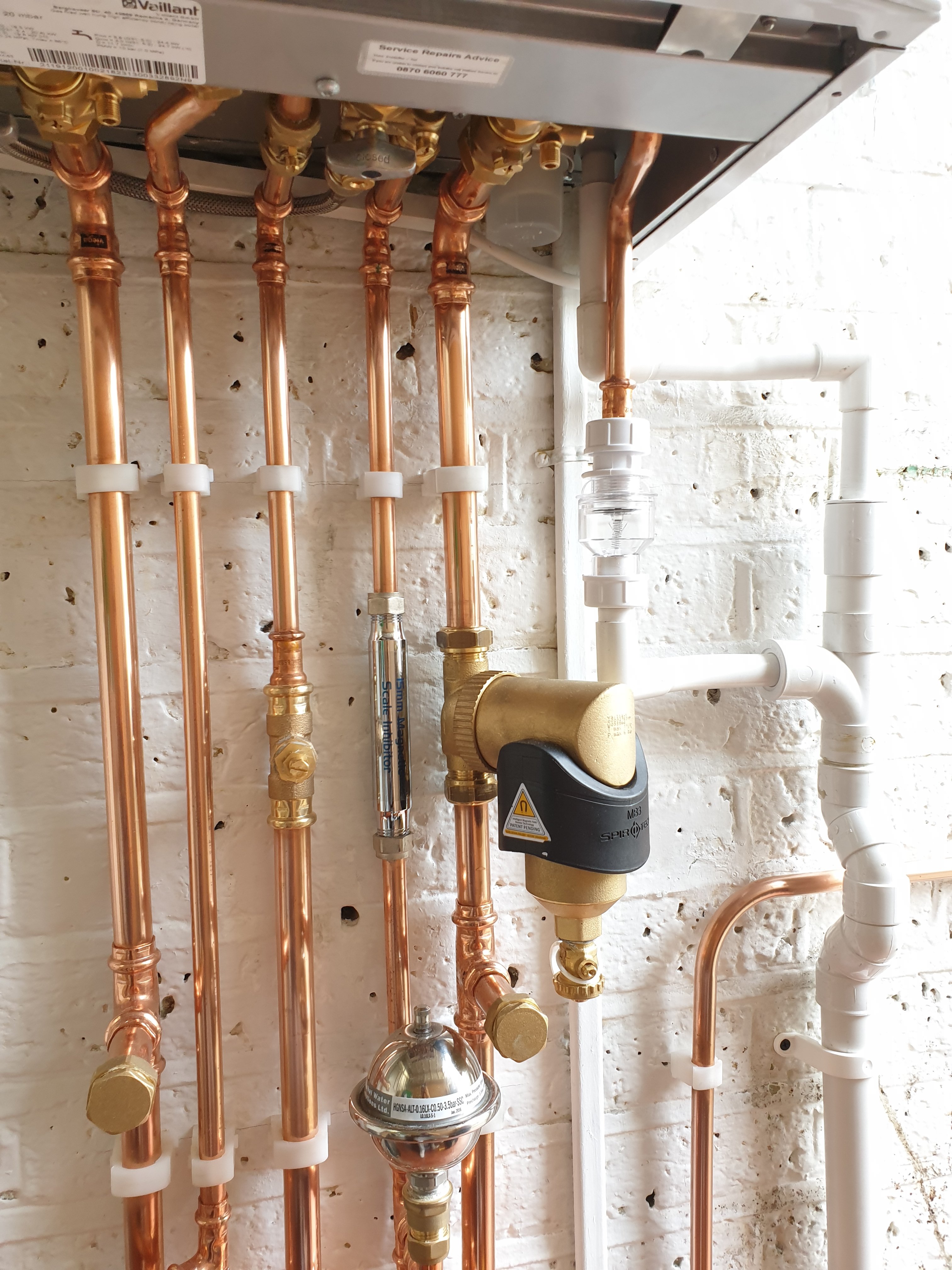

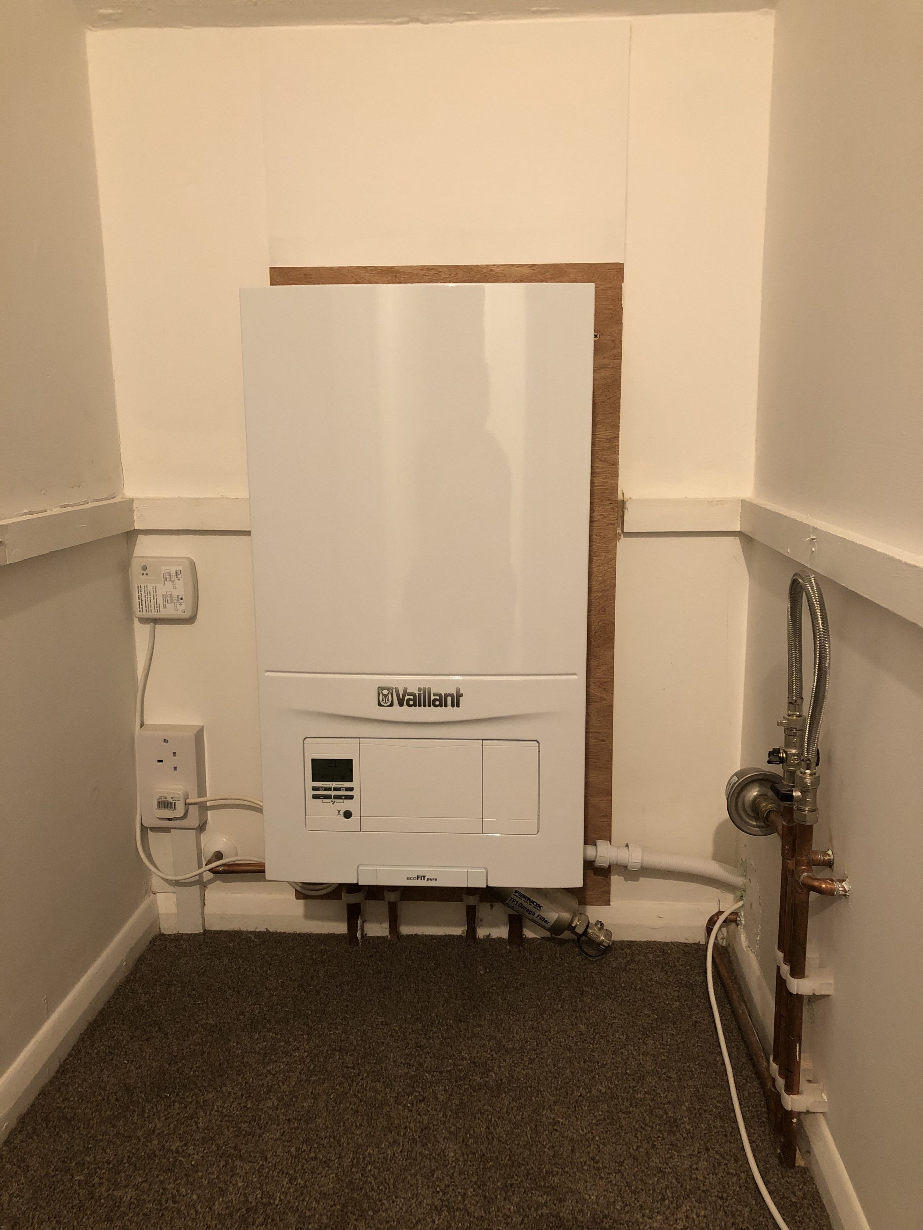

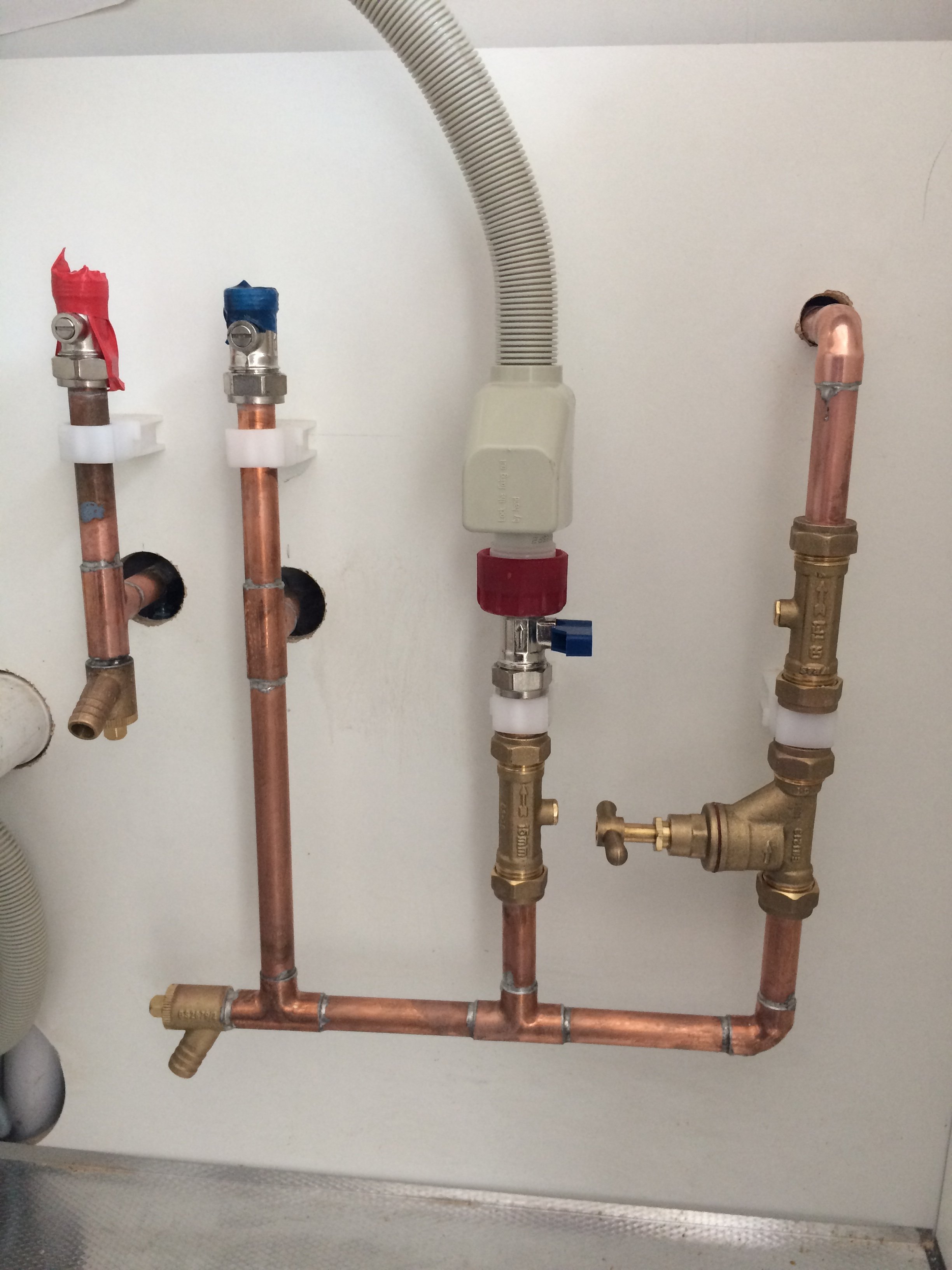

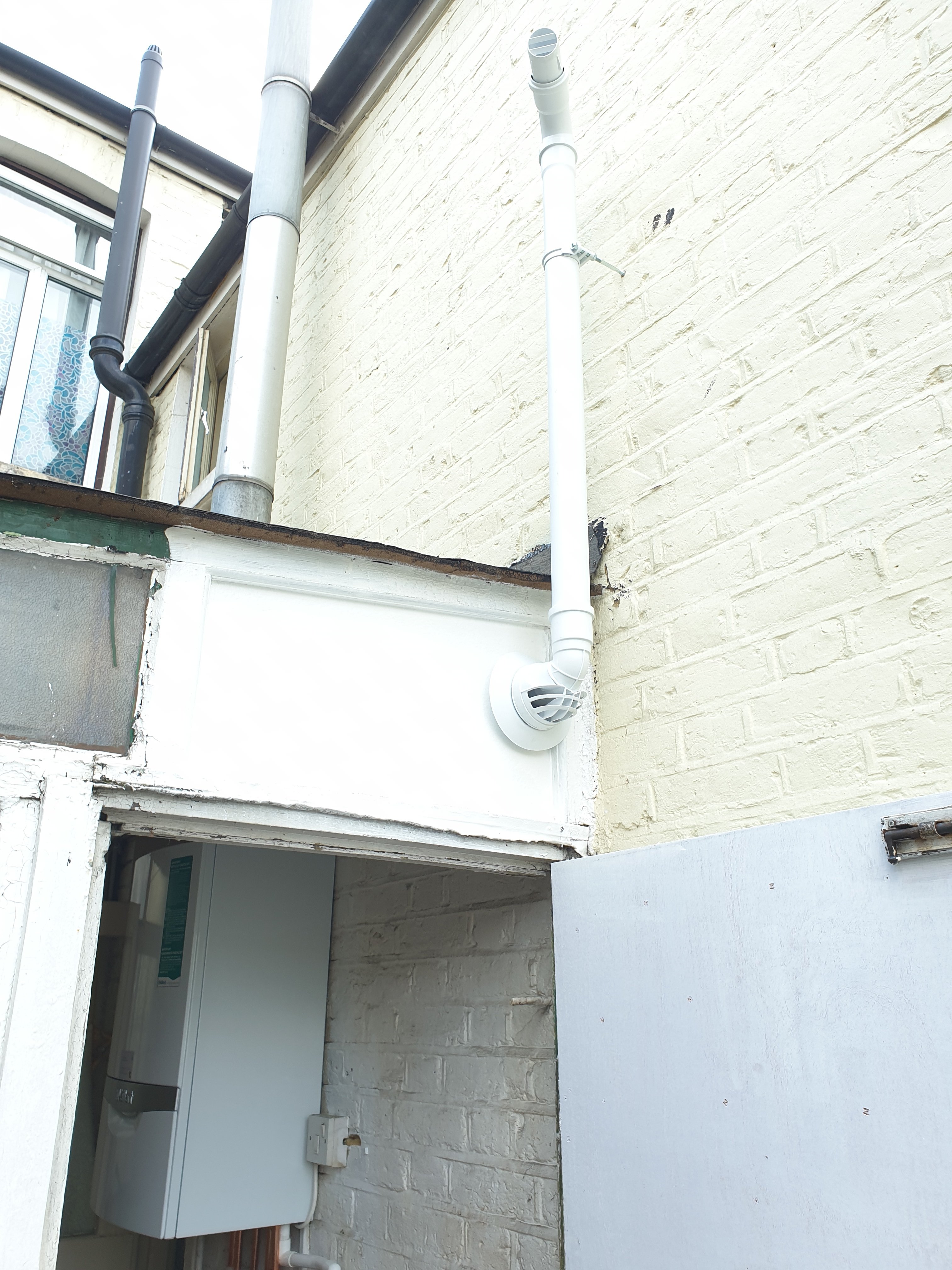

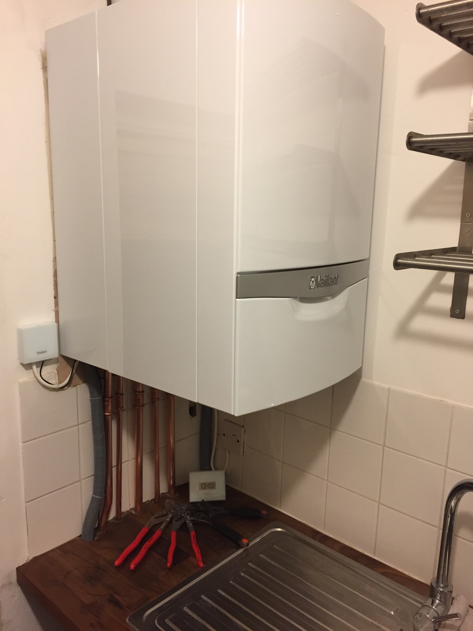

Hi guys just an update on my saturday's install.
Thank you first of all to all for giving always a great advise and help.
Would you recommend putting a plume on ?
Very neat.
Is it an 825?
Are the 22mm capped pipes for power flushing?
It doesn’t look like 300mm to the door so yes a plume kit is probably needed.
Reactions: Old Account
Very neat.
Is it an 825?
Hi Scott,
Yes it is a 825. The capped 22mm ends are for future if somebody doesn't have the adapter so he has got an option to flush from without the need to cut into the pipework. It's not really 300mm so I will return and get the plume connected. I had one with me but the bend was missing for the terminal.
I'm happy you like that one.
Nice work, but yes on the plume kit. Too close to the door opening and an internal corner.
One more thing, seems as your going back, for the sake of your reputation please change that hideous black clip for a white one 😱🙄😀😛
Totally agree with you I run out and it was late so I had to use what I had 🙂 but much appreciated for the honesty
Hi Scott,
Seems a bit over the top
Hi Scott,
The tees sound like a lot of time and money for fittings for somebody else’s benefit!
I actually use the connections too when I do an install as I do not think it's really good to remove a rad to flush. I also haven't got yet the a spirotech adapter so it's fine🙂 don't think it's much over the top but beneficial
Reactions: Scott_D
Actually I do exactly the same thing and have done for decades. Finally we have common ground on😉
Common ground sound good 🙂
There are still things I would do better but sometimes the price won't allow for all items. I'd install some lever valves below the filter, deaerator and of course below the scale reducer just for the sake of service purposes.
Lovely neat install.. well done
The only negative thing is
Press fit🙁
Thank you very much. I love crimping as it is faster, cleaner and eliminates safety hazards. I can also do my works when water is dripping and if I have an issue with turning water off I can also cut live and put a crimping valve on. But as you know everyone likes different things.
Everything has its place. I use a combination of soldered and crimping now. Same as using plastic, not my first choice but it has a place
It's just the way you are trained over the years. I used to solder a little when I started working in UK but i went back to crimping which is what I like even though it's more expensive. I definitely do like rushing my works though as I am not happy in the end with the results. I think it would be fun to have a little race though😉
I totally agree with you. Plastic is the last resort but sometimes worth doing especially in tight spaces.
Nice install Ron would have renewed the switch spur though bud it got to last another 10years . Kop
  • Friendly
Thank you KOP... that’s actually true though. It’s not a perfect install then. Next time, I will be more in detail and try not leaving anything to point out. I love when other engineers give honest reviews. I am not afraid of perfection 🙂 I will never reach it but I can reach always a higher level.
Thanks a lot for your input and giving more motivation

couple of things
gas 1/2 to 22mm tee isnt gas rated
flue needs another clip on it
mac nrv isnt pressure rated and not safe for boilers only overflow
how come no lagging?
I like you Knipex and Bahco tools Matchless...
Thank you mate but I'm sure many of us have them as hand tools. I will never change the knipex these are every penny worth as well as the bahco top tools shouldn't be missing in any hand tool bag.
couple of things
Appreciate your concern but don't see any problem with the gas pipe whatsoever. 22mm to 15mm very standard. Vailla r has 15mm connection which means I always reduce below the boiler. Flow needs another clip? For 1m of flue? I think that's a little over the top though. Everything is safe and secure installed. What you mean with the mac? How is that not safe ? Nothing is going to happen and if the prv opens it's going safely into the waste pipe. No lagging due to price cant do all for peanuts. Not many people are committed to pay for all materials.
Is there any positive word from you rather than just pointing out? Perhaps you show some of your installs. I don't mind and appreciate your opinion as mentioned above. But give also some positive feedback that would be much appreciated too.
I don't think I did anything wrong. I'm happy with my boiler swap

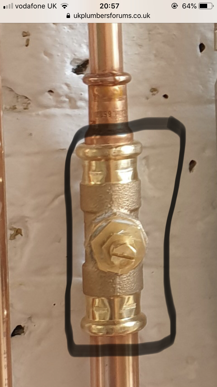

The test point tee not rated for gas
Every 1m or change in direction or a joint
Mac nrv isn’t rated for pressure and if prv opens it will split the nrv as there designed for no pressure / gravity
Lagging is a must for external installs

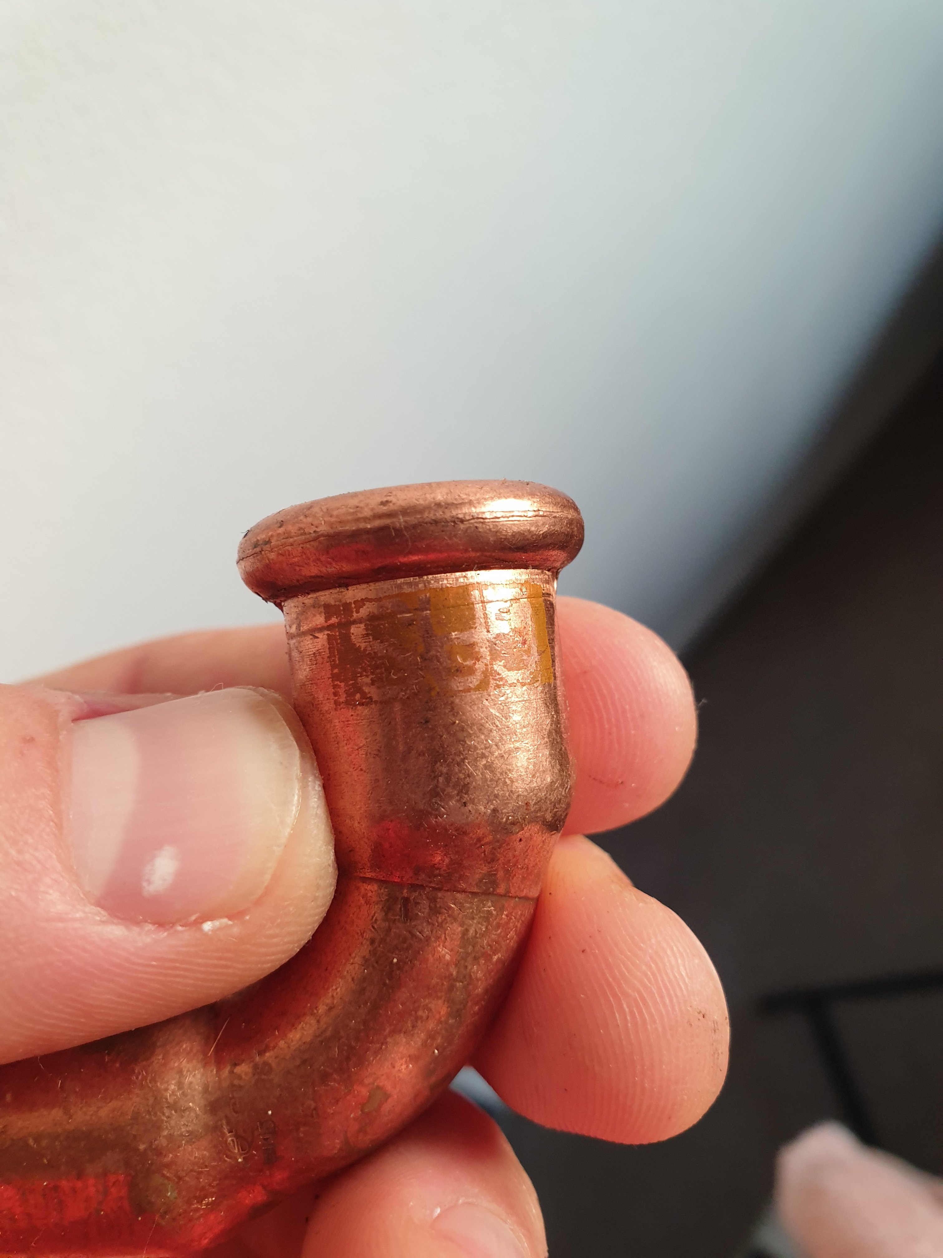

What wrong with the tee?
Assuming it gas gas o-rings
No gas markings and tee not suitable because it’s not labelled as no one knows later if someone’s changed the orings etc so will be cut out as it will be classed as not suitable
And gas safe could get involved
  • Agree
Reactions: Harvest Fields
You cant see much the markings due to the discolouration. Everything is gas rated with the right o rings. Are the x press fittings rated for 630c to withstand 30min ? Viega fittings are and therefore I use those as they are the best fittings you can get.
Don't be worried all is done to spec. It's just o e of Shaun's concerns again. He always give out but never props other people in positive way. I am used to it by now and I'm not bothered by it.

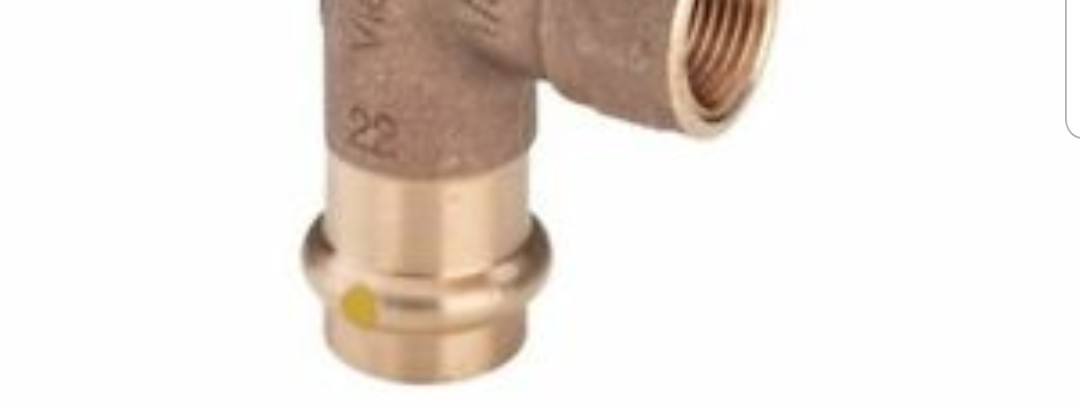

He isn’t on about that fitting Ron.
This one I believe mate?
That is gas safe with the right yellow o rings which are highlighted at the site of the fittings. It has a yellow small dot. But you surely know if you swap the o rings too you can use any fitting song you?
Harvest I know what hes on about but does he also support people without pointing things out? Never seen him giving some props to others ... he must be a very unhappy person 😉
Dont take it to heart Ron our Shaunie will always find something mate he doesn't mean it in a malicious way just has a eye for the slightest imperfection , as long as your happy with your work and abide by the regs and manufacturers instructions then your all good. Cheers kop
I'm not but don't get me wrong though wouldn't it be better to props sometimes some other engineers? It doesn't come across really good either just point out. If I wanted I could also find stuff which should be changed or amended. However, I'm very happy with the works. I would also change a few things but sometimes the quote doesn't allow for doing better works as I am not going to pay from my own pocket.
