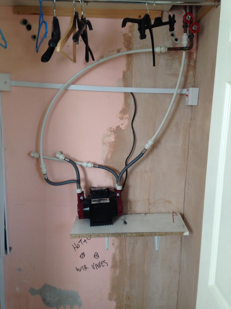

The bench was a real neat fix! :

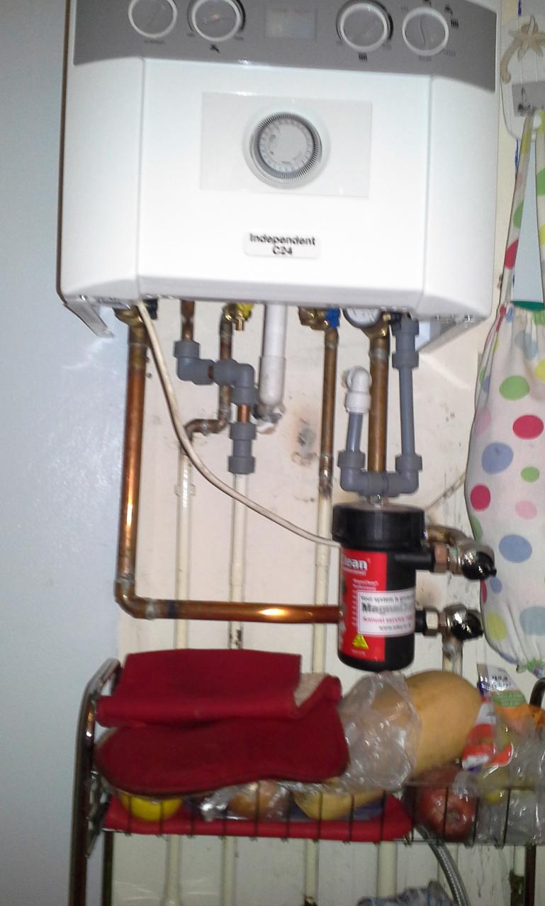

Boiler Install
Boiler was less than a year old. Fitted sideways so no acess to change anything at all on the boiler. Main heat exchanger blocked due to installer not flushing system. Huge holes left in walls, condence termiantes on felt roof, pure lazy as it could have been run 3 meters into a drain. Flow and return run in 15mm. Biasi refused to do anything obviously as installer had left no acess and fault was due to blockage.
Ended up fitting new boiler on rear wall so now at least you can change a part if needed. Flushed system and fitted a magnaclean.057.jpg058.jpg059.jpg060.jpg061.jpg064.jpg062.jpg
Ended up fitting new boiler on rear wall so now at least you can change a part if needed. Flushed system and fitted a magnaclean.View attachment 8546View attachment 8547View attachment 8548View attachment 8549View attachment 8550View attachment 8551View attachment 8555
