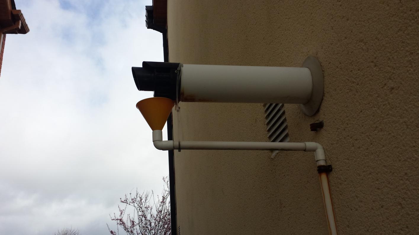

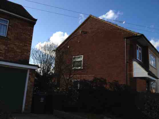

First call this morning. Could see the fumes coming in the window. Flue is an old Worcester one but boiler is only a couple of years old. There is a balcony above as well. IDed it and going back tomorrow to put a new flue and plume kit on.

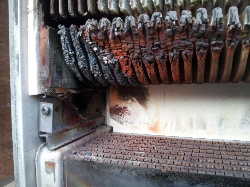

Hall of shame for the old Ideal Isar...
Blocked condensate, filled back up into burner caused boiler to not ignite but fill with gas then boom. Lucky..

i found one like that when I worked at the council.
No one had ever changed the earth pins and the insulation had fell onto the burner causing the flame to burn through the heat exchanger.
I found it on a service, the boiler had been working fine and the tenant hadn't reported a breakdown or anything.
God knows how long it had been like that for.

dont know if you find the same tom,admittedly its mainly icos i see so not as stressed as a isar,but if its stripped down every year and the ionization probes or pins are checked for condition and correct location they dont need changing obviously different story if there damaged that goes for insulation as well if its cracked new expensive one piece affair required

Well cooked, combustion ratio through the roof. Boiler knackered. Bet the Logic don't last as long though.
Ay ideal logics wonderful. Front silencer will be first thing to go and burn out pcb and then out of LCD before combustion pot

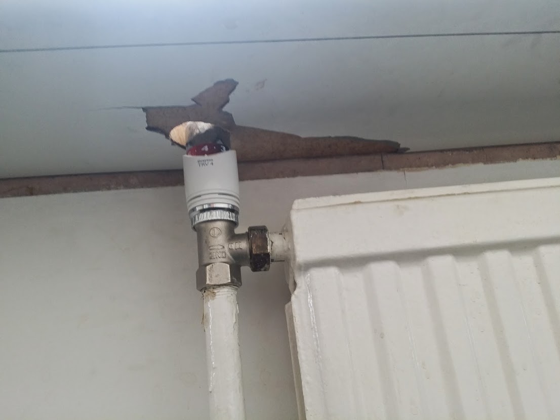

Cracked it - the rad is at high level so close to the ceiling that it clearly is not intended to heat the room it is in therefore must be a a form of underfloor heating for the room above & of course with the sensor of the TRV head detecting what is going on above you have temperature control, simples :wink_smile:
Just take care you don't kick or trip over it when in the room above.

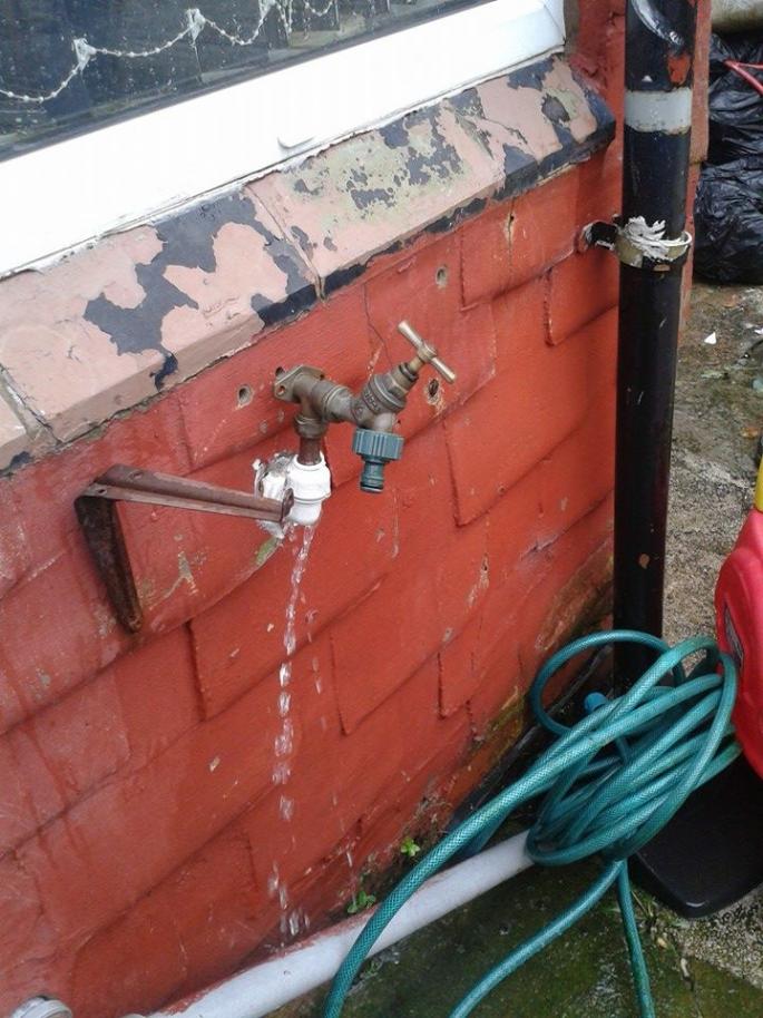

over flow 1.jpgoverflow 2.jpgoverflow 3.jpg we went to fit a hob before and come across this
its the over flow from the CWSC. another diy job instead of getting a plumber to change the washer in the ball valve. i bet this cost more than getting one.
Also, The brickwork joints are a bit tight and should there be rusty screw on the down pipe. Oh then there is the outside tap with slightly doggy back plate not secured and tap at an unusual angle. how picky can one get?
