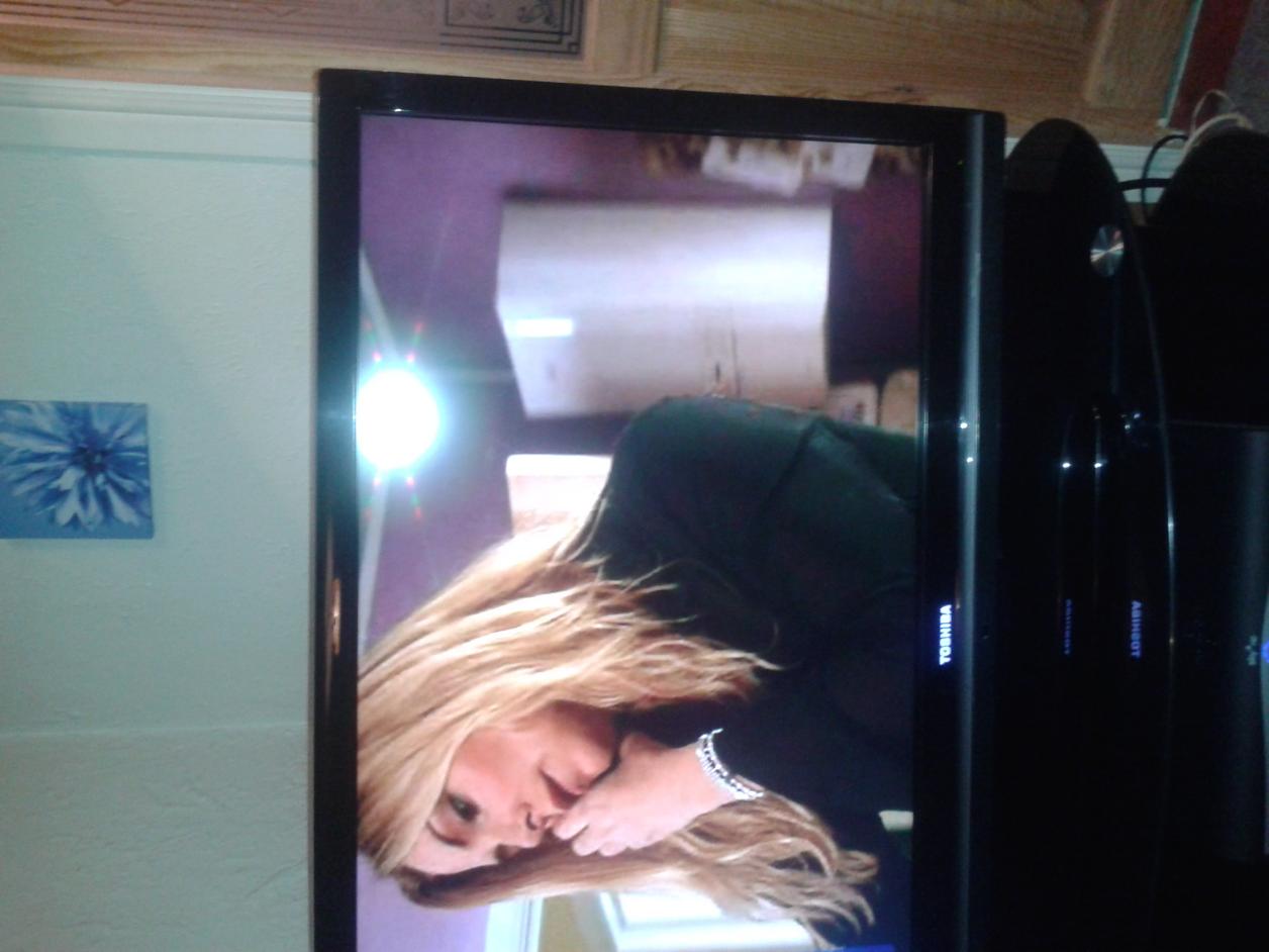

probably about a year ago deadenders did a CO story. The boiler on the wall looked like a cardboard box with some painted on pilot lights ( think there were 2 / 3 lol) and some pathetic streaks of muck what looked like skid marks. The BBC budget at the time must have been well and truly screwed tight.
before everybody starts taking the **ss .. I DO NOT WATCH IT, HONEST
The next episode featured Ian Beale fitting a new gas boiler lol...

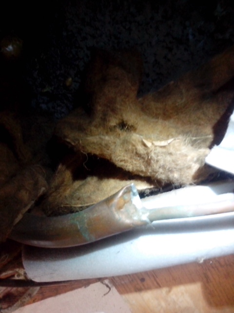

(R)Photo0015.jpgdouble trouble... young plumber threading pipes too close to edge of stud and blind plasterer screwing through both left and right pipes......6 weeks before leak showed..btw the chewed up looking wood was me trying to find leak..

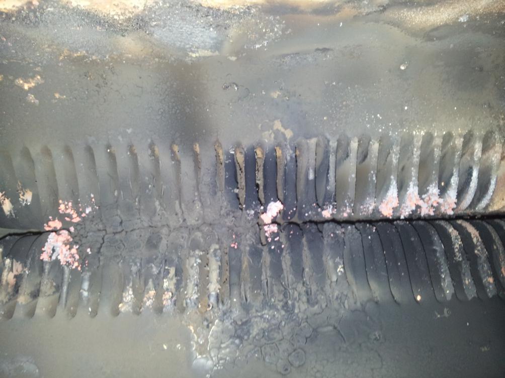

how many of you would service this? Ideal Concord installed in 1977, been there 3 hours today, cleaned all, plus replaced case seal and pump, but not giving it much longer. Looked like chimney sweep afterwards, bloody thing

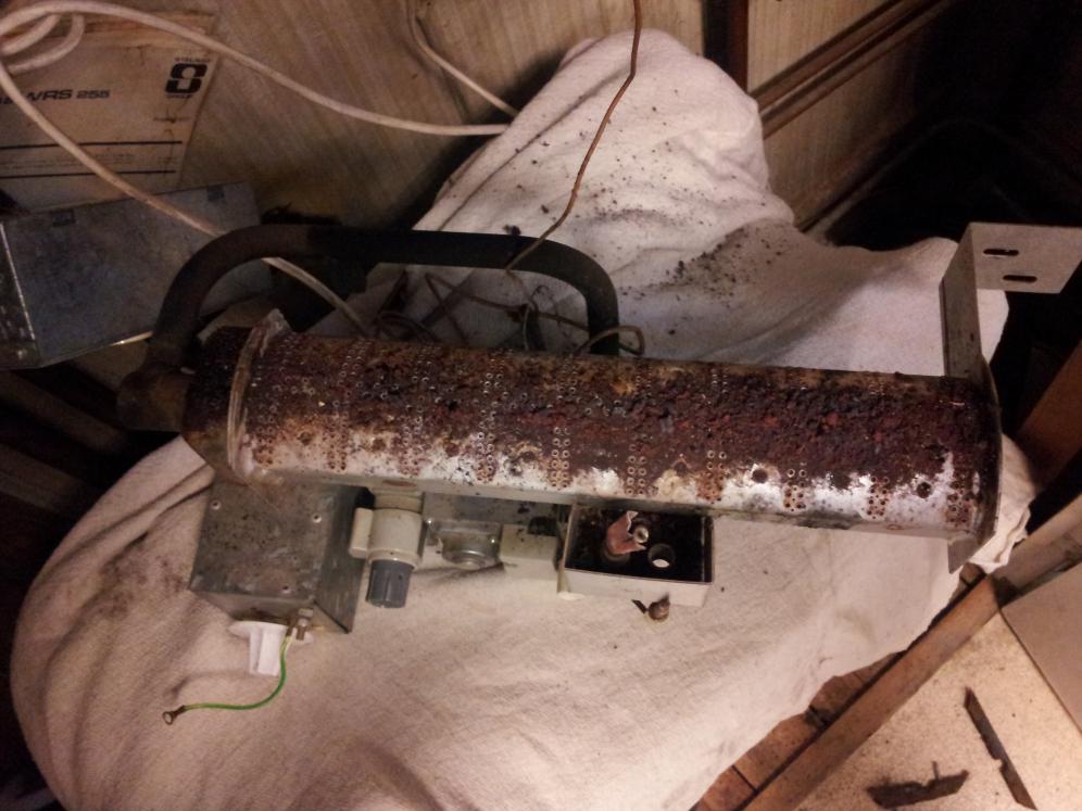

Ah, memories! Had two floor standing unit heaters in a factory unit once, place had been empty for some years and new occupiers had got units running but were complaining about smells. Didn't know when they'd last been serviced either (reckon they'd just gone in and switched them on). Turns out chimney terminal had gone from one and heat exchanger had rotted out so fumes were going straight back into the unit. Shut it off and cleaned up the other one and sorted it out but it was on borrowed time!

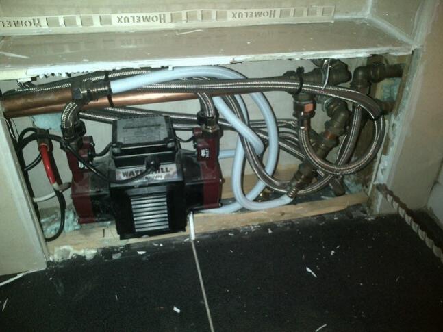

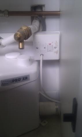

With all the room available why put it over the lid that I need to remove? Not to mention using an olive compression fitting on white waste overflow pipe.

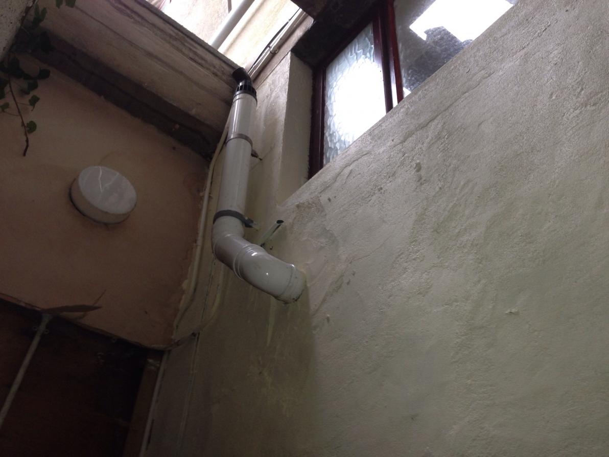

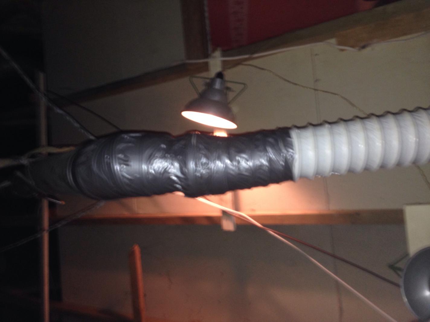

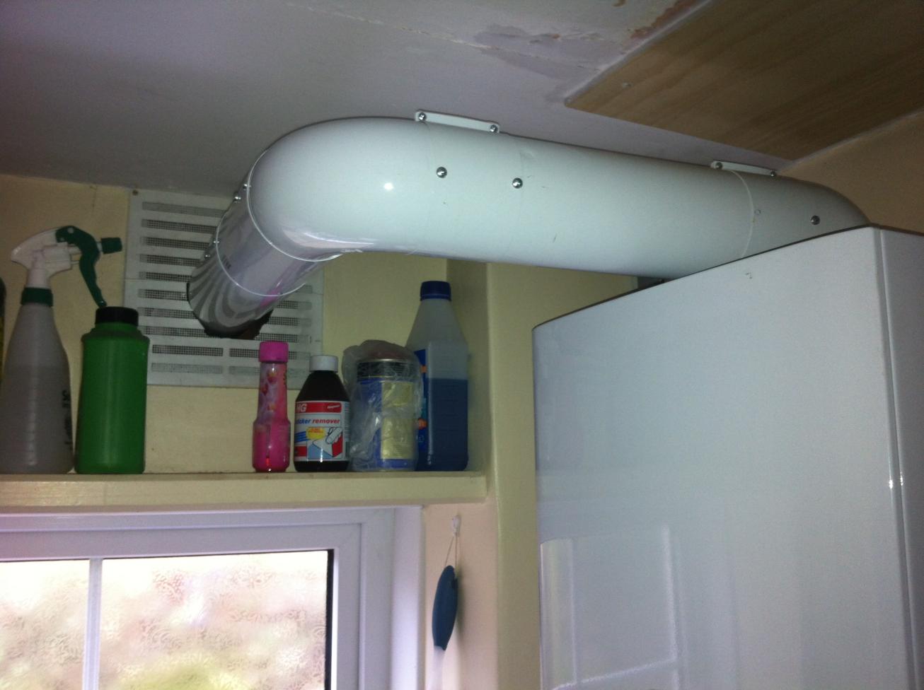

Ingenious use of an old boiler flue to run an extractor fan. Approx 4 metres straight up to peak of roof. Funnily enough it doesn't work

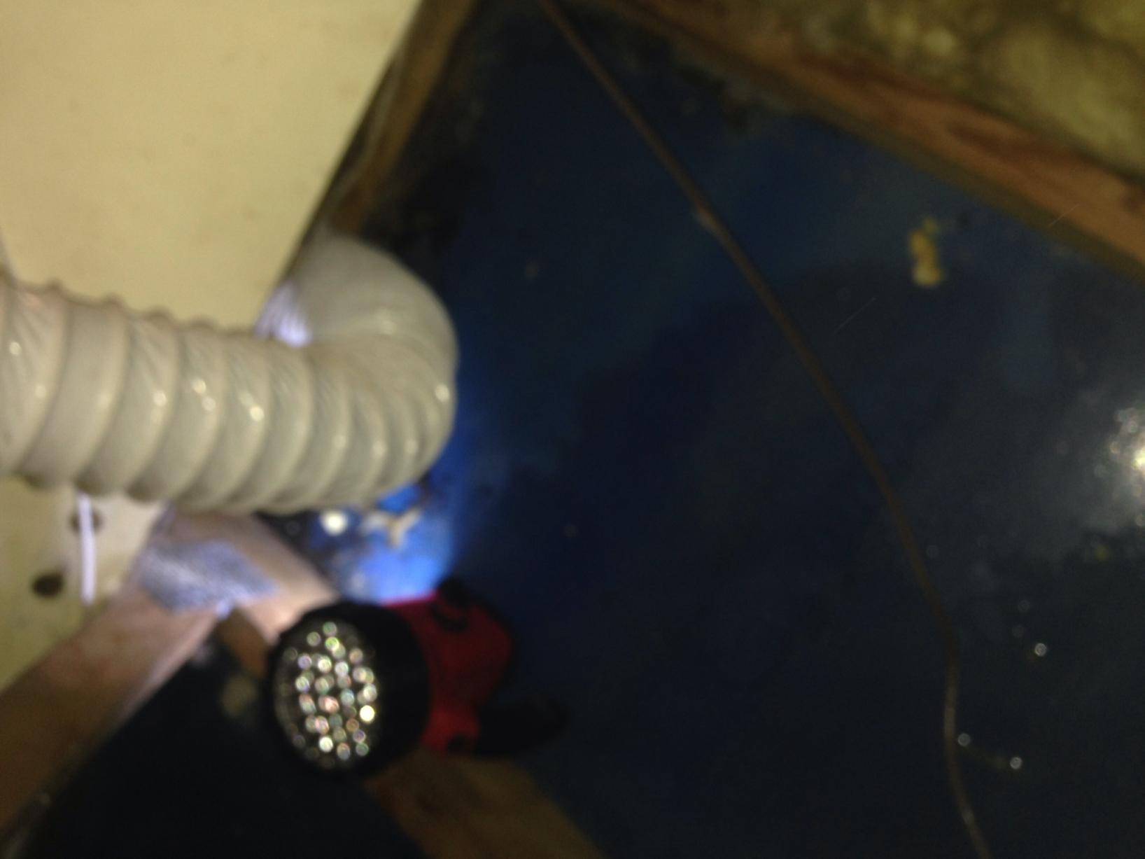

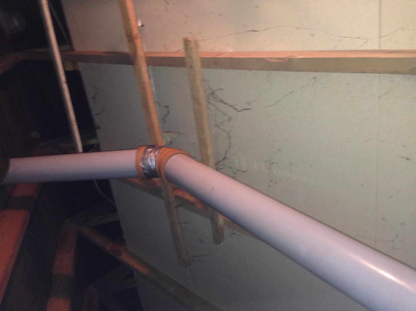

Same roof they have re routed the soil pipe by means of a dryer hose around some botched loft flooring. Very little to support it and they can't understand why the flashings moved and they now have a serious leak. image.jpg

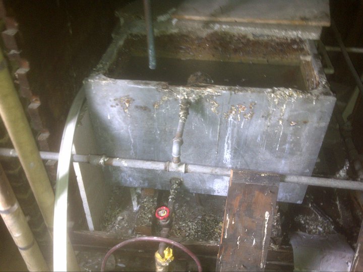

Until I got there, this was being used to make the tea in a very upmarket designer clothes shop! Perhaps not bad workmanship as such, but is a lesson to leave the lid on and roof door shut! The pigeons seemed to be having a field day.
That's just the beginning, the whole house is a nightmare.
