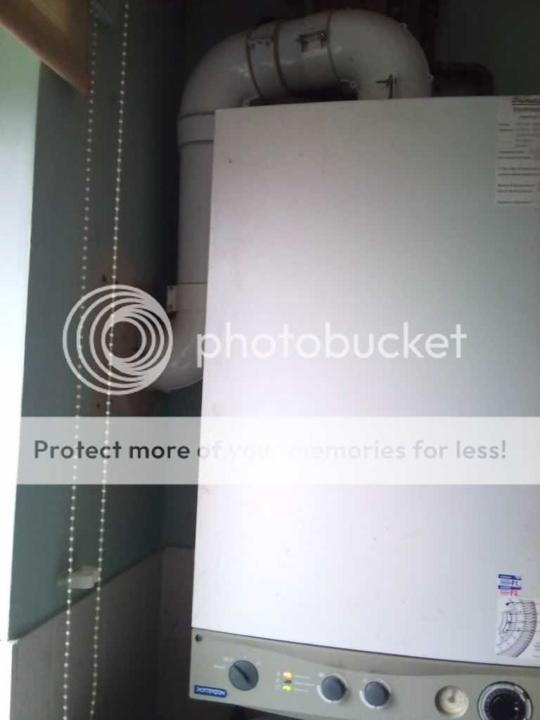

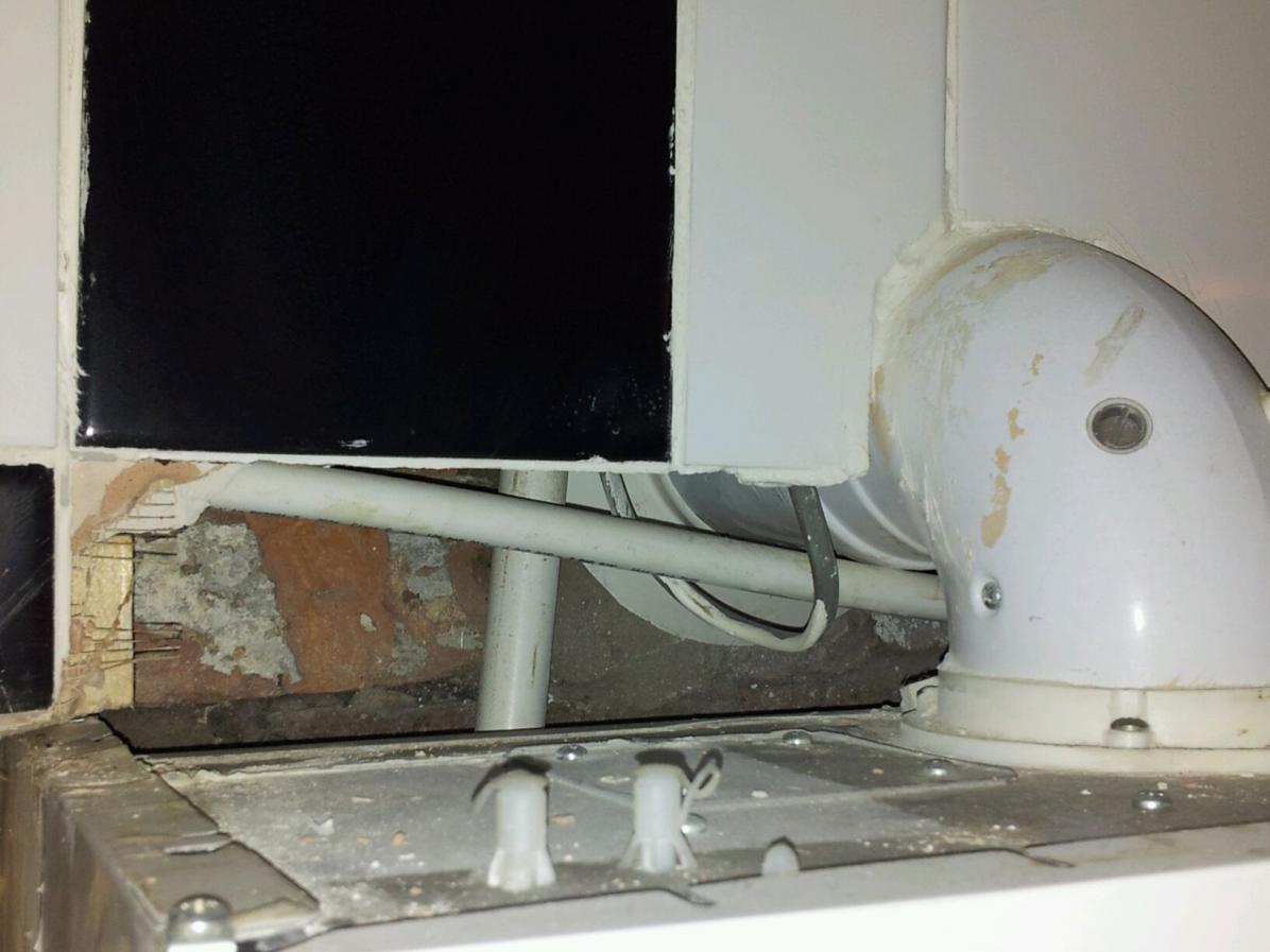

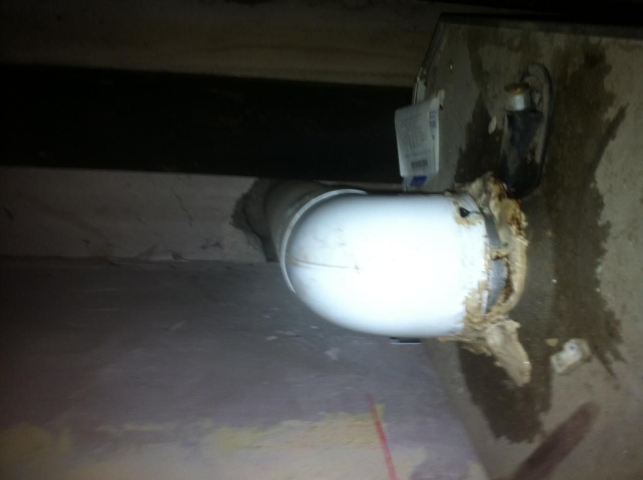

flue liner.jpg hello mr flue liner !!
taken from bedroom cupboard

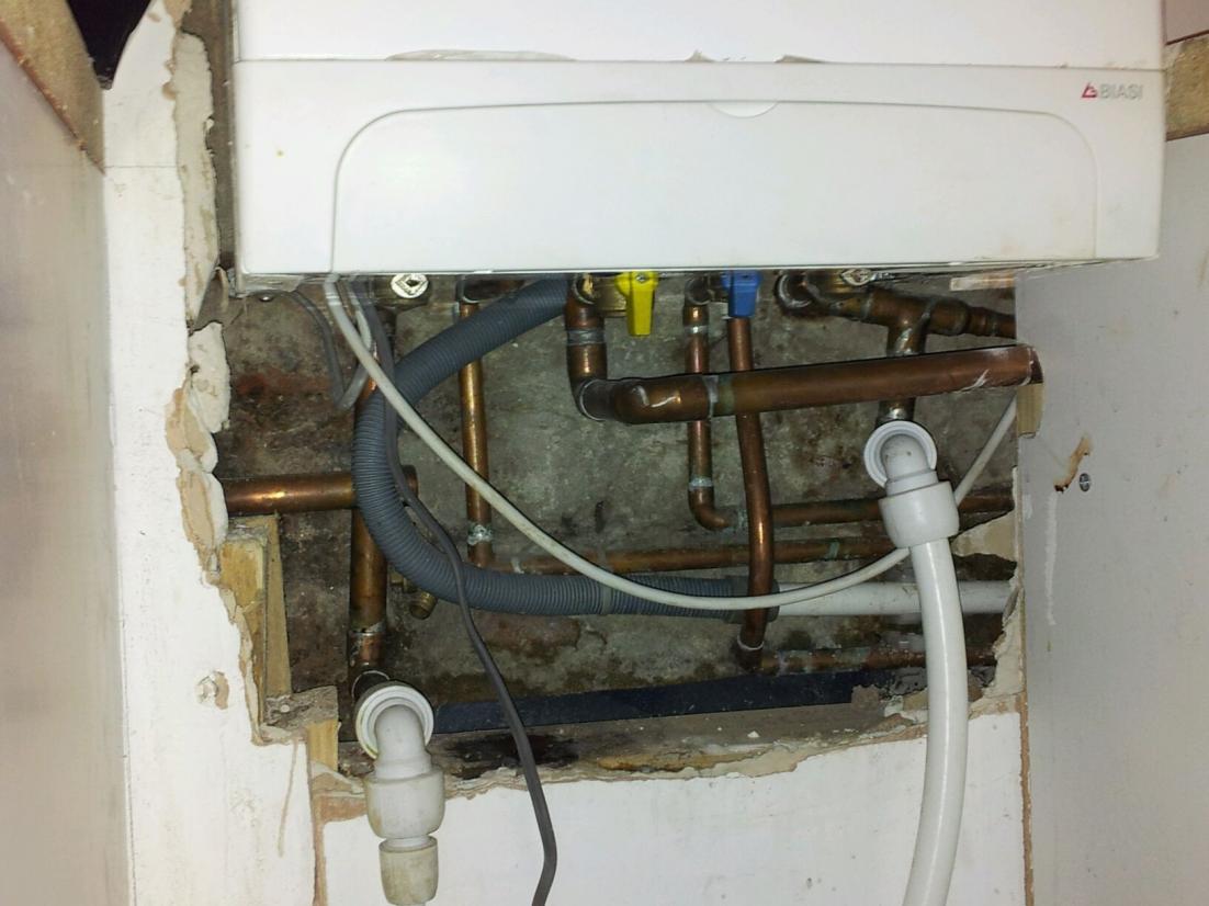

went to a burst pipe today , asked me to look at boiler as they thought it needed a service. found this when i asked woman of house who fitted it she replied brother in law 4 years ago. o right whats he do - "oo hes a proffesional plumber" o right is he gas safe or was he corgi . then i get that look through you look. lol

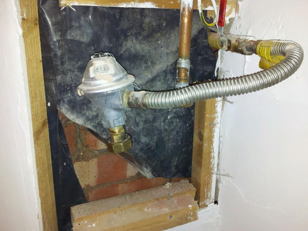

There seems to be a lack of pipes there bod 🙂 As well as the flexi's and 15mm gas, where's the prv pipe?
Speaking of 'where's the prv?' look at this I found the other day on a Worcester Greenstar R25HE. Boiler was about 7 years old. No pipework for the prv could be seen anywhere and someone thought the best thing to stop it dripping is a black iron plug.
I AR'd the boiler and drained some water off as it had gone up to 3 bar.
I take it there was no 2ry (external) PRV on the system? Shocking if not!
found last friday, i think once there was a prv pipe before but no one knows what happened to it? DSC_0115c.JPG

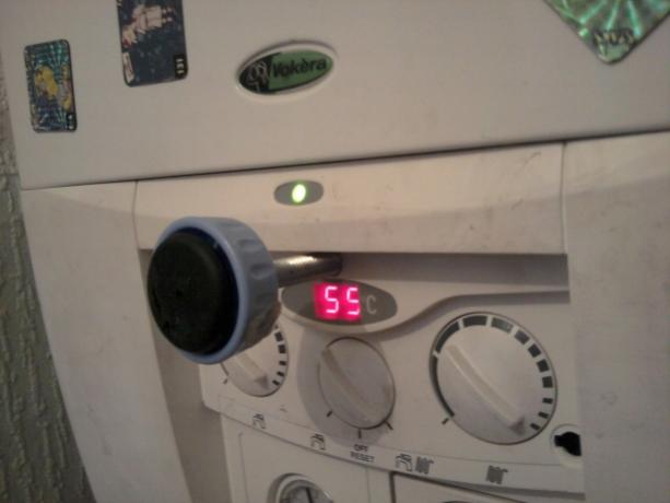

Vokera Linea, what a poor quality thing. Got loads of those on one of the contracts I do some work on, I think I have seen more expansion vessel faults on these than anything. How on earth did the customer discover that shoving a chair leg through the case solved the problem?

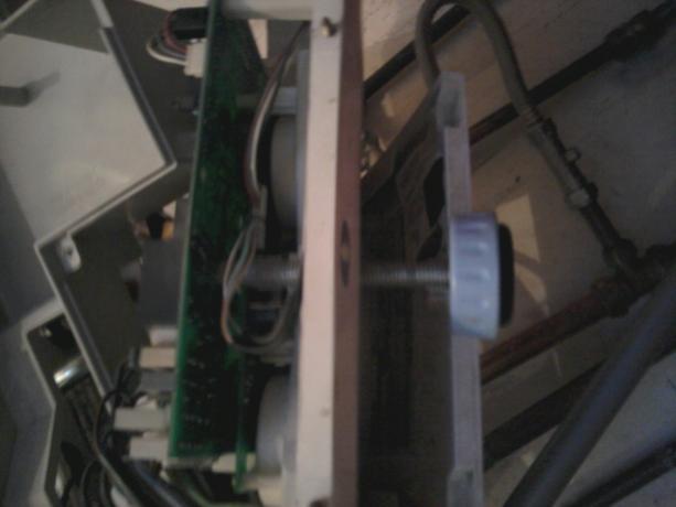

went to this today , got the call last monday. electric keeps tripping when boilers comes on. hmm ok have you had anywork done yes new kitchen sounds more electrical. got call today had new lecki board still hapening i go check pump could smell it soon as i walked in. sparkys had supposed checked all this even quoted for re-wire
that' a close one. I came across a main board like that the other day, sparkies checkd it and the wire wasn't even tightened, the tenant(junkie) came back and without us even mentioning it started blaming someone else as he was in the jail at the time, aye no bother ya junkball

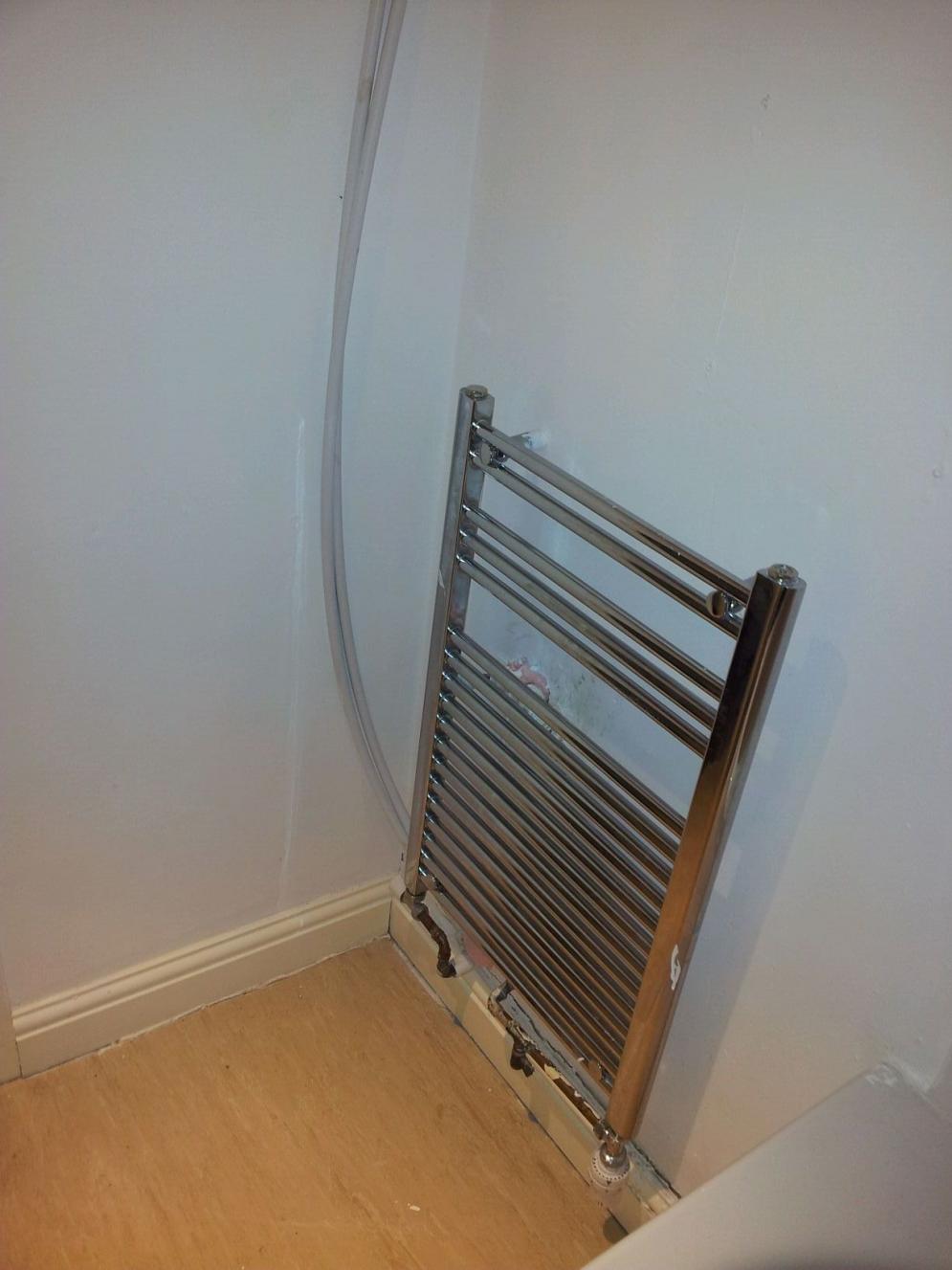

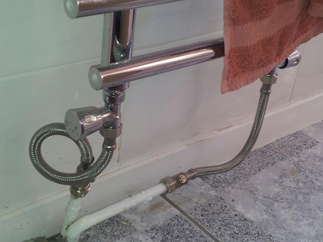

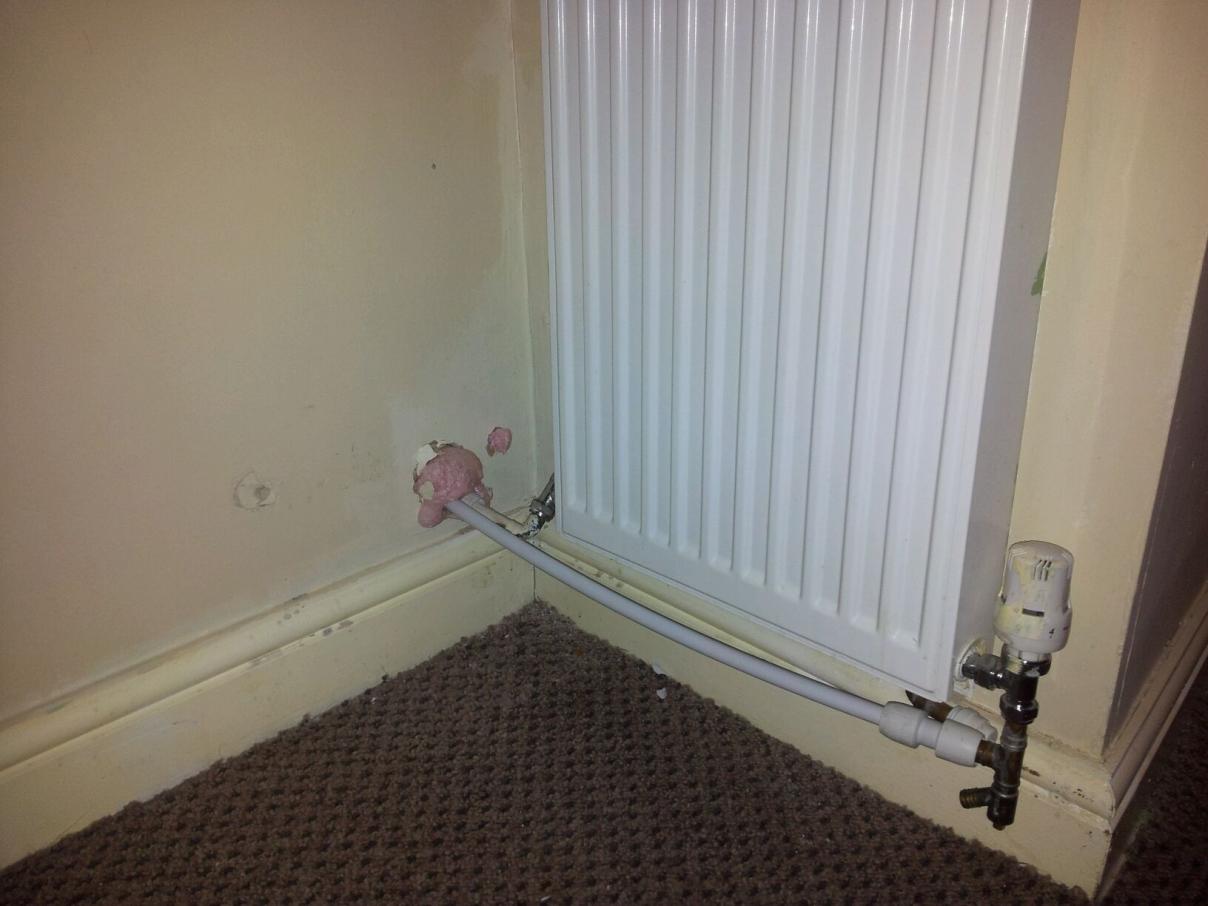

went to the in-laws yesterday. had a quick look at the bathroom job they just had done
nice! he's done a good job tiling the walls tho.........
same property but existing dodgy plumbing from before they moved in....
obviously couldn't decide whether to chase pipes into wall or not so went for half and half...... another quality job lmao,
this was in leeds btw

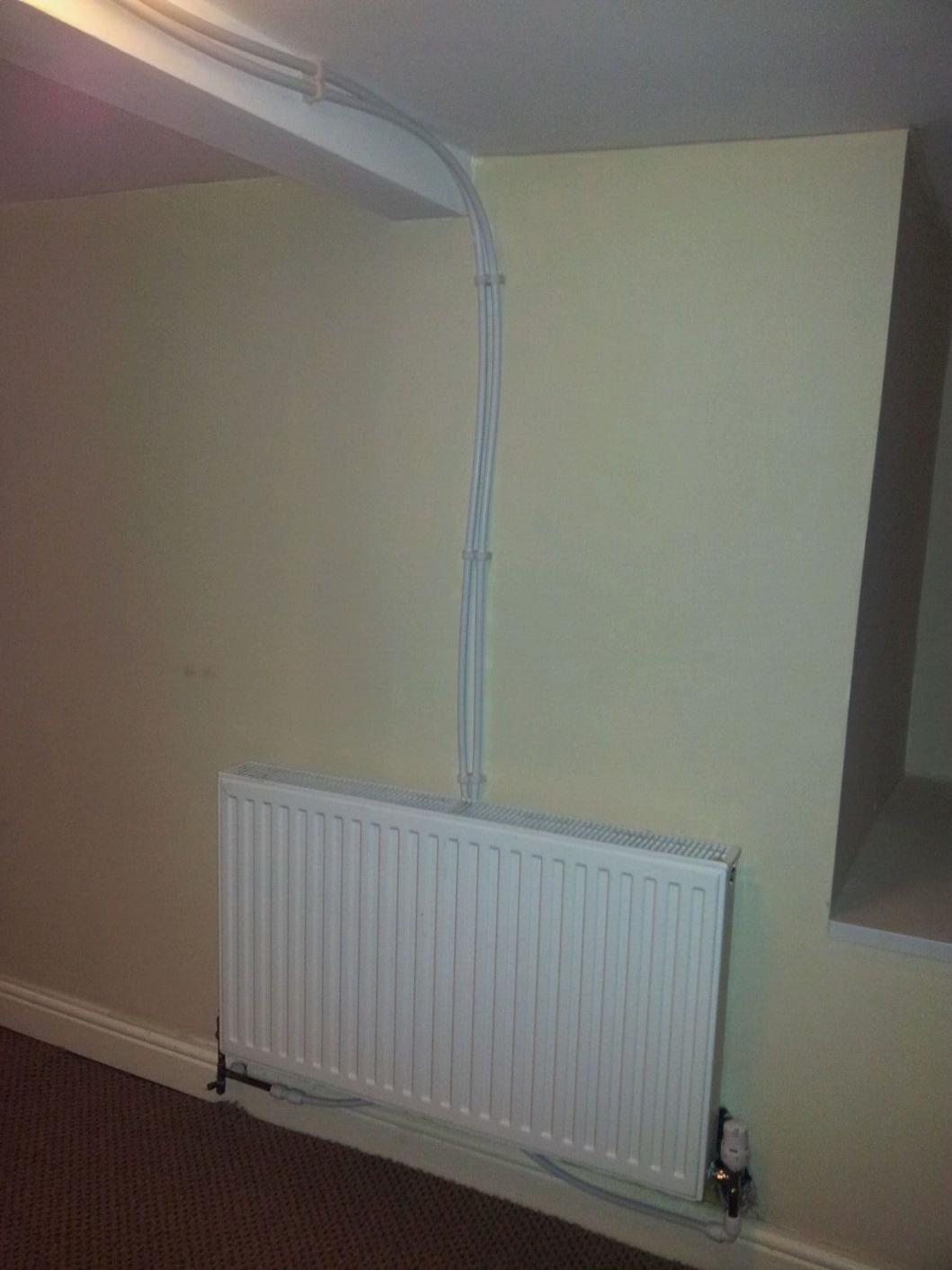

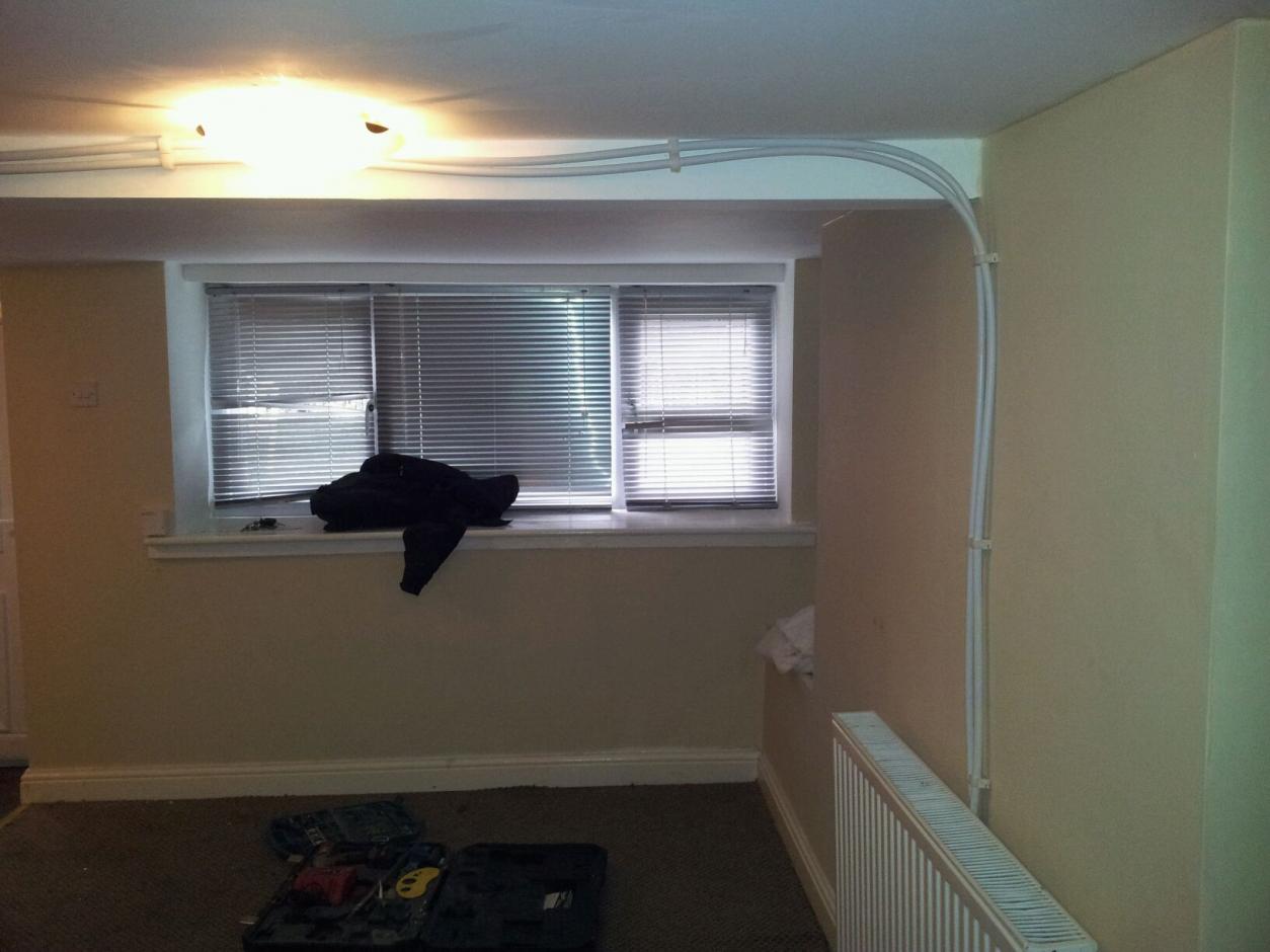

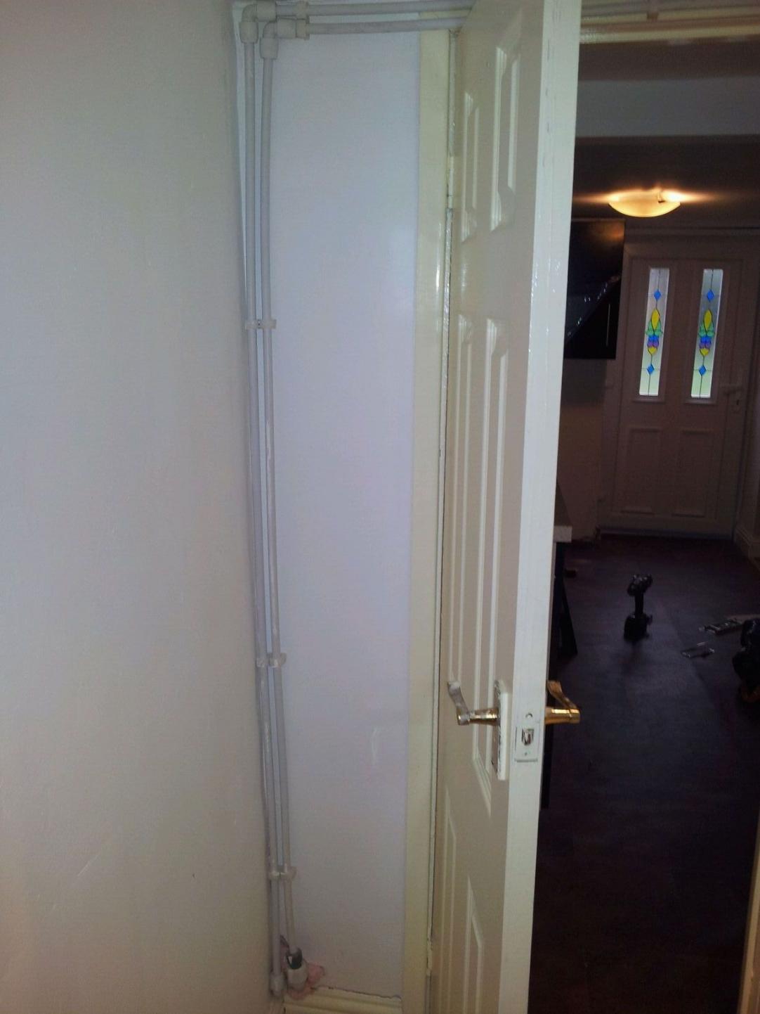

I've just got back from inspecting the plumbing work that's been recently carried out at a rented flat. The tenant has been given notice to quit because she complained about the quality of work. She has also been branded a racist by the owner of the building firm that did the work because his employees are Eastern European. Apparently they are very good workers but they are certainly not plumbers.
Since the work was done the hot water has been excessively hot, I wonder why?

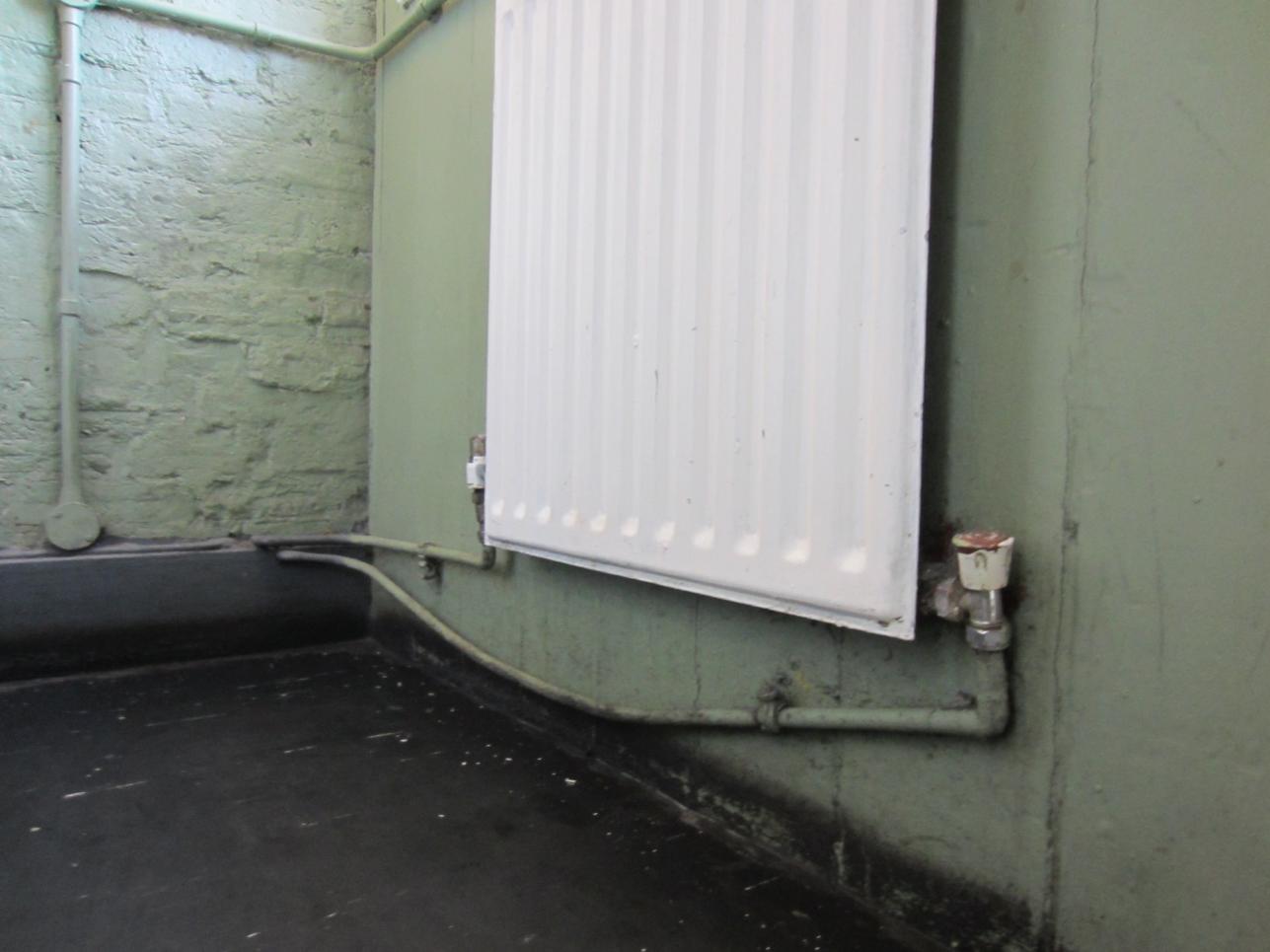

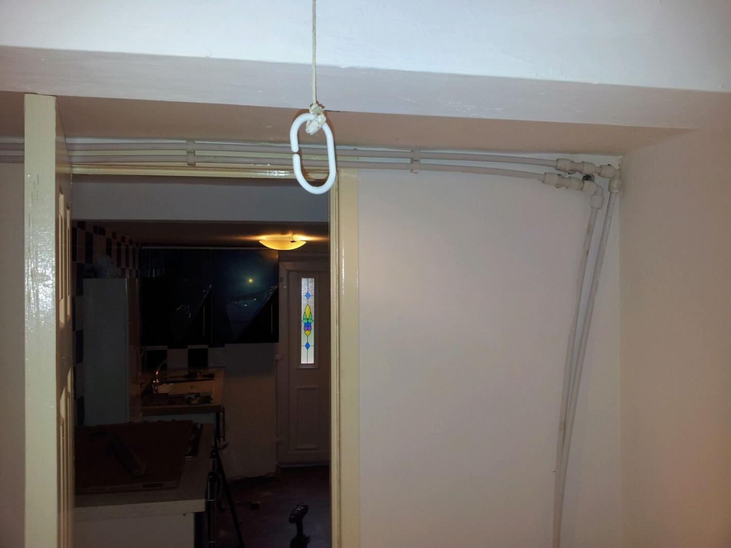

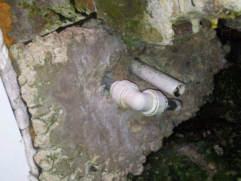

Went out to a new customer today, barn conversion all plumbed up by the previous owner, plastic pipe almost right up to boiler, plastic oil pipe run externally up the wall, plant room in the roof space, heating pump acting as a secondary circ, ufh everywhere but no timers just on danfoss room stats and the best bit the towel rails on the first floor were all piped from the roof down
