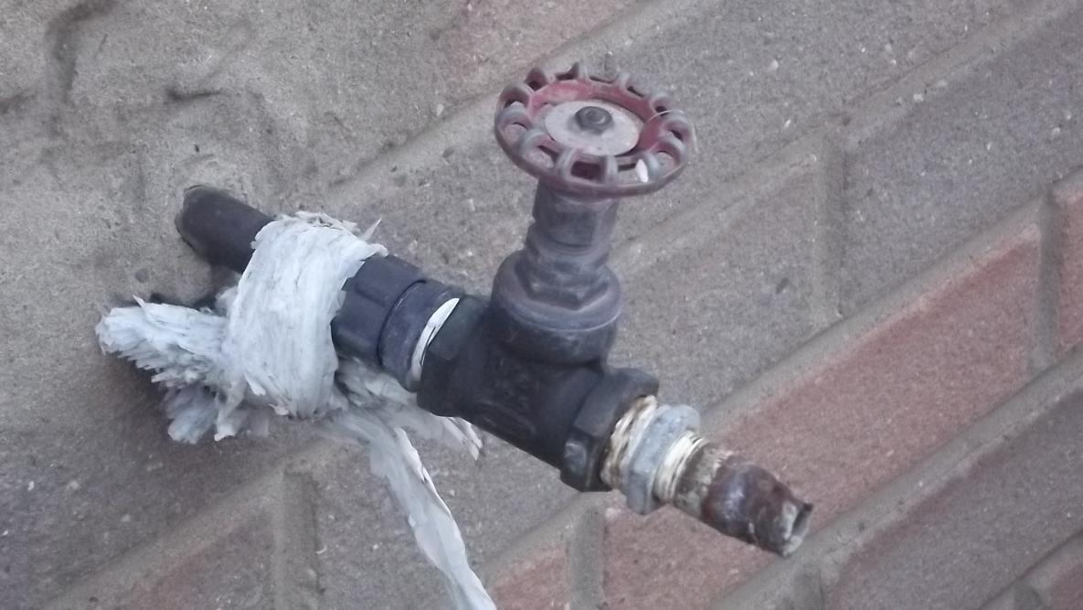

Same heater. Pressure relief connected back to front and fitted to a compression tee with a generous amount of PTFE.

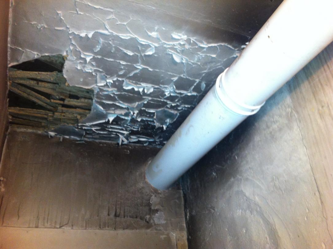

i might have to do this over a few posts as there are several photos as i dont have access to the property the pics are a bit naff this is a house in 15 flats which was converted about 7 years ago i did tell the corgi inspector at the time about it but he just shrugged his shoulders
the meters are obviously under the pavement in the cellars and i cant see how many bends are involved and the services go to both side of the building and i could only photo one side i counted 15 bends visible on one service which is probablyclose to 45IMAG0051.jpgm long no sleves on any where they exit the slabIMAG0055.jpg and no flues made good above 1st floor
is that 22mm gas pipe? doesnt an elbow add 0.5 mtrs of resistance to a gas run as in its like adding another half meter of pipe work to a run.
And on such a large run shouldnt that be in 28 or even bigger in LCS? then down into 28 -22 - 15mm to boiler??
I know im not GSR but im trying to get my GSR ticket, so i may not be right but surely im not far off the mark?
Thats shocking though!

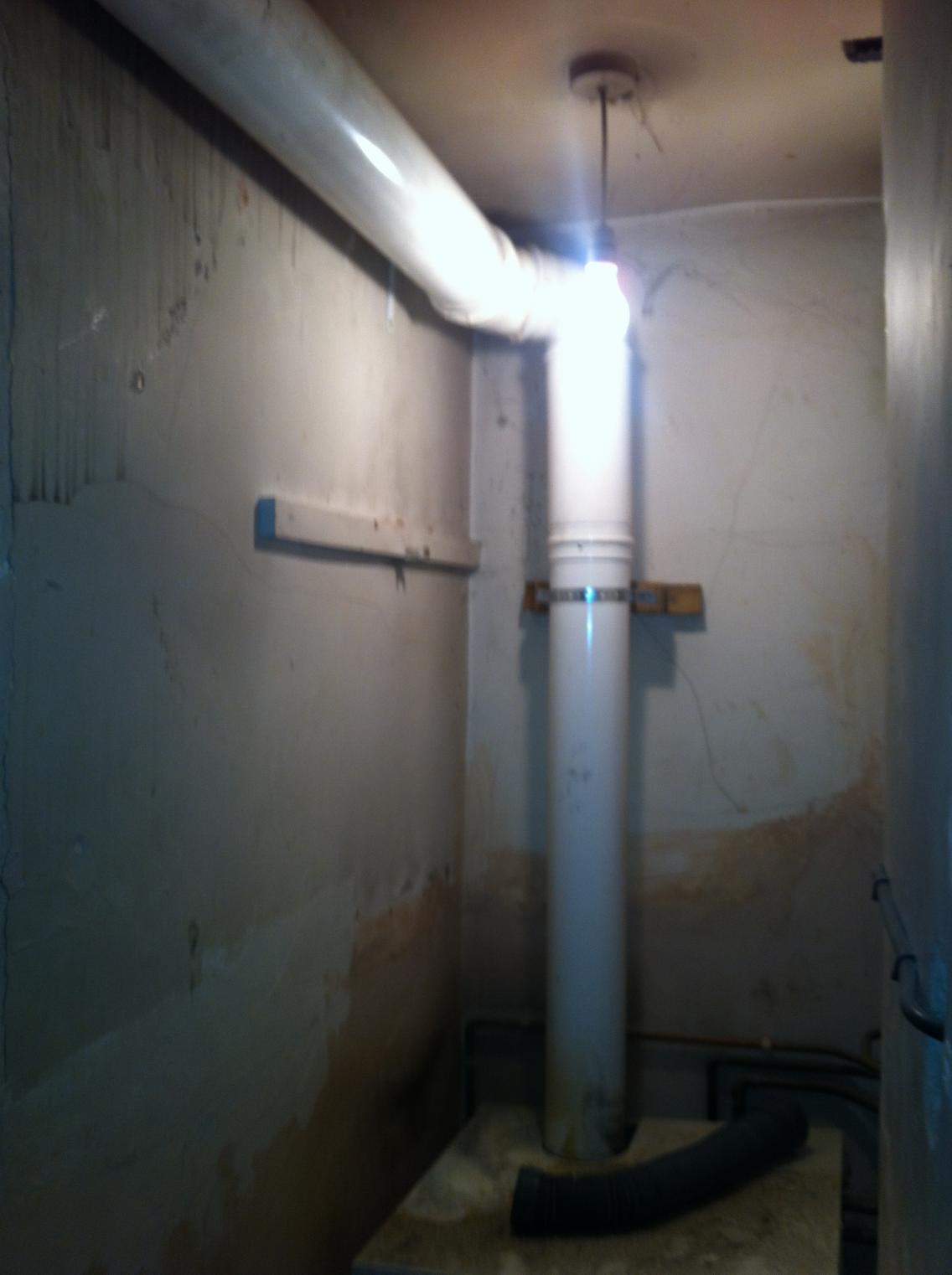

the meters are obviously under the pavement in the cellars and i cant see how many bends are involved and the services go to both side of the building and i could only photo one side i counted 15 bends visible on one service which is probablyclose to 45View attachment 13829m long no sleves on any where they exit the slabView attachment 13830 and no flues made good above 1st floor
neat pipework even though they did the devils work and used 135 degree end feed elbows........:reddevil:..
