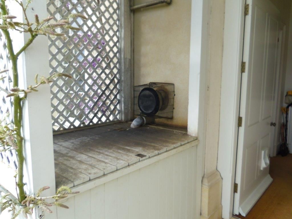

This property has just had a cp13!
Went to job as one of the lads wasn't happy working on system and thought estimator had dropped one.....
Yeh yeh it's an easy combi swap.
What's that hot connected to prv instead of prv? No hot on boiler? But it's just been gas rated and bp? And a fga???? The rads don't work and boiler overheats???
Oh
Yes fire secure and closer plate sealed

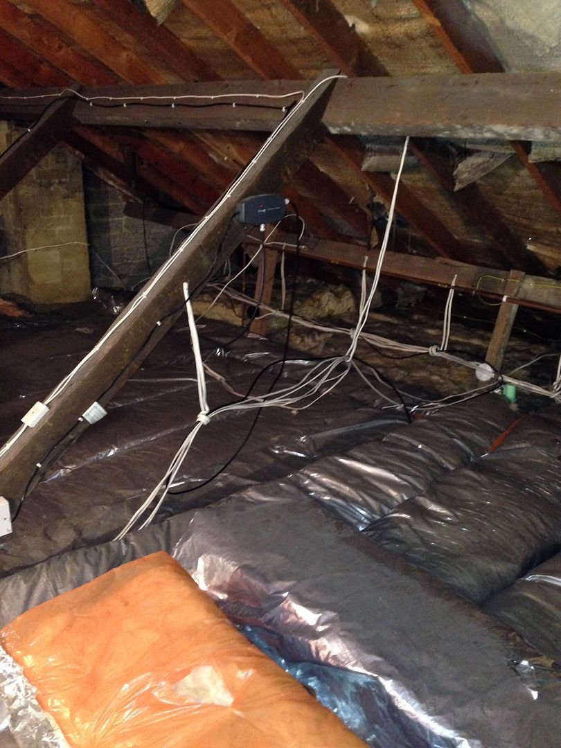

Forgot I took this with my phone a few weeks back. This is a British Gas install. The PRV goes UP into the loft then siliconed into the stack, with the condensate pump outlet nearby doing the same.
No pipes insulated, nail in pipe clips, shoddy work all round.
Shocking, See how BG have moved forward in improving their business. This is a total embarrassment.

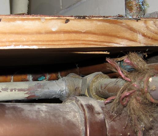

After servicing the boiler, I was asked if I would repair the leaks on the soldered and compression joints on the cylinder. i suggested that i would but would also want to take it out and start again. How many fails can you see....
