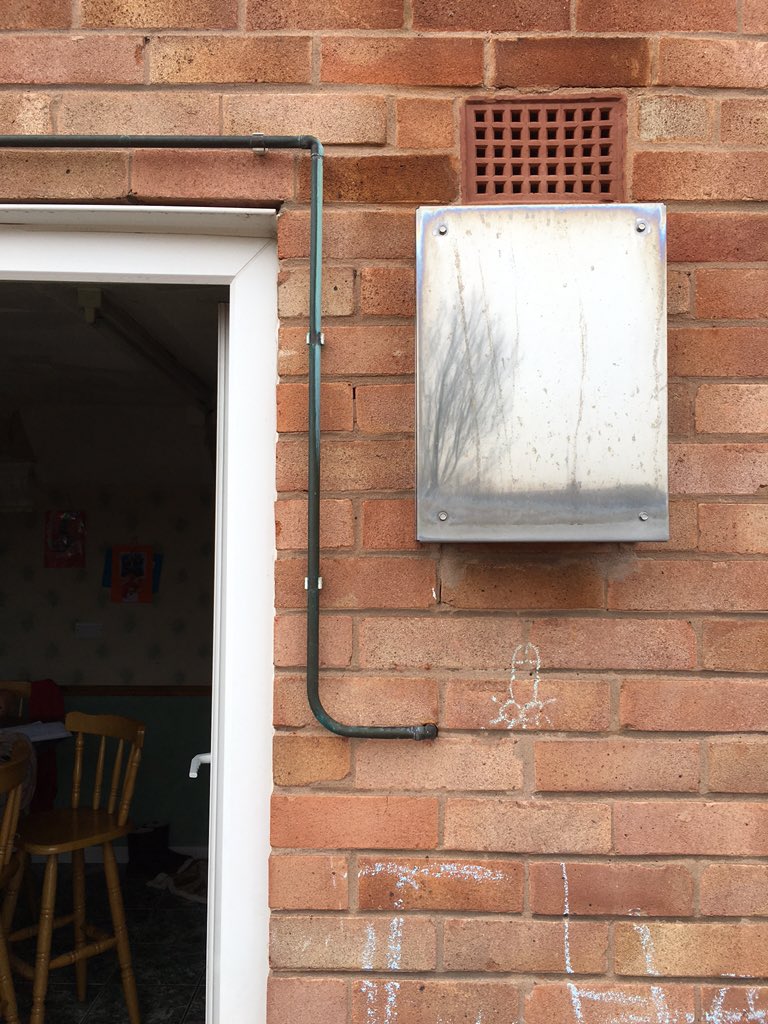

Condensate pipe, high level discharge, no soak away or lime chippings, but at least it terminates 500mm from the building.
