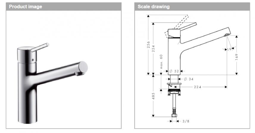

I got a Kitchen tap - Hansgrohe Talis S 32851000. When I started removing old tap I have noticed, that it has unusual fittings. I got it off ebay, so I thought it might be a product for a different market than UK. When contacted seller I was told that it was purchased in uk from some company and had some spare ones. Anyway, can anyone advice if there is any chance to have it fitted with standard UK connectors?
For some reason I am not allowed to post link or photograph, hopefully it will let me do it with next post.
Edit.
After some research it seems that my set is missing some screws that goes on top of the hoses. Will try to get them from the seller, but he claims he doesnt have them.
If I only had a chance to post a photo of what I've got.
Thanks in advance for any help.

Your taps are complete. They don't come with adapters to 15mm copper.
you will need two of these.
Reducing Coupler Compression Fitting 15-10mm | Compression Coupling | NoLinkingToThis
