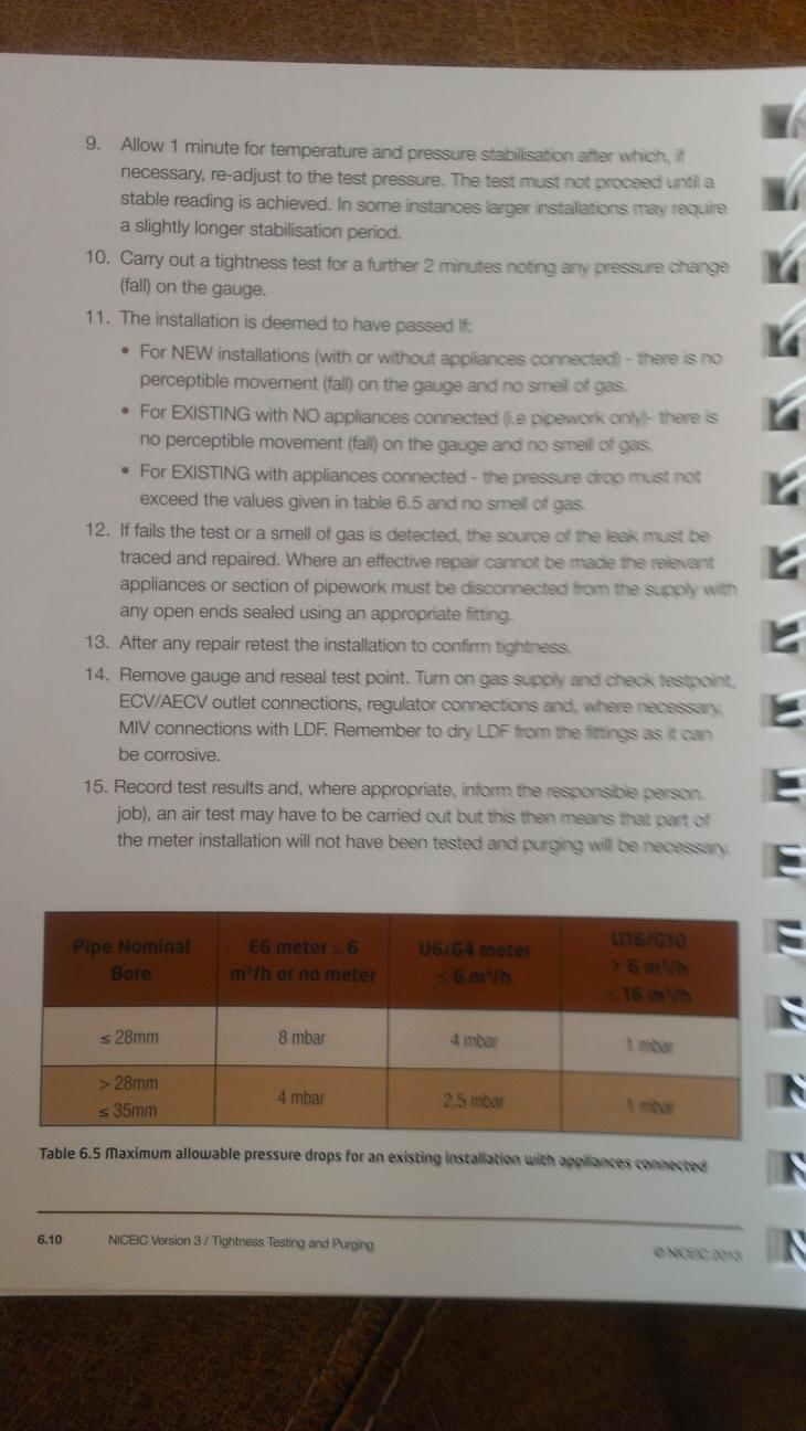

this is I think the latest book, got from Steve Willis for my gas course, permissible drop on existing is permissible, nothing about weather its on the carcass or not
that's why it lists with or without appliances connected 🙂
without = no appliances or isolated appliances
apprentice or doing your initial assessments?
Without means without, you are surmising it's the same as isolated, nowhere in the IGE document does it say you must isolate the appliances, it says that if an existing system with existing appliances has a drop no more than the specific allowable drop in the table it is a pass, so that means if you have a drop on an existing system it can be left without identifying where it is
