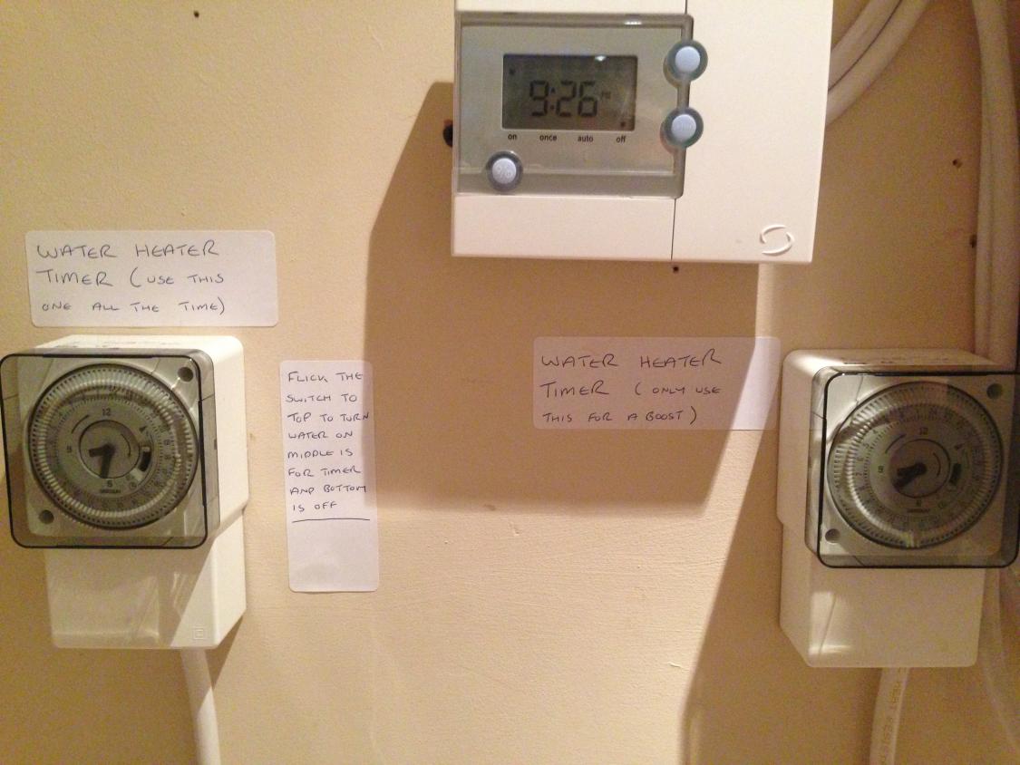

Another thing I found is the bath will be hot when running for 5 mins then it goes cold. When I bought the house the last person left stickers on what seems like the on / off switch / timers, One of these says leave ON which is the top thermostat and the bottom says use for a boost only.
Is there anything I can try ? If there is it would be highly appreciated if you can help me but please note I'm no expert so may need some dummy talk, I have attached a picture so you have a better view of what I got. I hope I explained things well.

to use your immersions the lower one should be for offpeak elec overnight so leave it on all the time and it will heat up overnight, the top one is to boost up your water during the day when you have run out or know your about to have a bath, do not leave it on constantly. get a qualified person to check it all out to see it is set up correctly, yours may not be!

Its my first house and I never dealt with this or timers and such, I have attached a picture on what the last person left, Not long moved in but this is how it is, I not touched anything.
Any suggestions ?

Now you got me worried ! Ha, so some say the times must be not be constantly on, Is this right ?
Any suggestions and without sounding thick how do you set them ! lol
