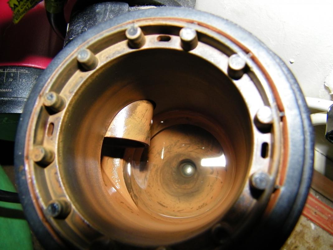

hi,
i used to get clear / grey coloured water but now i get brown ?
this started happening about a month ago after i removed the rads and poured boiling water and flushed through them to clean them.
the reason i decided to clean rads out was because i have experienced some pumping over last year.
i didn't put inhibitor in the system because i knew i was going to do some other work ,
is the brown water due to new rust ? but i was surprised just after a few weeks this happens ?
i also have air problems and have to bleed off about a cup full of air every few weeks - i can hear air being pushed around the water circuit.
last year i ran some F3 through the system but it didn't seem to do much.
here's a photo of the inside of the magnet filter which is located just after the 3 port valve - the probe part did have 5mm of mayonnaise type sludge on but i cleaned it before taking photo,
the magnet filter used to collect black particles that i used to be able to flush away but with the brown sludge on the particles must be sticking to it.
i was wondering if i should run some cleaner through again and if so which type or just mains water ( i have cleaned the f and e tank which had some brown residue/dust in it and also the magnet filter is clean again.)

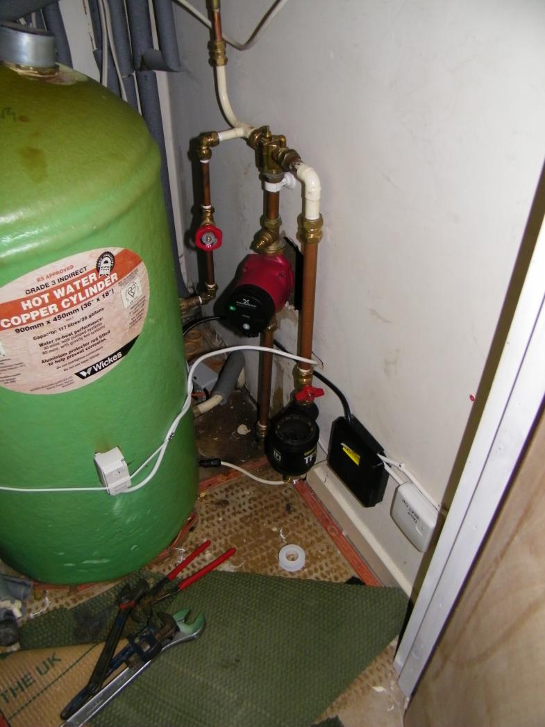

i have just fitted a new rad and some work around the pump in the airing cupboard and wondering should i run cleaner through it or just water and add inhibitor,
i need to try and cure the air problem and was maybe thinking to add some leak sealer at some stage.
any advice welcome,
