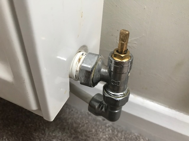

Hello, a second query, this one about a normal radiator. All my other radiators have a thermostatic control at one end and a valve at the other which you just turn all the way to the left for on and all the way to the right for off. I understand these! I have one in the loft which has been cold for ages. I want to check it is actually on. The pin is up under the thermostatic valve so that end is ok. The other end has a cap, and under the cap it looks like the photo attached. Am I meant to turn that with pliers to make sure it is on??
Yes.
Lockshields can come with either a decorative cap (like this one) or a valve handle (like your others). The actual brass bit is the same and just needs turning to operate, either by the handle provided or pliers/adjustables etc.

If this radiator used to work and you've never messed around with the lockshield valve, it won't be closed. If its only partially open and opening it up fully allows this rad to warm up, then you're going to need to balance your system properly, there's a good guide pinned to the top of the central heating forum if this does not doing.
