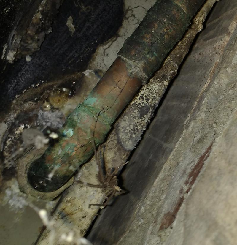

Hi, just signed up to this forum hoping I can get some help with a bit of DIY. The hot tap on the kitchen sink no longer turns on and I've been looking at these tap reviver kits that look much easier than replacing the entire tap. Anyway my problem is I cannot for the life in me undo the thing, I've sprayed it with WD40 and left it over night and it still won't budge without trying to turn the whole tap. I was using a big adjustable and some mole grips to try and stop the tap from turning.
If I can't do the tap revival method I guess I'll have to replace the tap but getting underneath this sink is really tight but I got a pic on my phone of the underside (plz excuse the spider and what looks like some sort of slime (!?)).
Now I've fitted taps before in the bathroom using flexi hoses but this is a bit different with it being copper pipe all the way which I don't know how to do (my Grandad fitted these taps in the late 80's/early 90's) but there doesn't seem to be a plastic nut for tightening the tap to the sink?
Can anyone give me some advice on what is the best course of action for someone with limited plumbing knowledge!
Hey, I'm not certain reviver kits aren't made for that type of tap, I just don't think so.
My worry would be that the pipework is probably 1/2" or 3/4" (not 15 or 22mm), so using the existing pipework without modifying it is probably the best best, assuming the tap tails (i.e. thread) is the same length.
I would agree that the new seal will almost certainly be a red fibre tap connector washer, (it may previously have been done with hemp and boss white - no longer permitted for this).
