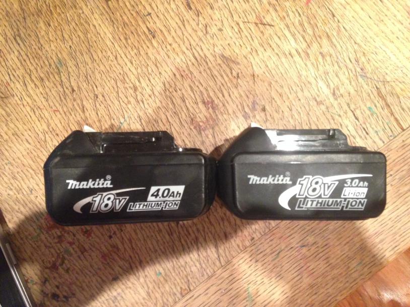

Mentioned this in another post, but thought I would say it here. :- Don't leave your cordless batteries lying loose in your van, as it will set fire to any steel wool it touches!
re: Hints, tips & secrets of plumbing - No Banter please!
Oh and it will be the electrical current that does the damage to the wire wool. 🙂
Yep! Steel wool touches the battery contacts & the wool turns into an electric fire element! Hard to put fire out! I am careful, yet didn't occur to me, this could happen.
