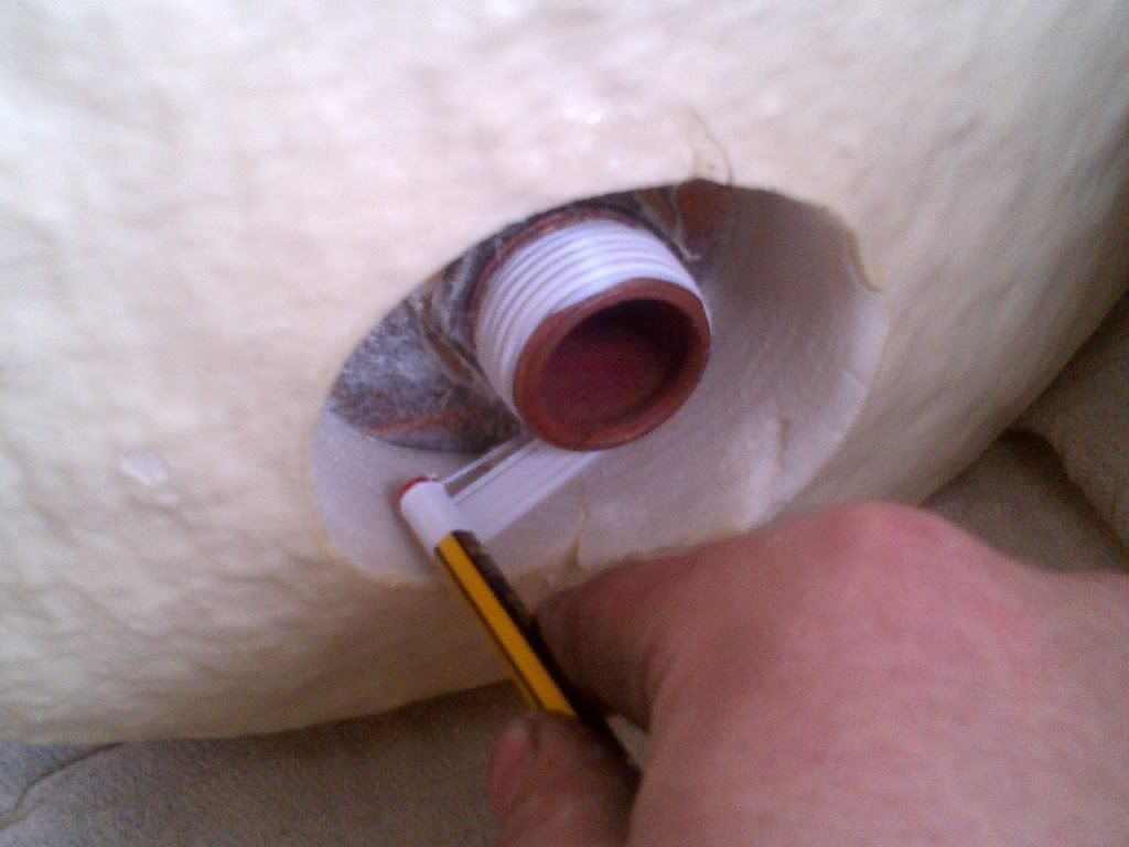

I posted this tip before, but I'll do it again with a pic. Struggling to get PTFE on lagged cylinder unions? Wrap PTFE around a pencil, then use the pencil to apply the PTFE to the threads..............

This is a great tip! Although I'm not sure why you'd need ptfe on cylinder unions.
