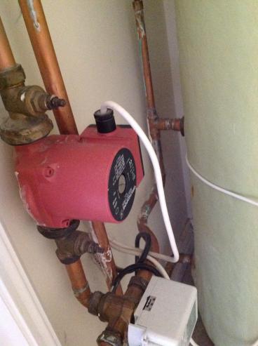

Can you post a picture of the airing cupboard..?

Here are the pictures hope they show what you were looking for.

At the moment I can only think that it is piped incorrectly.
I suggest you get a Heating Engineer to come and take a look over it.
It would be worth paying for a couple of hours time to solve this in my opinion.
