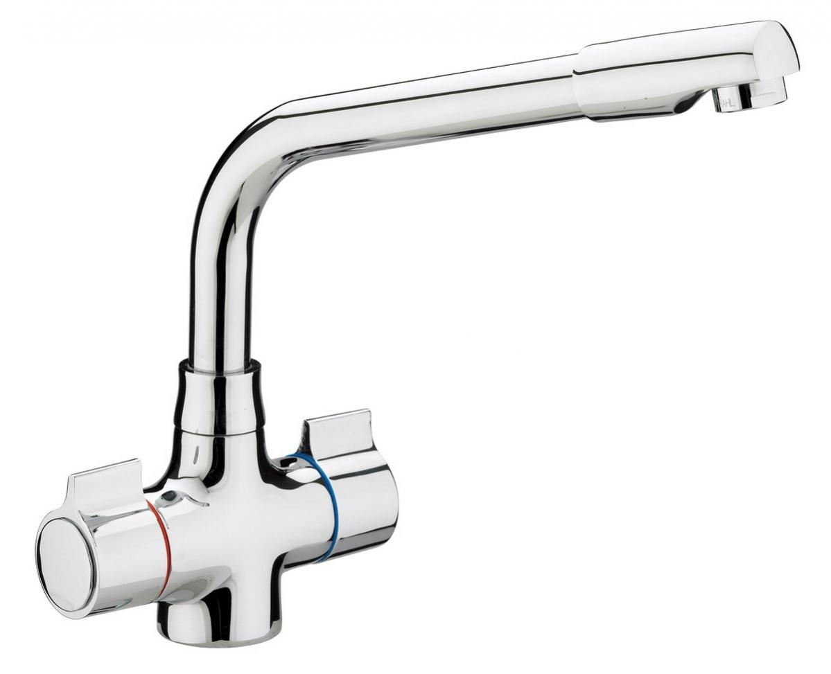

Went to a kitchen mixer this week, leaking from the neck (where it inserts in to the tap body) It only leaks when the taps are used. It's the type where there is a 'cap' that tightens to the tap body.
I am certain this would be down to an o ring, there was also a bit of movement on the neck probably due to wear and tear.
Customer thinks it's a dodgy tap valve/washer on the valve.
The only time i have seen this a new o ring has been the solution but sometimes there has been too much wear and tear for this to fix it.
Customer got shirty and asked me to leave and said he would get a proper plumber. I didn't get a chance to attempt the repair and he has asked for a second opinion from another engineer.
What would you say the fault is?
Not these exact taps but you get the jist.
Very common problem caused by poor design. There is too much leverage on the spouts, which wears the o ring or the tap body.
I gave tw boxes of various o rings and as yet have never found one that fits a y tap spout. If the o ring is not split, sometimes packing with grease will sort it shot term , but it will leak again.

I'd vote for your diagnosis to be correct, that's what id go with anyway
Just ignore the customer, sounds like the type that knows it all and could do the job...
Yeah there's normally 2 o rings... If I go to a kitchen tap that keeps working loose I lube the o rings as the leverage loosens the tap body!
I too have a big box of o rings but they never fit 🙁 some ptfe round the o ring & or silicone grease might improve it for awhile :/
Should have unscrewed it as it's a quick enough job!

Split or worn o rings at the base of the neck. I carry a box with assorted o rings to fix this sort of thing. New o ring, smear of silicone grease and as good as new.

Easy fix mate. They have a white plastic o ring under the screw down cap - wrap some ptfe around it, bit of grease and job done!

I would have just taken the neck out and had a look at it straight away.
Do be careful with some of those necks on mixer taps that are held in place with a nut. I find they are usually a light neck and will jam in the body and can snap if you twist them. The bottom O ring gets jammed in the gap in the body above it, therefore the neck can only move up a fraction.
If O ring is nowhere near size you have in van, but still reasonable condition, then a turn or two of ptfe into groove & put O ring on again, or smaller new one & silicone grease it. Do not use too heavy a O ring as they swell later & neck won't turn.
trouble is usually the o-rings you get in boxes of o-rings are too thick i find. must be somewhere that does an assortment of thinner ones.
I find the O rings in the kits are mostly too thick and that's imperial or metric boxes. But still worth having them for the odd job they fit
could it be tap manufacturers deliberately use unusually thin ones so that you have to pay £5 + P+P for a service kit consisting of a couple of o-rings, a plastic clip and a satchet of grease?
