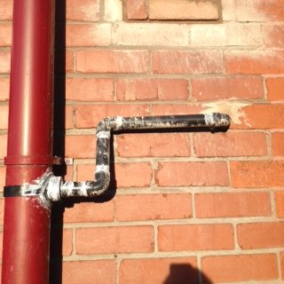

We recently had a new boiler fitted, the boiler and radiators are working well, but the finish is awful.
The Condensate Drainage Pipe runs externally to the soil pipe, not ideal, but were having a conservatory fitted over it.
This pipe is now leaking from the joint where it meets the soil pipe and also the elbow and other joints. The plumber is avoiding our messages and to be honest I would rather ask someone else to do the job.
I have attached a picture of the pipe, I'm no expert but should it not be one pipe at an angle?
Please could you offer advice on what I should be asking a plumber for, I need this pipe to be water tight, as its going to be boxed in in the conservatory which is supposed to be getting done in the first weeks of January.
Thank You in advance (sorry I couldnt rotate it!)

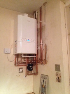

Thankfully the boiler and radiators are working, but the finish is shocking. That's only the start of it! Some of it is laughable, but gutted at the same time.

It's mainly dodgy brickwork, but still, for £2,800 you expect a certain level of standards.

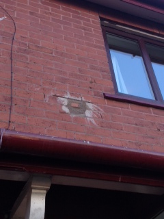

He did come back to fill in the of the holes and straighten up our towel rail. He said he couldn't make the radiator in the bedroom central to the window because of the pipes, beams and electric under the floor? We also have a radiator that moves side to side!
I'd rather a proper 'bricky' do the front of the house, so going to ask the guys who are fitting the conservatory if they can so something?

Why not just go diagonal with condensate. Would have thought it's more prone to freezing being zigz without insulation.
install of boiler looks good.
Install of the boiler doesn't look too bad. Just a shame he couldn't finish off the making good neatly. What did you get for your £2800? You say boiler install and some rads, was it a whole new heating system?

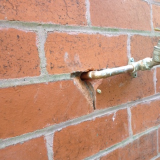

Only one screw holding the tap on, and I bet there's no double check valve on it either...

We're getting a conservatory built in a few weeks, so I'm hoping the builders might sort the brickwork at the front.
Kay Jay, what do you mean by sleeved? That tap was originally at head height! We complained that its a bit dangerous as its right on the corner, he 'dropped it down'. I was imagining he would somehow drop it down inside and pass it through a a reasonable height!

I've just realised that the outside tap picture is the old one. I complained about it being at head height, and the shoddy brick work.
He has since filled the brick with cement and extended the pipe outside so the tap is at knee height, but there is now a big long exposed pipe outside to the tap.
He has ignored us since this!
When I say sleeved I mean the copper pipe should be run through the wall in a sleeve made from plastic overflow pipe. This is a regulation and prevents chemicals in mortar and plaster from reacting with the copper pipe which over time causes pinhole leaks
Aaaah, thanks. Another thing to add to the list!! Would you recommend this is done soon?

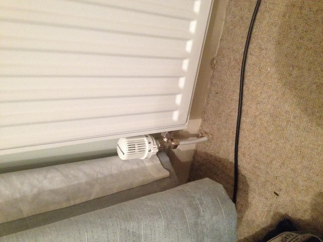

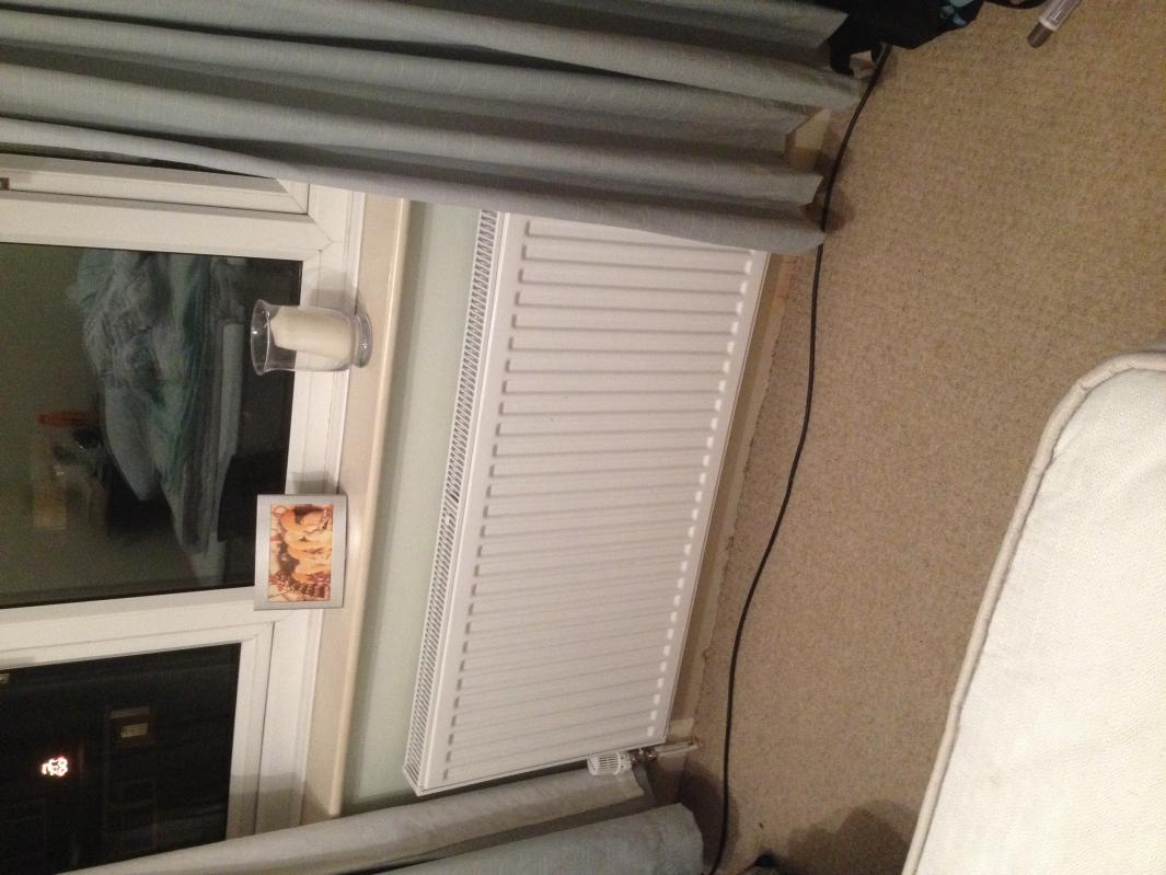

if the rad is moving side to side on the brackets i doubt he has fitted the plastic inserts to the brackets sometimes a blob of silicon will cure it
Hard to say without seeing it in the flesh so to speak but I would imagine a couple of hundred quid

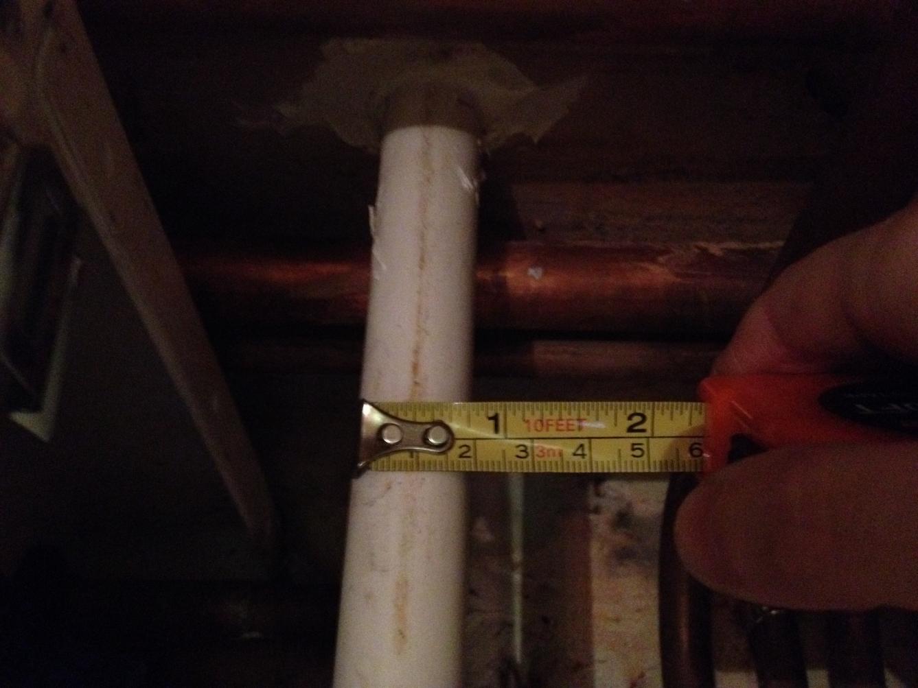

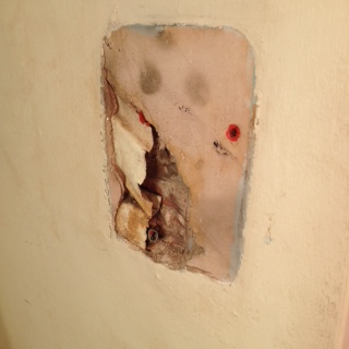

Photos of radiator as requested. Also slightly concerned because the installation manual states that the external condensate pipe must be a minimum of 30mm before it passes through the sleeved wall.
My pipe seems smaller. The list is never ending :whatchutalkingabout

As mentioned yours is 30mm by looks of it. Out of interest read a few lines down as the current Logics state external condensate pipework should also be insulated with weather proof insulation (type o) as a further precaution against freezing.
I have came across a few 30mm condensates freezing solid over the years.

Looks like a plumber who forgot to bring solvent weld glue.
I think it's more to do with movement and abrasion mate
Well the plumber got back, he feels the condensate pipe is perfectly suitable, as he has installed 100's like that. They do have leaks where the glue needs resealing or the glue hasn't set.
He is coming to glue the pipe as needed. However I would feel more confident with one diagonal pipe. What would you recommend I ask for? Just a glue or a new pipe?
