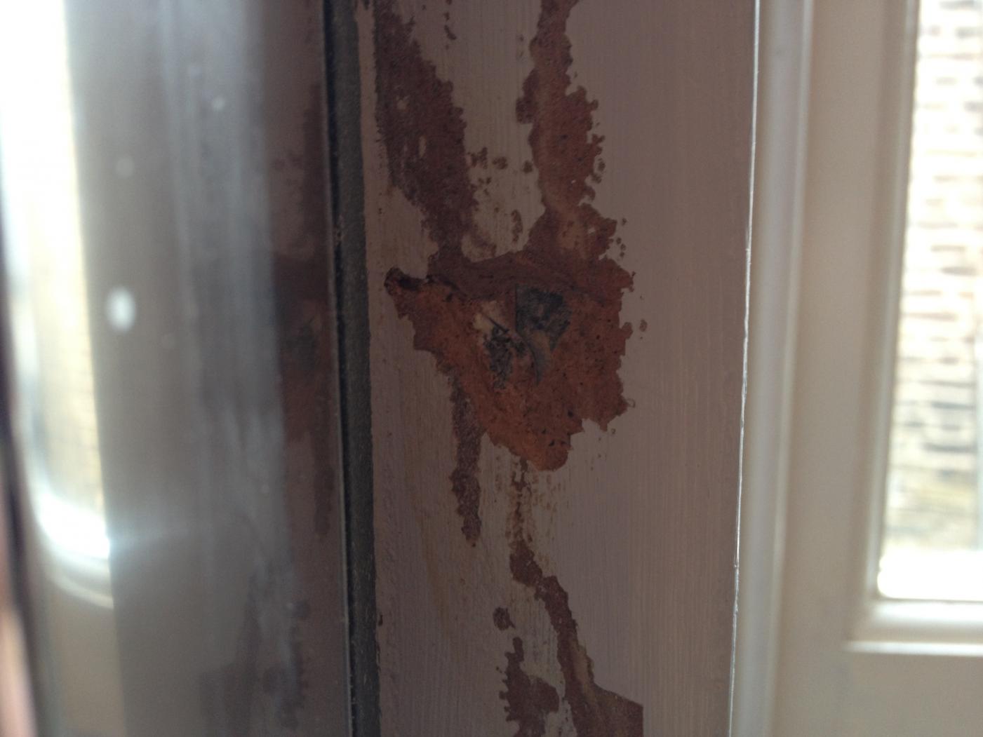

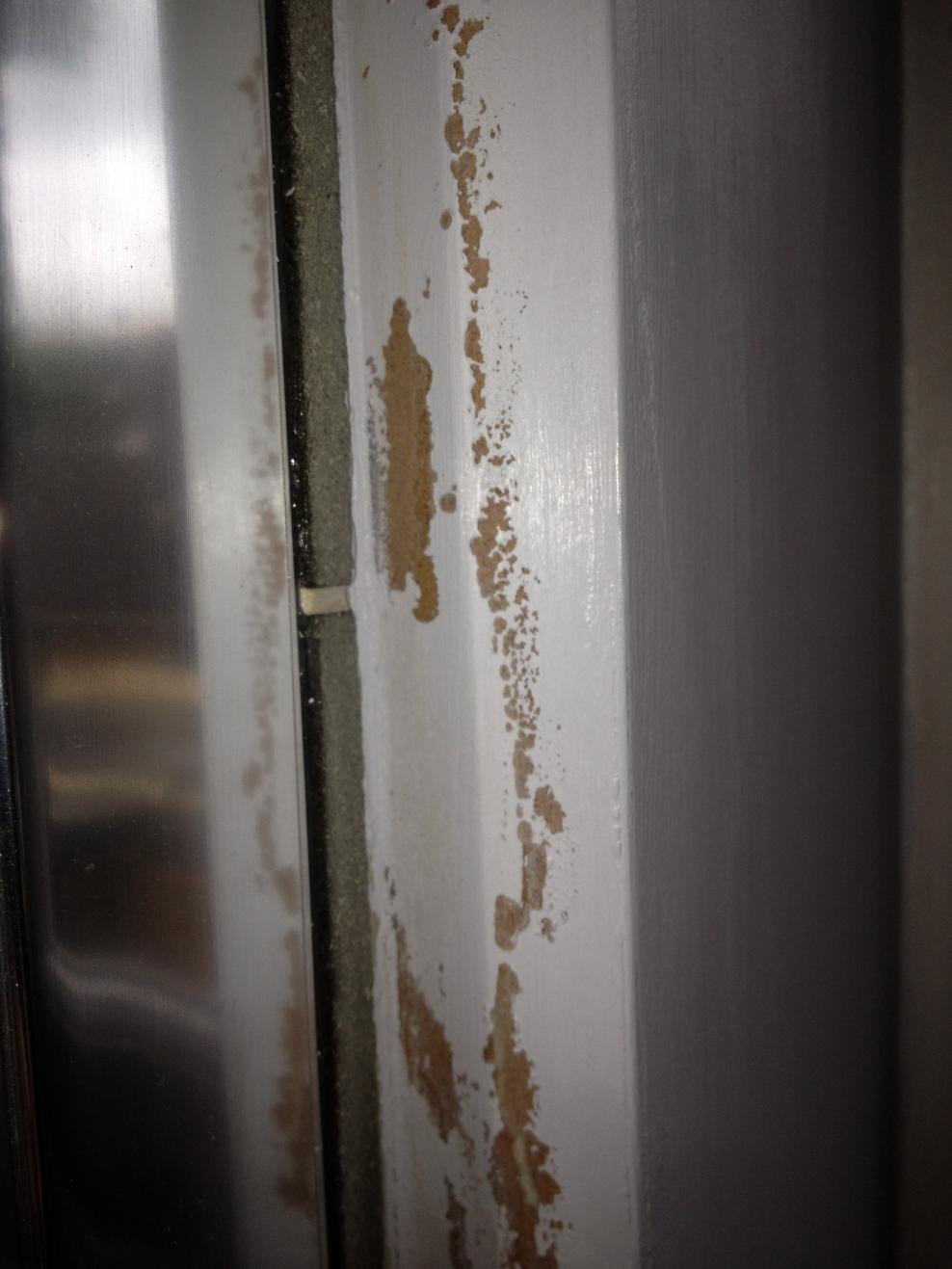

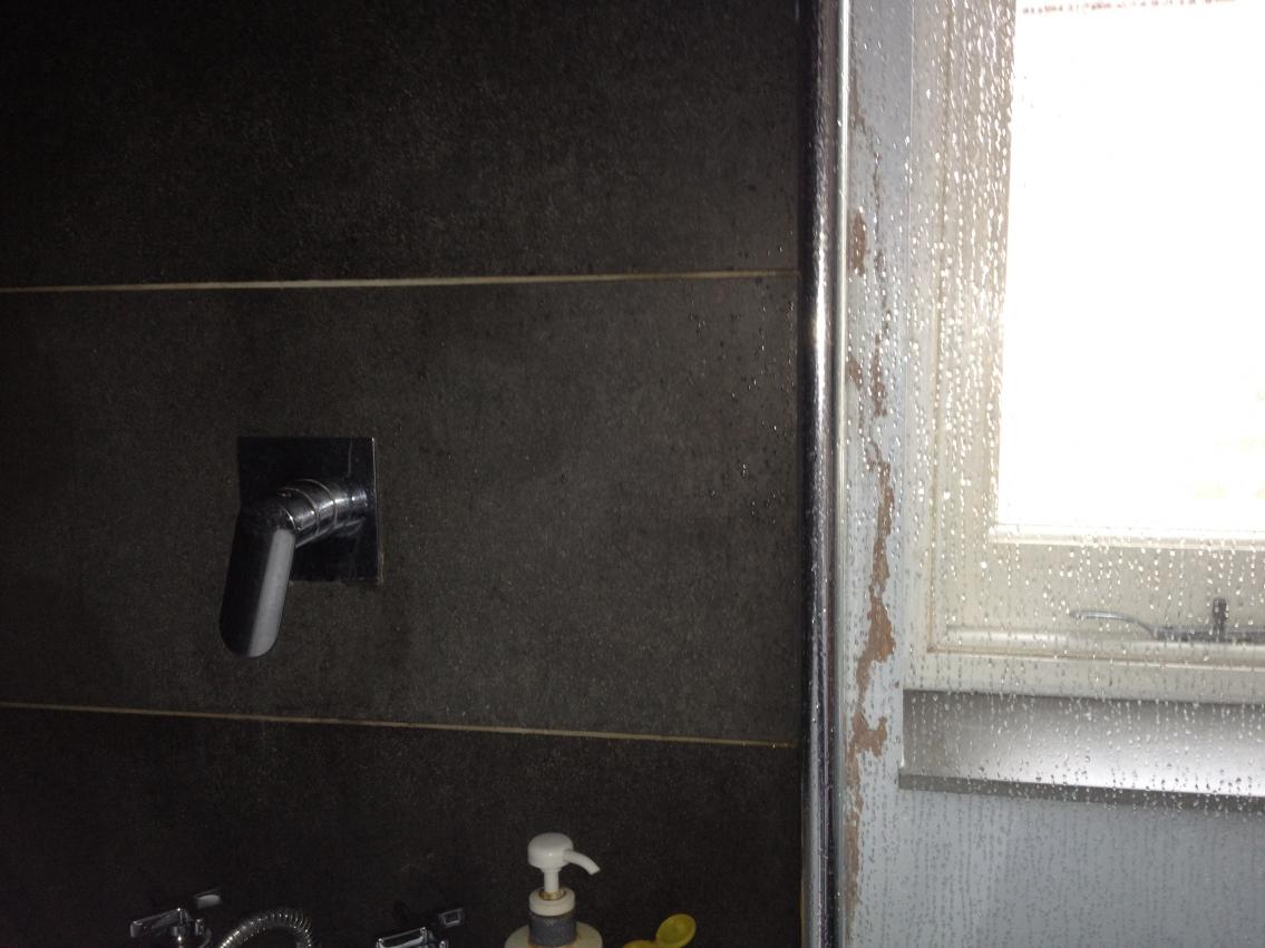

Recently the paint on the wall in between the shower screen (which is attached on top of the tiles) and the window opening started bubbling and blistering. (See pictures) It started fairly close to the tiles and seems to be spreading outwards. At first I thought it was condensation and planned to install a fan but now I’m worried that it might be due to a leak in the shower pipe behind the tiles as it is developing quite quickly.
There isn’t any damage to the ceiling below the bathroom (no stains, sagging or dampness)and I can’t hear any dripping in the space behind the shower. However, I’ve read that leaks can occur in pipes where the cold and hot water mixes – and the shower handle seems to be in the ‘centre’ of the damage.
Obviously I don’t know what’s behind the tiles but would any water damage spread horizontally without impacting upon the ceiling below? Could it just be that it is the condensation?

Could it not be the shower screen leaking when water is hitting it whilst showering?
Give it a good spray up and down the joint where the screen meets the tiles and see if any water passes there, also check the grouting on that wall to make sure I'd complete and no gaps.
After that I'd be tempted to take the bath panel off, if the pipe work in the wall is leaking you'd expect too see some signs of leaking under the bath maybe. Good luck....

As most of above start simple
Is the silicone between the screen and tiles still good spary there see
Take the bath panel off is there water staining under there
Is there any cracks in the grout on the wall tiles
Is the seal between bath and tiles still good
Start simple before presuming the worst process of elimination is required, and if you are on a water meter make sure no one uses any water and watch the needle if is spinning you may have a problem if not then you have disproved the theroy that you have a leaking pipe behind the wall

Does the pattern of blistering on the photos above suggest that it might be a leak?
You're right about the meter. It will creep round if there's a leak on the mains. If the shower is tank fed the ball valve may not release instantly so it's possible that it wouldn't show up straight away.
I reckon condensation is the most likely cause though.
If it is a leak it will be more than likely on the non pressure side of the shower so it would only leak after it is turned on. I take it the outlet is from a fixed head point. The connection there may need to be remade. It could also be something as simple as the shower handle backplate not being sealed to the wall and the water getting behind it whilst in use. Good luck either way.
Try scratching into the plaster with a small screwdriver - if it's condensation, the plaster will become dryer the deeper you go, if it's a leaking pipe, chances are the deeper you go the wetter the plaster will be.
