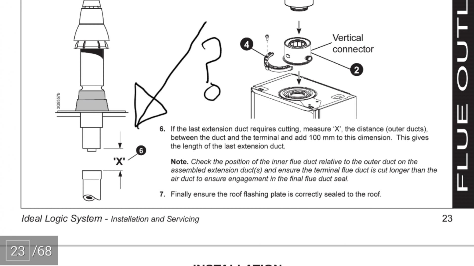

Can someone explain to me how this cutting measurement works? So I have a flue that is too long, where do I take the measurements from to cut? Sorry if I am being dumb. I just can't make sense of it
Ah ha, I think I have got it now. This means if I want to slot a piece in to the middle where the X is marked. Am I correct
