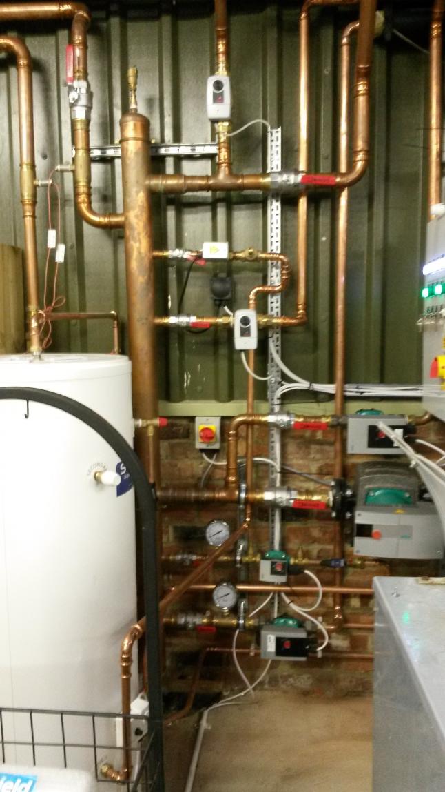

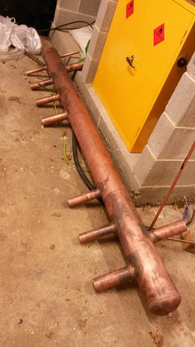

20141128_155813.jpgVA heating are the kiddies, we use them for all our LLH. Excellent service, they even drove 3 hours each way from stoke to darlington just to deliver ours so we could have it first thing rather than wait for TNT, cant do better than that:hurray:

Use a nice bit of 4" box . Flow and return 500mm cts on one side circs 750 cts and getting further apart on other side? 1/2" top and bottom for Aav and doc
