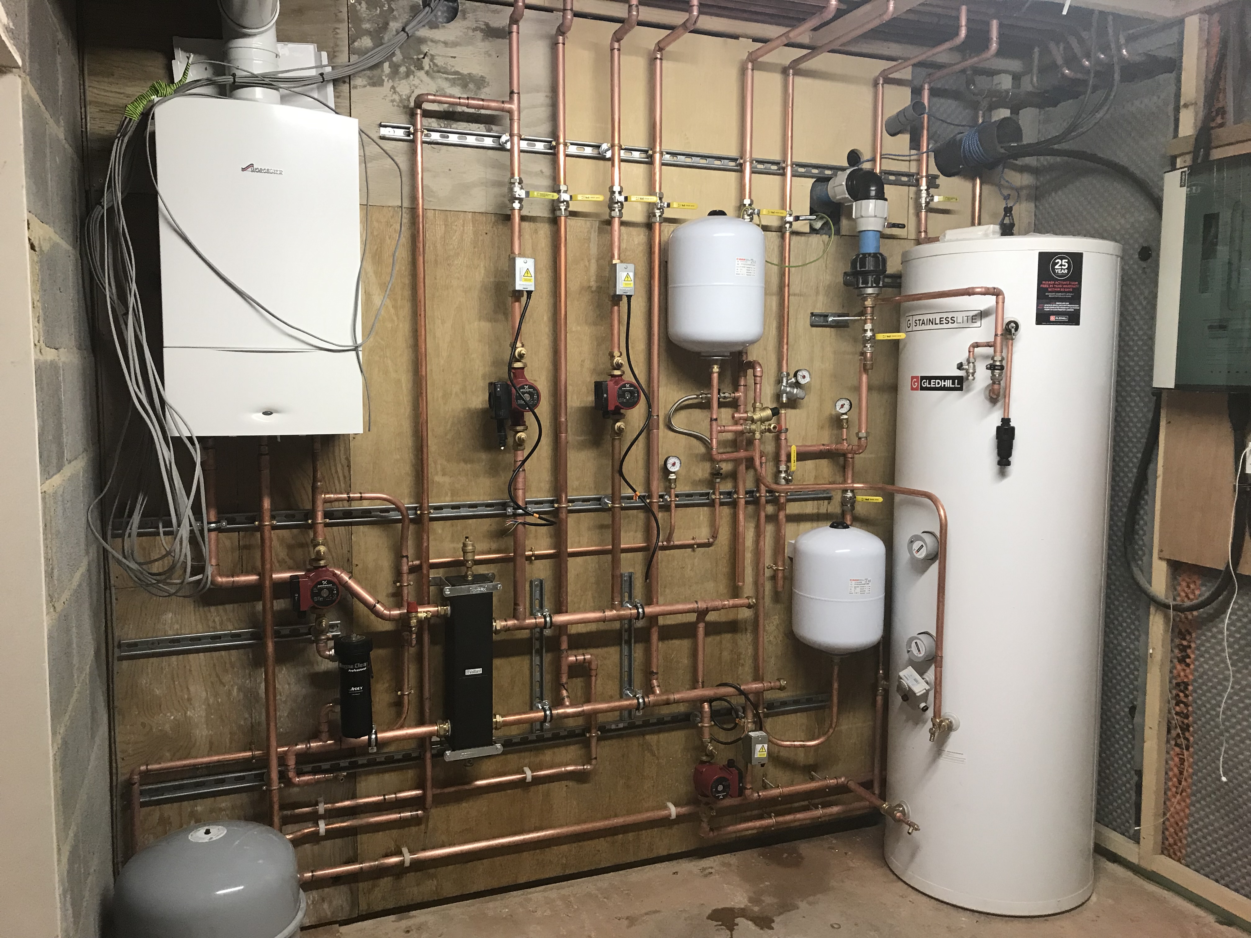

Made a start yesterday people
Reactions: Scott_D
Is that 15 mm pipe tee'd in after between pump and Boiler for the F&E (fill or feed and expansion)?
If it is, I would have placed it behind the pump.
It won't make a huge difference in all honesty due to the Header but I still think it better to do it that way. Others may disagree with that of course. We all work our own way.
Yes, it’s actually a 22mm for the expansion vessel and the prv point.

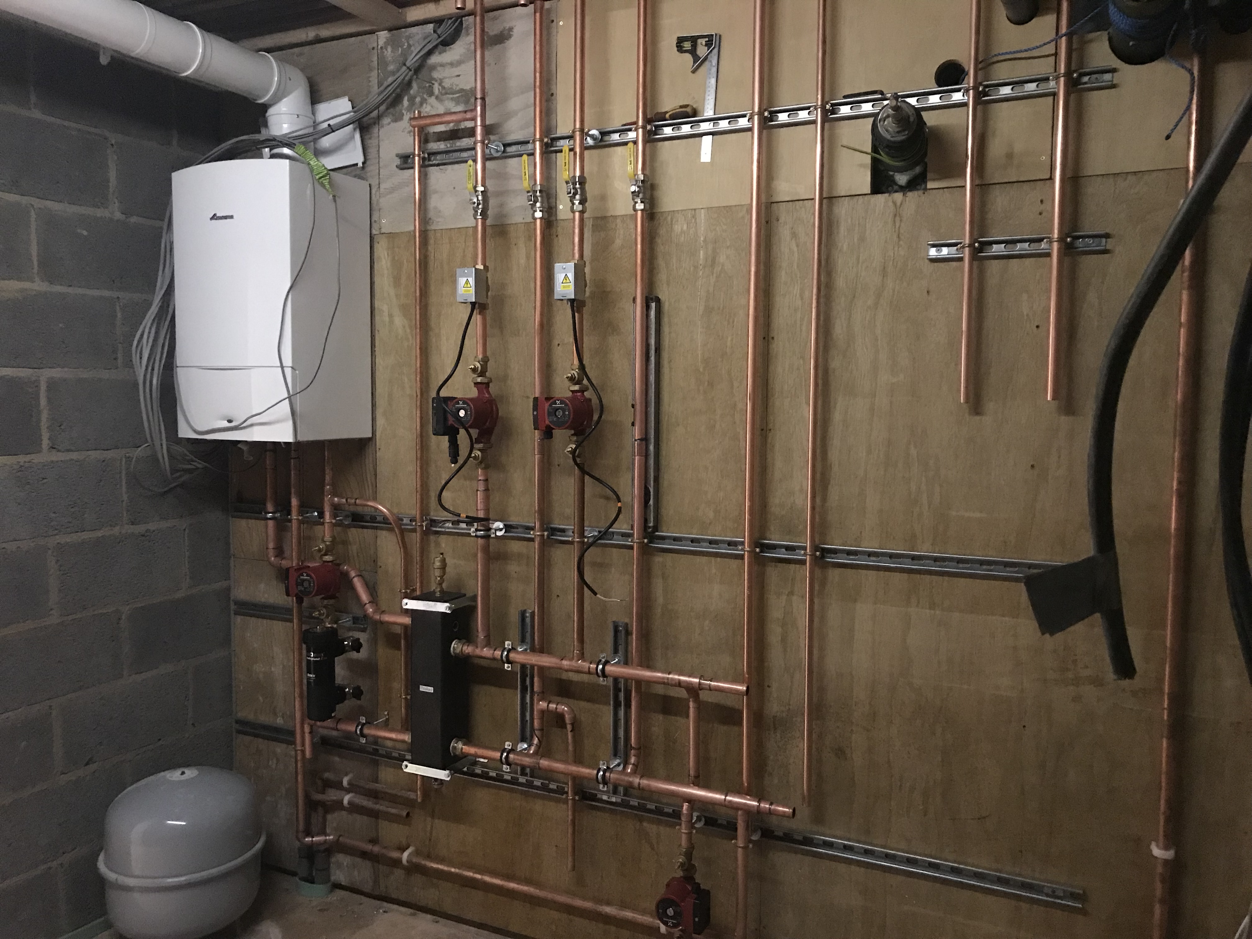

Third days progress, been slow today...as I’ve been connecting all the pipework in the false ceiling above. Up and down flipping ladders all day. Can I ask you good people if 1.5” solvent weld waste waste pipe and fitting would be suffice enough for the outlet from the Sanicom2?

End of week progress. I’m still waiting if stuff to arrive, was hoping to get filled up today.... but I didn’t fancy filling up on a Friday.... for obvious reasons
