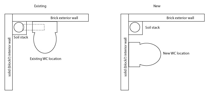

A family member who does mostly restaurant kitchen plumbing is helping up with a bathroom remodel on a newly purchased house. The trickiest part is moving the WC to the adjacent wall, so I need help to advise him of the most practical solution (or else I'll be calling in an expert!).
Here's the plan:
We haven't completed purchase yet, so not sure if soil stack pipe is cast iron or plastic. So my questions are about 3 scenarios:
- If it's a cast iron pipe, how do you make the branch face the other way? Saw out the branch and weld in new one?
- If it's a plastic pipe with branch glued in, do you cut out the branch and fit a new one, or somehow make it do a U-turn back toward the other wall?
- If it's a plastic pipe with branch not glued in, we can just spin it 90 degrees right?

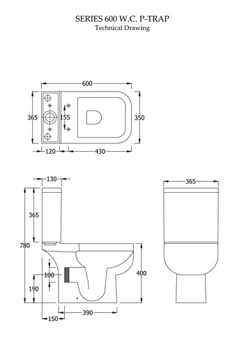

Would a WC like this give us enough space behind it to do a 90 degree bent pan connector (we don't want to channel out a solid wall).

if its cast iron it would be best to cut at ground level and replace entire stack.
if its glued plastic then you will need to cut below branch repipe new branch
if its push fit then you should be able to twist the branch around 90* providing there is not wastes conntect into side of branch
you should be fine with a standard 90* pan connector if height is about right.

dimensions on that toilet seem fine for a standard bend. if you have difficulty then a flexi extendable pan connector should do the trick
