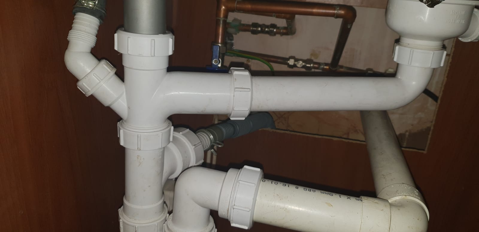

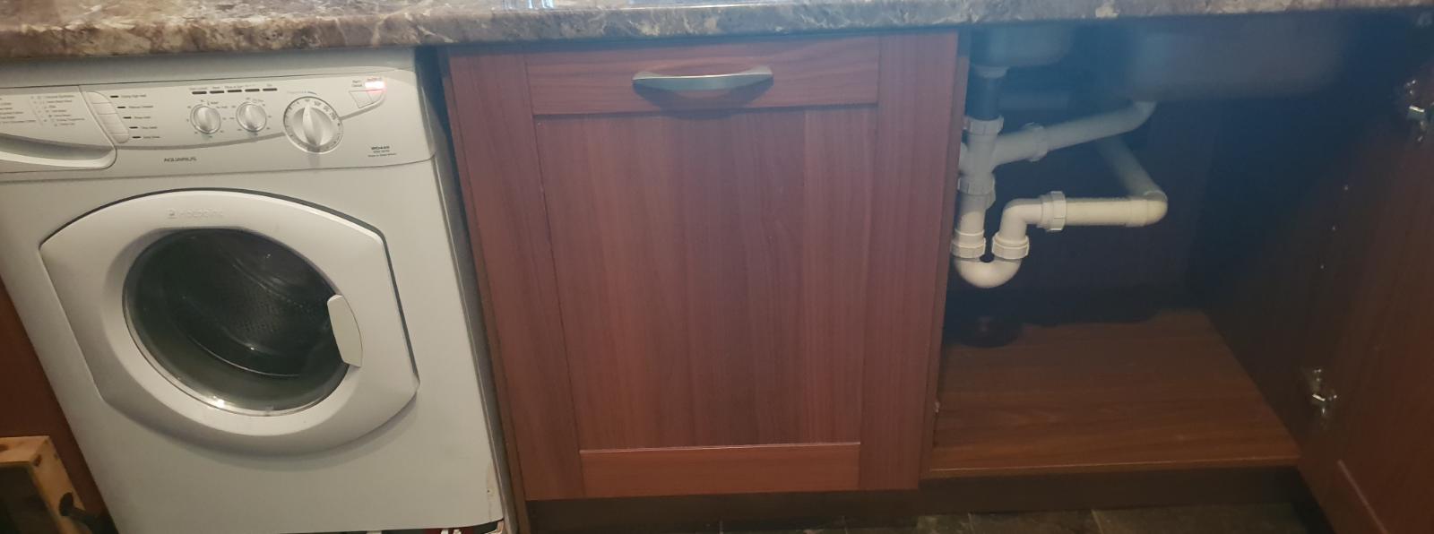

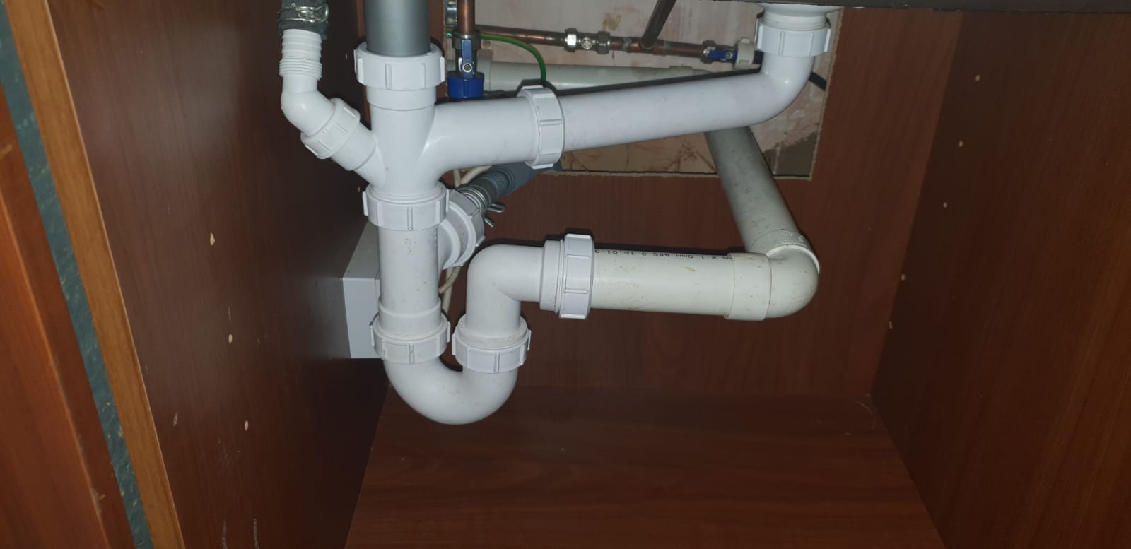

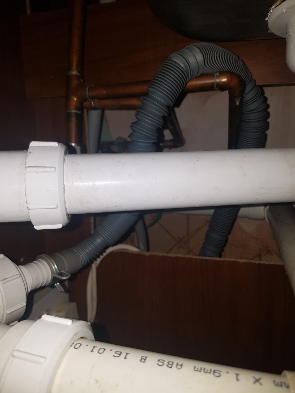

Post a photograph up of the waste pipework under the sink and waste from the washing machine.

the pipe coming from top left is dishwasher and the grey pipe from the back is washing machine, is that clear enough? thanks
Yep thanks, if it runs downhill all the way back to the washing m/c then there`s your answer.
aha ok thanks mate!
so assuming that pipe is flat all the way water from sink pipes ends up going down it. and then somehow up into the machine??
or maybe needs to go higher. hmmmm i don't wanna pull it too much incase comes out back of machine? it wont come out easy though right?
That should be fine, beware if that is a hot water pipe, and you might want to run a hot cycle through the m/c with a washing m/c cleaner on it`s own to clear everything out. 😉
yep just stuck on a 90 degree wash. cheers. fingers crossed that does the trick
