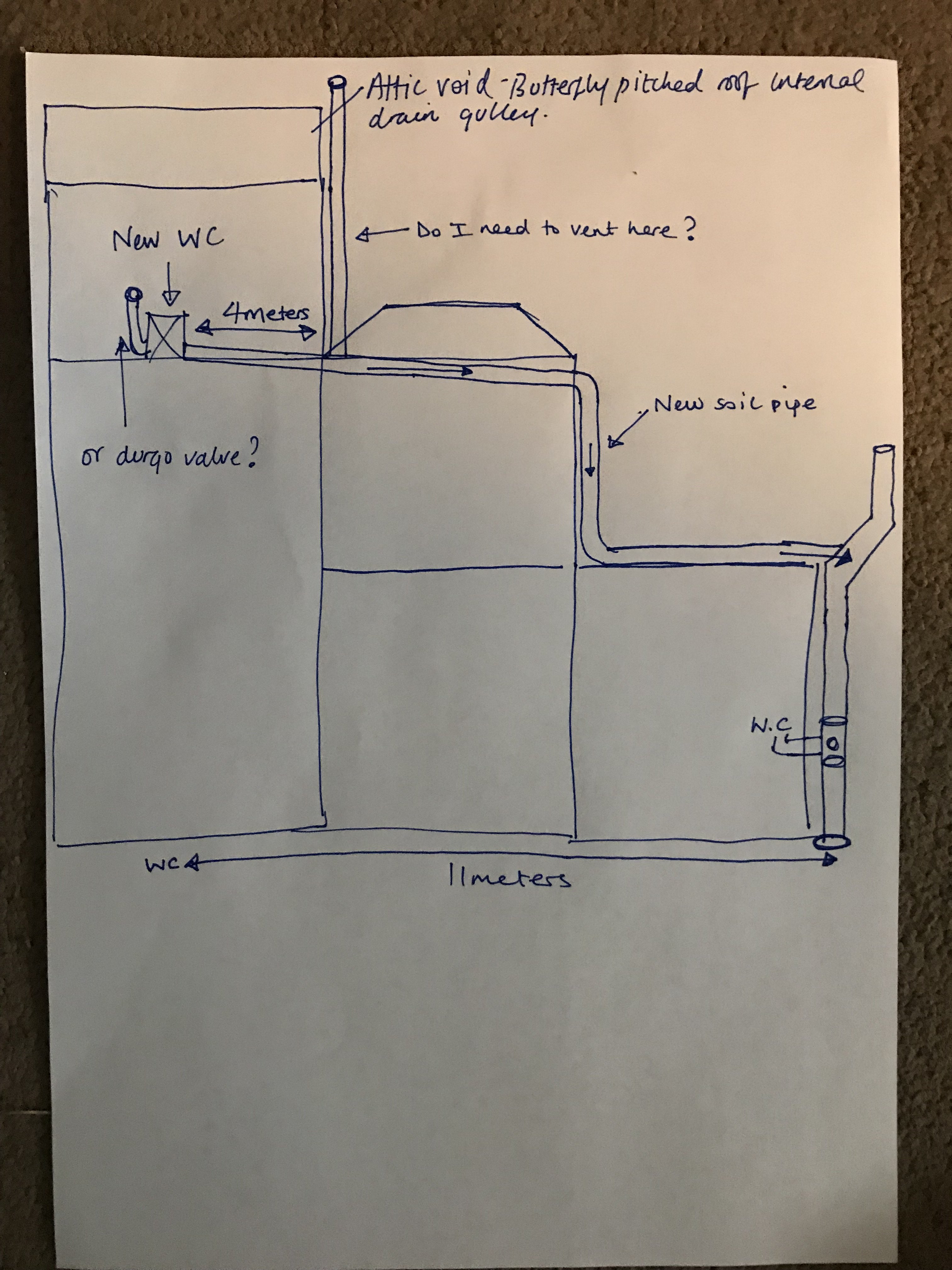

We are installing a new ensuite on the top floor of a victorian terrace. Soil stack is to the rear and we need a 11-12 meter horizontal run with two vertical drops. I understand the fall required for the horiztonak run, I just need to know if I need to add a top vent- see picture
Or can I get away with a durgo valve at the top?
Happy to run either.
Excuse the rushed drawing!
I need an expert!
I need an expert!
