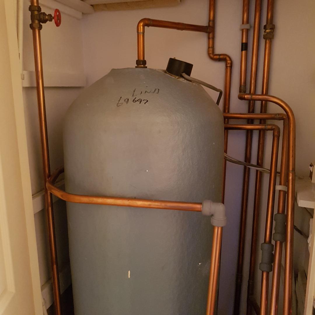

Attached are 2 pics. The horizontal pipe at 3/4 height feeds the shower.
The trouble with forcing water down the vent is if it does shift whatever is blocking the outlet, all you are doing is forcing it back into the tank. You need to remove that top connection to see what's going on.
Were I in your position I’d be giving serious thought to getting a pro in dave. I wouldn’t look at blasting it all backwards with mains there may be no blockage in which case you run the risk of overflowing your cwsc as it back filsid be more tempted to drain the cwsc, drain the cylinder down to the point of the shower draw off then take apart the pipework off the top off the cylinder. You have plenty to play with there in terms of movement
After some further tests we determined that after the shower was used, the hot water cylinder was not refilling as quick as it should have been which indicated a blockage in the supply pipe from the cold water storage tank. So we closed the closed the isolator valve on the downpipe and disconnected the pipe below it. Blowing into this pipe cleared the blockage (which was probably an air lock after all). We now have hot water again. Many thanks for your help
