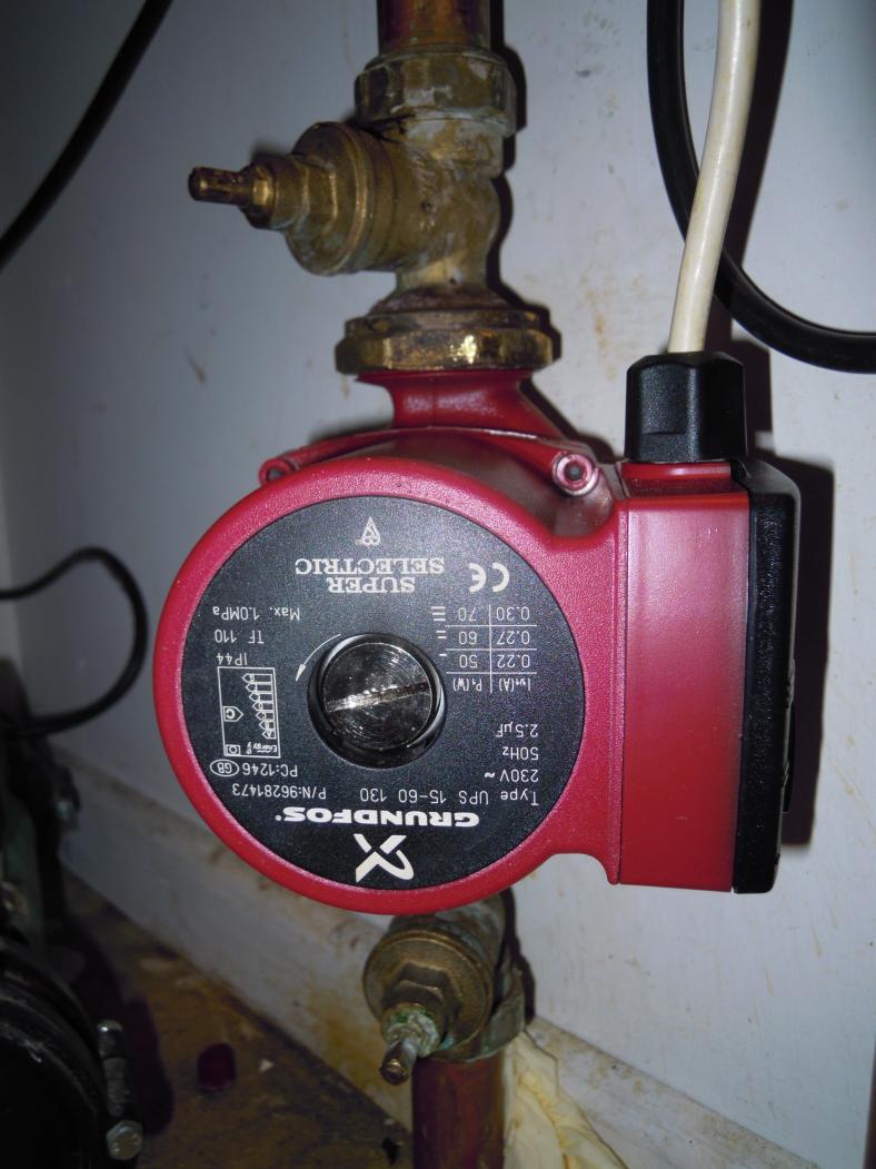

Can ou send a pic of the pump positioning? Are both pump valves fully open?
Thanks. don't think it was drained down.
Sorry, re. the valves, do you mean the 2 spindles, i above, 1 below the pump?
Yes that's what I mean, can you post a pic from a bit further away, so we can see pipe work to and from the pump.
not good to have a pump pumping down without an air seperator . as above pic from further away would help
Am I missing something, if its meant to be pumping up. It looks to me like its pumping down.
Is the motorised valve(s) above or below the pump?
Take a pic from further away and post it.
that was my thought but could be old system and on rtn
