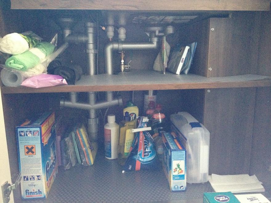

I always thought on the flow at tap might be part of the problem. Especially as new plumbing has been done or if it is a new kitchen tap. Could be debris in the tap airator, or check valve or isolating valve. Always check the simplest and most obvious thing first. I am sure the OP won't mind extra water flow from the tap to increase the speed of hot water delivery.
Probably a crappy tap... Normally great flow on the cold but the hot comes out like jet in the centre of the spout on the ones I fit...
