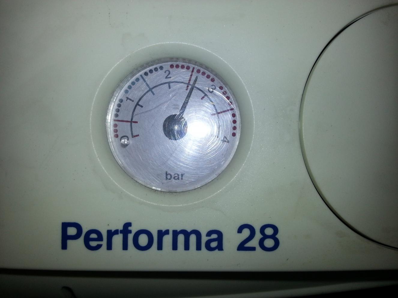

Potterton Perfoma 28 Boiler, 7 years old from new, in the last 6 months the boilers pressure has been at or below 0.5Bar, the hot water tap would go from scorching hot to tepid to luke warm in a space of a minute when run on full.
Tried topping up the boilers central heating system through the filling loop which was already attached? so i followed the procedure by switching the boiler off, and with the system at cold i opened the cold filling loop valve to 1Bar, bled the radiators, (the highest Rad had lots n lots of air trapped), then filled back upto 1Bar. Ran okay for a day, although i cant recall what the hot water tap was like at this stage.

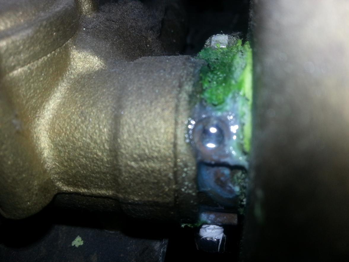

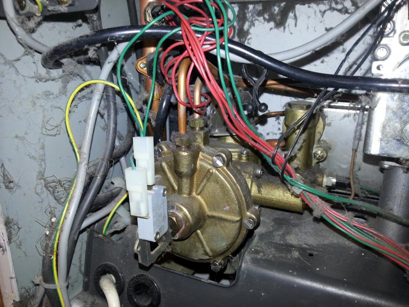

inspected the boiler with the front cover off and found that the differential valve body was leaking where its connected to the 3-way diverter valve body.
Now, this isn't my boiler, but the company who is contracted to maintain and service this boiler for a family member has told a member of my family that they need a new boiler, just after they 'serviced' it. but all they did was scrape the limescale build up on the heat exchanger plate. A while after this another boiler engineer of a big firm (i wont name names), came round to my familys household to perform another 'service' but shortly after leaving they left my family without running hot water & central heating.
After i inspected the boiler to see why the pressure keeps dropping i narrowed it down to this. See attached Pictures
I notice that the green sludge build up is a form of bacteria, could be giardia? at worse case? so i can understand that this is a health risk.

That boiler hasn't been serviced in a million years, and you shouldn't have even taken the case off.
Best advice is get a GSR in to assess the problem and avoid using british gas/the big firms. Just because you think that's the problem doesn't mean it is. Leaking diverter won't cause no heat and HW on its own. The leak may be the result of other problems. The pressure should not be at 2.5 bar, too close to the limit.

Diverter valve parts replaced (diaphragm & Pins)

I have to admit, I re pressurized the expansion vessel, The problem we also had was a pump/ low pressure fault on the boiler, and we had to turn the boiler off, turn C.H./ DHW on then turn boiler on to 'fool' it to work and to fire up, but the other problem we are having is the pressure is on 2.7bar when C.H. is on.

What would cause the boiler to operate at extremely high pressure? I have to constantly keep an eye on the pressure and turn it off before it gets too high. when I turn ALL the rads off, it operates and hangs around just under 2bar
Thank you
Normally knackered expansion vessel. They are quite often a right mare to change and if there is room look at fitting an external one.
