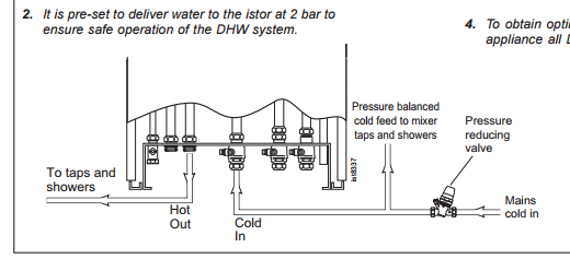

Sparkgap, yes the istor is being used for the entire house. On page 19 of the install manual it shows the PRV positioned straight after the mains inlet. So basically, the mains is instantly reduced to 2 bar. I've bought a flow measuring cup as the boiler does state to deliver DHW at up to 35LPM. I'm lucky if I'm getting 8 out of most of my taps and the 2 showers. If I adjust the PRV to say 3 bar the flow is really improved but the tundish on the boiler starts passing water. All pipework from what I can see is 22mm too. Does the boiler pump have anything to do with this? perhaps its on its way out? I will be calling out a G3 engineer but I'd just like to have an idea first before what is going on and why on earth would you limit an incoming mains water supply instantly - it defeats the purpose of getting a new mains connection doesnt if you exclude the health benefits? Thanks again

The blurb for the Istor just shows the PRV on the cold supply to the Istor, not doing the whole house. As I said earlier, all it should be doing is the Istor and any fittings such as showers which require a balanced hot and cold pressure supply leaving the rest of the house on direct mains. If the flow is restricted has the filter in the PRV been checked? As far as I can see there aren't any other filters to be serviced and the only other thing is the hot water mixing valve. If the cold or hot supply to that is restricted for some reason it would cause reduced flow.

sparkgap that's really helpful thank you. The annual service is done by a big insurance company and the last bloke didn't have a clue what the PRV was! I even had to explain it! From the new mains - literally where it joins the house - is this PRV. From what you're saying can I assume this is in the wrong place as it seems from this setup the entire house must be limited by this. I assumed from the diagram inside the installation booklet it was in the right place. From what you're saying the PRV should be situated further upstream before the boiler cold inlet and a seperate mains supply leading elsewhere? Is my setup 100% incorrect or would there be an obvious bit of pipe routing that would confirm all is ok? I've ordered a JET PRV with a clear indicator of pressure and I'm going to have a go of fitting it myself when it arrives to see if maybe the old one is clogged up and not working how it should be. I'll let you know how I get on. thanks
Looking at this diagram doesn't this indicate that the PRV is right next to the mains so the entire house is controlled by this limiter? Seems strange to be if so? Or am I just not reading this correctly?
Thanks Tom, is my setup correct then? Mains inlet, PRV then im assuming one pipe going off to the boiler and another for the mixer shower and taps?

i would say yes unless you want to run a new balance cold to all your showers and hot taps (if mixed)
thanks Shaun, I've looked over it all and it seems to be installed just as the diagram states. I'll know more when I replace the PRV - maybe it is the culprit but having said that I'm not hopeful in going from 8LPM to the 35LPM in should be giving out - particularly if the PRV is set at 2 bar.
Ideally, fit the PRV on the cold feed to the Istor. The separate cold feed to any shower or mixer valves should come off after the PRV as well to give a balanced supply. Everything else in the house should be directly off the mains and not the PRV.
