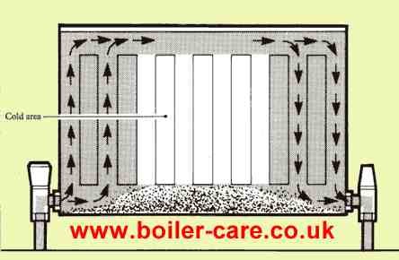

Simular to this, except not sludge obviously ImageUploadedByTapatalk1395938605.551001.jpg

McNivens picture is very similar to what is going on with the radiator, it does seem to heat from top to middle, and the sides, the area that is cold is about a 3rd to 2/5 of the radiators overall size.
