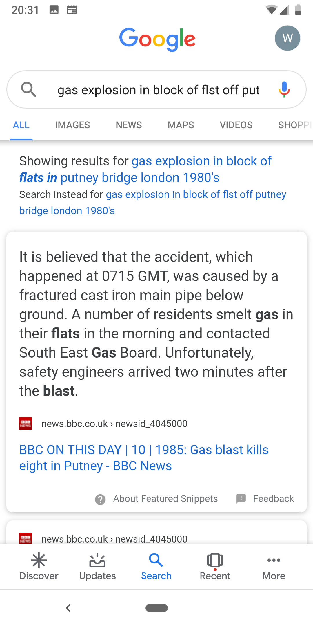

If you had any sense you would install a audible gas alarm as well ! have you seen the damage a gas explosion can do I saw one in London many years ago now it looked like a earthquake had hit frightening . Kop

Here you go this was the one
