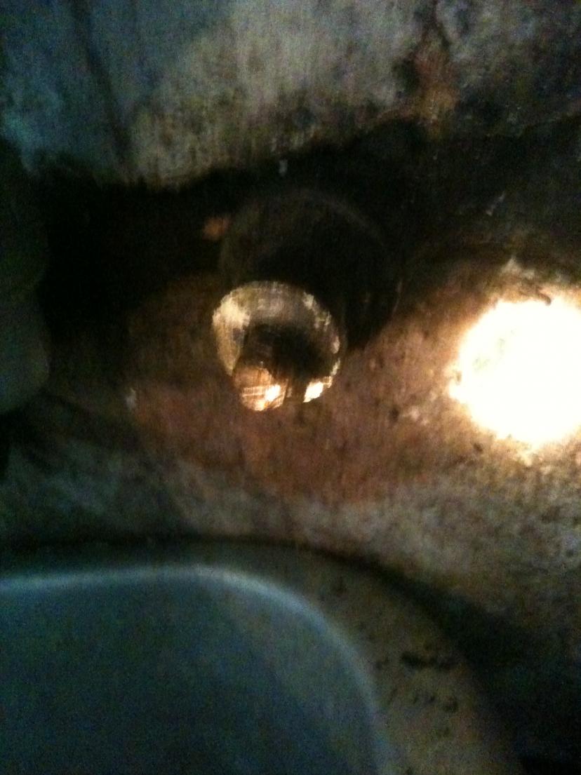

Hi guys,
wondering if any of you know a decent stockist for the above?
The stoptap is half buried in a wall and lead both sides and the handle has snapped off.
I had a couple of different sized stopcocks in my kit but they would not fit.
Took the head gear down to 2 different plumbers merchants and neither had anything close to the right size.
The cust knows the tap was there when they bought the house 45 years ago, I'm guessing it's been there a fair bit longer than that.

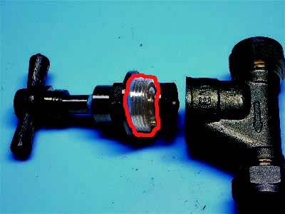

The 2 threads (the one that holds the headgear in the tap body and the one on the spindle that lowers/raises the washer) are both different to any I have found. The main thread (shown in the below stock pic of a different stopcock) is normally 3/4" but is about 1/2" on this one, and the spindle thread is a fair bit wider than the others I have had my hands on today.

Hammer and chisel needed I think.
It will probably take less time to dig out the wall and fit a complete new stopcock than it will to find a replacement headgear.
The only place that may be worth trying for the part is your local scrappy.
It has lead pipe on both sides, it only comes out of the wall for about 4 inches, then all the pipes are buried. Even the 4 inches that are visible are half buried 🙁
My first thought was a couple of lead locs and replace the whole stopcock, but there really isn't enough room and the pipe appears ovalled so would be a nightmare.
The set up of the plumbing is very far from ideal, from the stopcock we think the lead pipes go up to the loft then back down to the kitchen taps, either that or there is some very 'flamboyant' hidden plumbing inside the exterior wall of the house. Luckily the water boards' stopcock in the back street is easy to use.
I'm guessing they simply don't make these any more so will have a ring round the scrappers tomorrow.
Thanks for your help 🙂

Thanks for the input Sys, but I just need to fix this existing stopcock, replacement of the whole unit isn't in the customers budget or plans due to the reasons above i.e. lack of available pipe, they're fitting new kitchen units and wanted the current stopcock working before building round it.

Well spent 2 hours stripping and comparing stopcocks at the local scrappers and found no match 🙁
When I got back they had knocked all the plaster off the wall to reveal all the lead, I did think about 2 leadlocs to allow a copper section for a new stopcock but remembered reading somewhere that it's a bad idea because the copper will cause corrosion of the lead further upstream so ended up servicing what was left of the existing one. Apart from that I'm pretty sure it's against regs to do that.
Apart from having no handle I got it working very well and 'unofficially advised' the customer to drill a hole through the spindle and insert a metal rod as a makeshift handle for now as a stop-gap until they can get all the lead replaced.
It was a messy one, and not very profitable but got a happy customer at the end of it.
