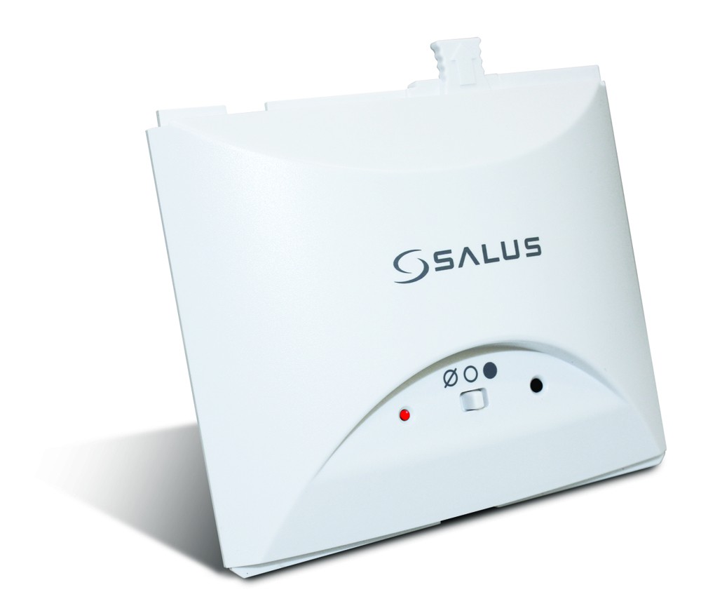

I have recently had a External Worcester Greenstar Heatslave II 18/25 External Combination Boiler Oil ErP installed which is controlled by a salus it 500BM
I understand at the time, there had been a mix up and the incorrect Salus was installed and it should have been the salus it 500 and i only found out that i had a issue when i realised that i had no control over the hot water.
I understand that the BM is only one channel and will only run on the CH.
I have spoken to salus a number of times who had informed me that i just need to exchange the receiver that connects to the combie boiler and i have explained this to the heating engineer and the merchant who ordered the part in. On Friday the merchant informed me that Salus is saying that if i want to control hot water, then it needs to be hard wired in and the heating engineer is saying that hard wiring is not an option and cant be done, So i thought i would ask you fellow members if this is true and if possible to you recommend a control system that is plug in to the Combi, set up the WiFi and control the hot water and heating from anywhere in the world.

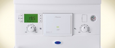

Thank you for the warm welcome, Reason for controlling the hot water is Because we only use the hot water twice a day, early morning and late evening, plus we are out of the country half of the year and it would be nice to be leaving where ever and switching on the heating before coming home and at the moment the hot water would be on for all the time we are away wasting oil. The receiver fits onto the front panel of the combie The salus replaces whats on the panel
