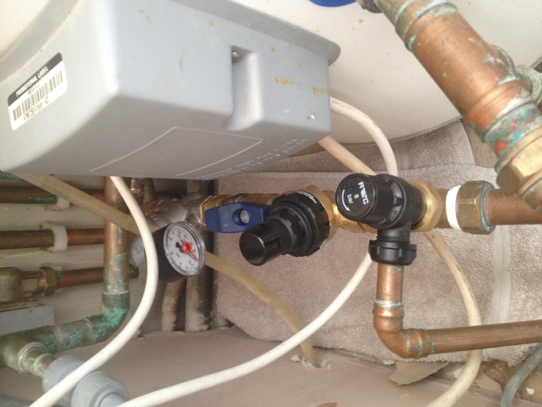

I know the noise stops instantly if I turn off the blue tap on the cold water inlet for the megaflo, just before the cold water combi valve. Does that tell you anything? I should add that that valve was changed a couple of weeks ago in an attempt to fix the problem, along with the 8 bar valve next to it.
What other valves should I check, do you think, and how would I do that?

Pressure reducing valve has been changed since all this kicked off (that was plumbers 1st guess). He even fitted a pressure gauge, but pressure never above 1.4 bar, even when noise is at its loudest. Heatrae Sadia engineer who claims noise is not coming from tank definitely regenerated the air gap. Still have the noise!

Last Q though- does the fact that closing the cold water inlet to the Megaflo (just before the pressure relief valve/cold water combi valve) causes the noise to stop instantly (and sometimes start again instantly if I open it again quick enough) tell us anything? Does that suggest the problem is occurring somewhere in the system after that inlet?

My plumber (gas safe for unvented systems) has had a good think, and consulted with colleagues, and is stumped.
He ruled out the megaflo itself (no moving parts), the zone valves and the boiler (as noise happens whether boiler on or off, even when it hasn't been on for hours).
The pressure relief and pressure reduction valves on the cold water pipe into the Megaflo were replaced after the noise started, so it's not them, unless we have had a faulty valve replaced with a faulty valve!
A shock arrestor has been fitted. And we know the noise isn't caused by increases in water pressure as the pressure stays in and around 1.4 bar. Albeit that the noise is at its worst at around 5am, at the moment.
Which leaves not much.
As the noise disappears instantly when the cold water inlet stopcock for the megaflo is closed (and doesn't happen whilst it's closed), he reckons it has something to do with the cold water system. But given that we have already spent about £600 he wants to think carefully about what to do next. Perhaps unsurprisingly, I haven't heard from him for a couple of weeks!
