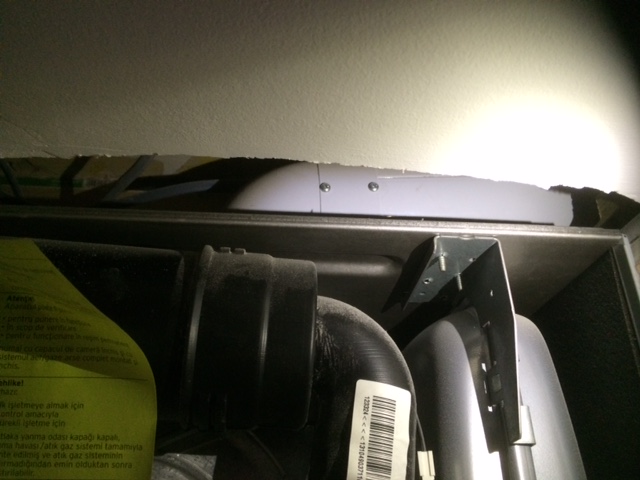

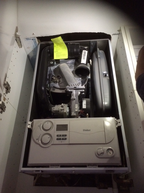

Hello. I have a question. When I had my flat refurbished, I had my kitchen ceiling lowered to add insulation. the boiler was not lowered, so now the main box of the boiler reaches a couple of cm above the plasterboard (see photo). We can get the door off ok for inspections, but a plumber has told us that because he does not have easy access to the pipes/valves etc on top of the boiler, he cannot carry out a full service (in particular the flue gas analyser checks, I think). He says the only option is to lower the boiler at a cost of around £800. Can anyone confirm this? I can expand the cavity around the top of the boiler to make it extend around 12cm or so from the from of the boiler. Does that help? All advice appreciated. Thanks

And yes by the looks of it need either lowering or an access panel fitting,

You do need access to the flue test points (x 2) on top of the boiler. You can test the flue gases from outside if there is easy access but you would still need access to the air intake test point too.
You could open up the ceiling for access but it would need to be sealed properly again to cover other regulations (building regs, Fire regs etc),
The best way is to lower the Boiler if you cannot re-alter the ceiling to suit.
Don't worry, I don't run it with the panel off! how would the access panel work? Would that mean creating a much bigger hole in front of the boiler, then covering part of that with a panel which I'd remove at servicing time? thanks
