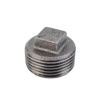

what about taking the gubbins out of the first one and putting a plug in to do away with it totally? like this
