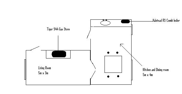

Been to a customers this afternoon who have been experiencing problems with a Tiger 944 nat gas fire (stove).
It has been shutting off between 25-45 mins of being lit.
I was at the property for about 45 mins today checking various things. (inlet gas pressure, spillage, flue flow, oxypilot seems clean) fire was working fine until i packed all my kit away and then all of a sudden it just went off.
My customer said that it seems to happen when the boiler fires for heating or when someone opens a hot water outlet in the kitchen. Could this be coincidence? When the fire is on max gas inlet is 19.8 mbar when i fired the boiler it went down to 15.9 mbar and then steadied at 17 mbar. There was no spillage from the fire so i assume that ventilation isn't the problem.
Please excuse my basic drawing skills 🙂.
Any suggestions please?
