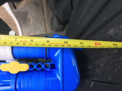

Here you go did two
First on is on max with the siphon on its lowest part (eg not much water left in once flushed)
And the second is max with about an inch left in once flushed
Hope these help
