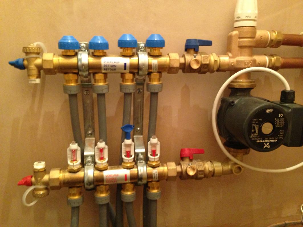

My builder recently installed a Polyplumb solid floor type underfloor heating in our house. The pipes were put on the concrete floor and then topped up with about 75mm of screed. Unfortunately at the time I did not realize you had to put insulation directly under the pipes as well. The house is built in 70s so there is a damp proof membrane and supposedly insulation on top of that and that is why he did not put any further insulation.
The heating seems to work OKish at the moment on bare screed floors, and after some time can reach around 20-21 degrees with 55 degrees flow temperature. The boiler flow temperature is set at 75 degrees. but I'm worried about the running costs if a lot of heat is being wasted heating the concrete floors up. Is this something to be worried about or not?
