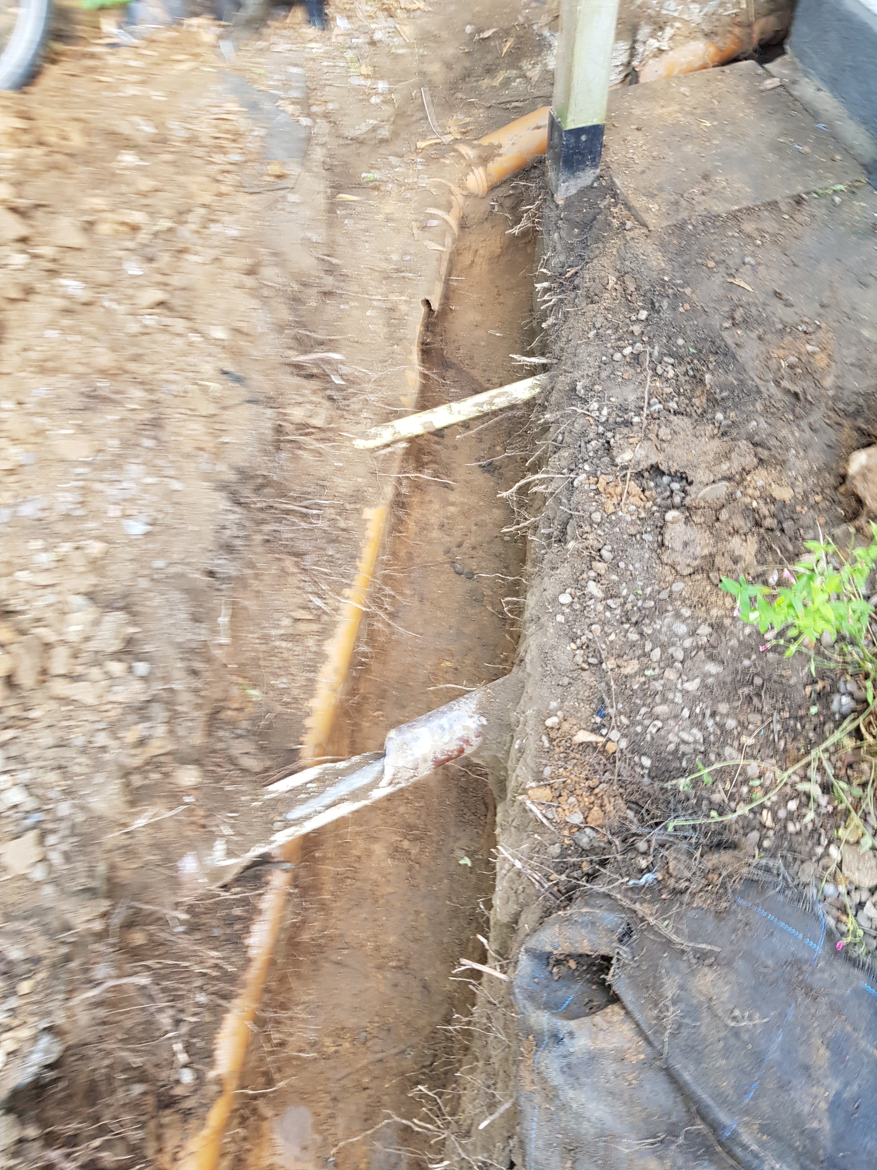

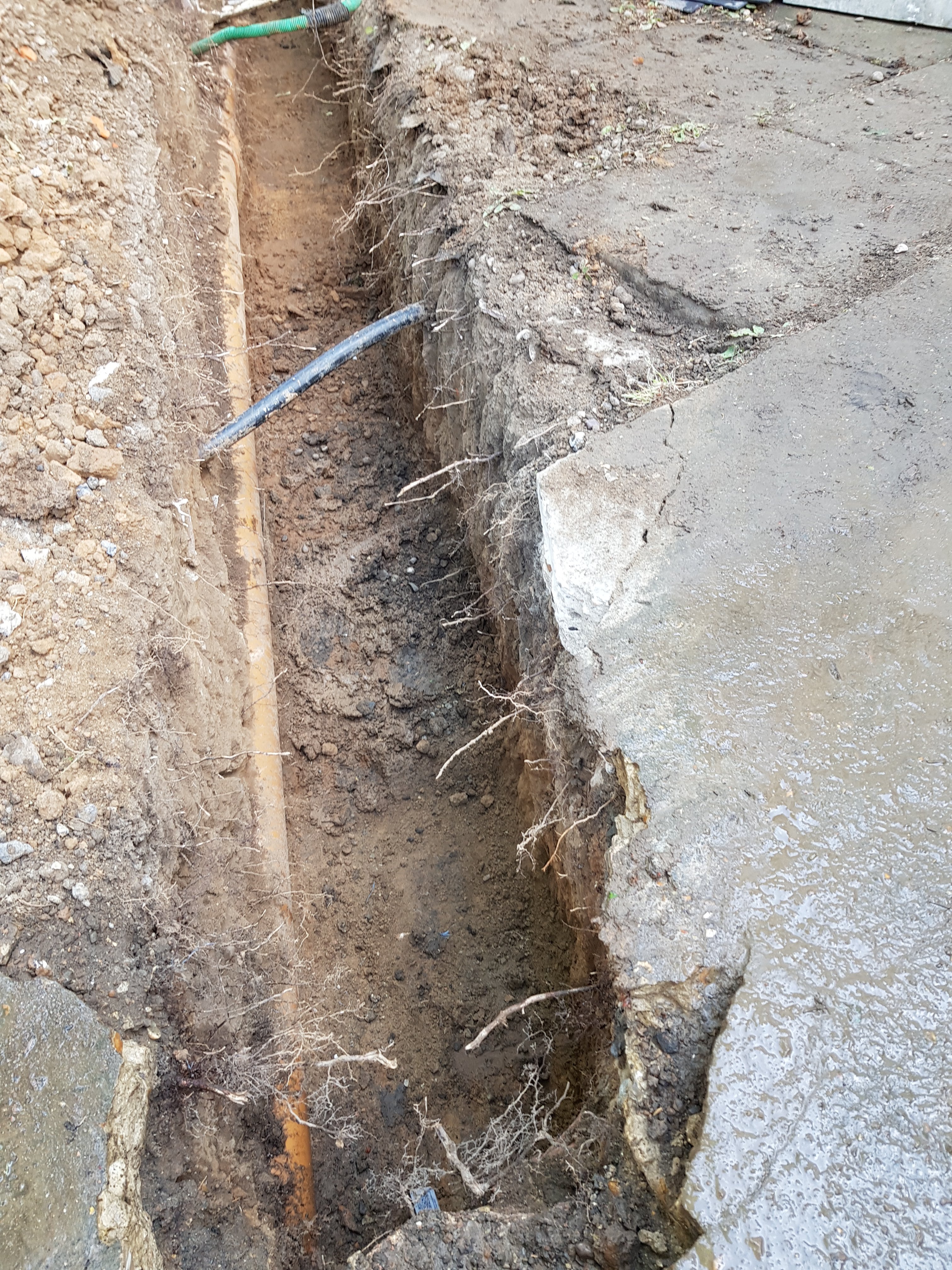

The manuals for these pipes say the trench needs to be pipe diameter plus 300mm. In some places it is impossible to achieve this due to foundations and other pipes etc.
The building Reg fees are based on the type and/or cost of the works your doing. It covers any necessary inspections and advice.
So all the worry over nothing really. The building inspector came to inspect and really was not fussed at looking at the pipe before it was buried. He didn't I had to put in a 45 underground which he did not like. Made me change it for a 90 which I thought was strange.
I had a labourer turn up on the 1st day to dig the trench, he couldn't come in to backfil due to sore hands and back. I called another one who said he was just around the corner on the bus and he never and showed up and then a 3rd one who was on his way never made it. You just cannot get the staff!
Strange thing, I have never had a leak on a solvent weld fitting and I had 2 tiny weeps on two fittings. Strange.
