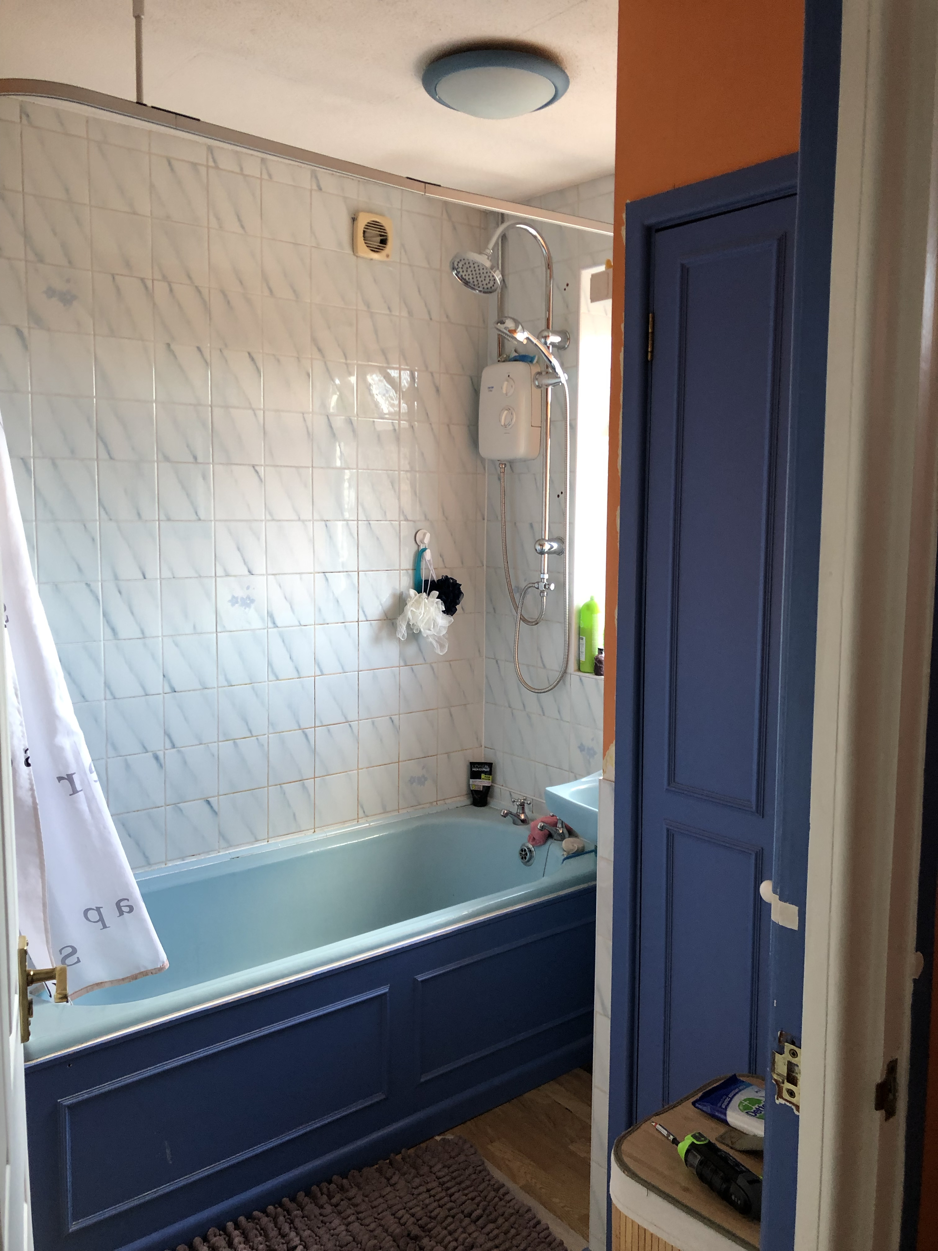

I have just done exactly the same upgrade. We dumped our copper cylinder in the bathroom and our boiler in favour of a combi boiler. I wouldn't recommend putting the cylinder in the loft. Moving the boiler will involve some serious pipework changes. Mine was an in-situ replacement with the existing pipework upgraded to suit the combi boiler. The pipework in the bathroom was re-worked after removing the cylinder and loop back to the boiler. A new shower was also installed on the circuit.
In the pictures attached, the copper cylinder was behind the blue doors in the bathroom. The second picture is as it looks now after the airing cupboard was removed.

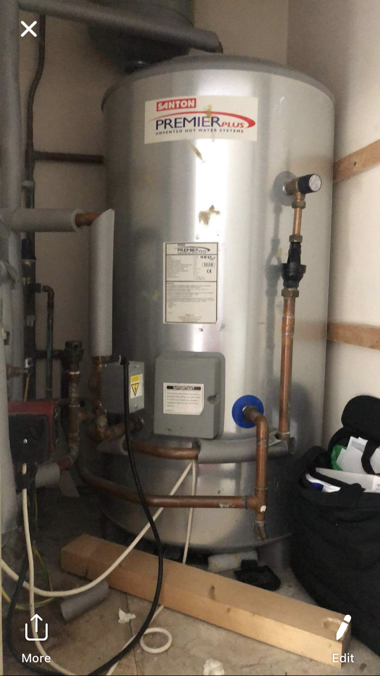

Are you sure you've got an Unvented system currently? As if you've got two tanks in the loft currently it would suggest you've got a Vented system. One tank for cold water storage (big tank) and one tank for F&E of the Central heating system (Small tnak).
If so you've got a vented system and not Unvented, which will change suggestions.

All - here are the pictures of the cylinder only - my wife can't get in the loft by herself lol. It does say unvented on it .. so i went with that.
Regarding the water flow .. i did discussed with Thames Water as British Gas have refused to undertake any works due to low water pressure. The flow at the meter outside the property is 25L/min; at the kitchen tap we had 7L/min. After some complaining and back and forth with Thames Water i have now close to 14L/min (measured it myself with the cup). Apparently the pressure reducing valve (seen at the back of the cylinder, left hand side) was not performing as it should and was obstructing the flow. Substantial improvement to be honest and i feel it when showering, and also if i turn any sink tap all the way open water jumps everywhere 🙂 So i assume 14L/min is a pretty good flow for both systems? or at least good enough to take the water all the way to the loft to the proposed new location of the cylinder?
With this Cylinder - is the expansion done inside it? As i can't see another smaller cylinder anywhere.
In the loft i do have 2 tanks, one small one big (not very big would say half meter square) - will take a pic tonight when i get home.

Well, that certainly is an unvented cylinder...question is what the eck are the two tanks still doing in the loft unless they've been disconnected and left there. Take a picture of the boiler too.
