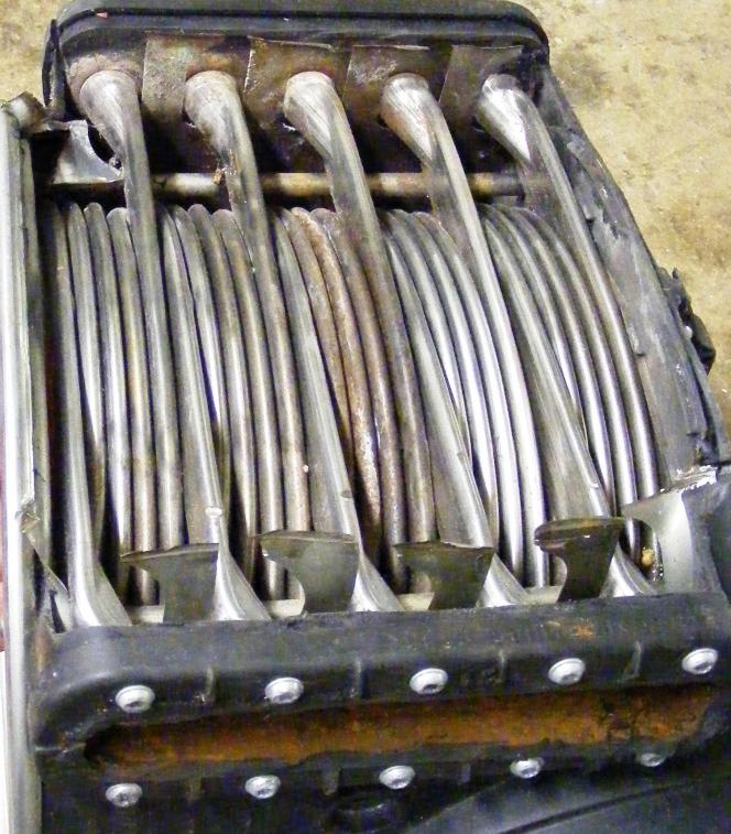

What am I.jpgWhy flushing through them is not such a good idea !
Thermocouple probably cooked ages ago, as boiler sludged up heat reflected at tc, when clean heat getting away so tc cools? Never flush modern hex....unless it's just the hex u flushing .
