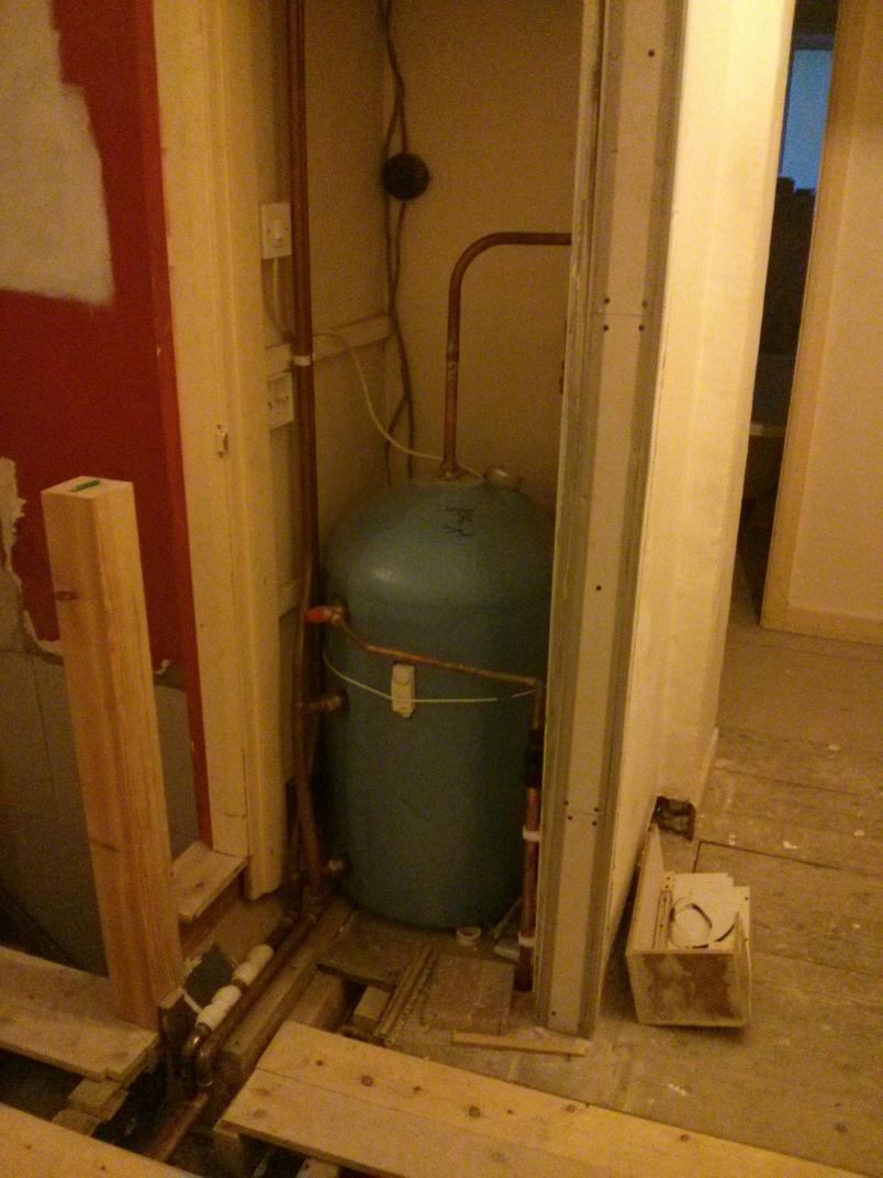

What ,ale/ type of cylinder is installed! Pics would help. If it's got a coil which drops to the base of the cylinder, it will Hebert work. The heat leak pipework should rise to the rad from the primary pipework too. If not, again, it won't work.

Thanks for your responses so far, I'll try to get some photos/more details and post later on. Flow and return both follow the same route and he says he's happy with the rise/fall of both, buy as I said the old system has a fair amount of nearly horizontal to cross a floor. I'm assuming this worked ok previously though.

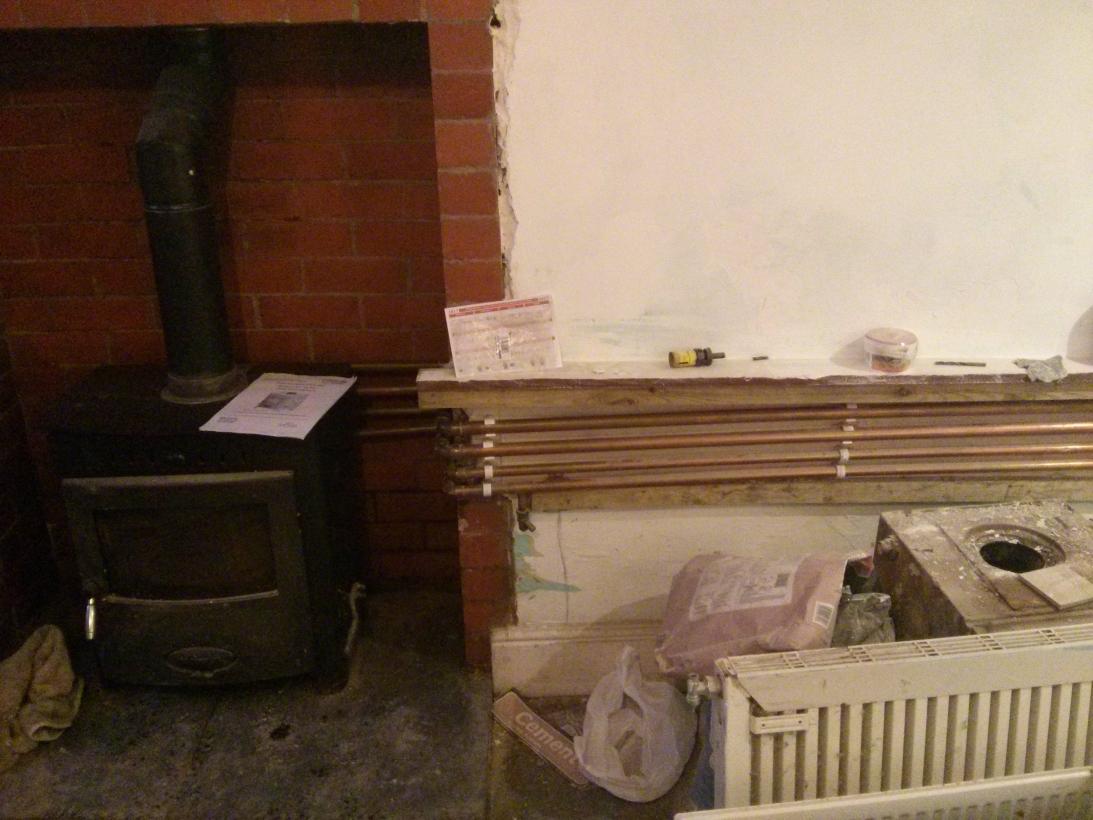

Would be good to see plenty of pictures of the stove and as much as possible of the gravity pipes. Something is serious amiss if gravity from a fire won't work!

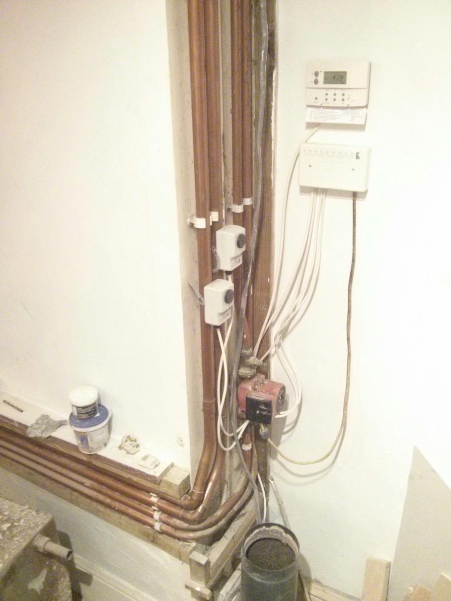

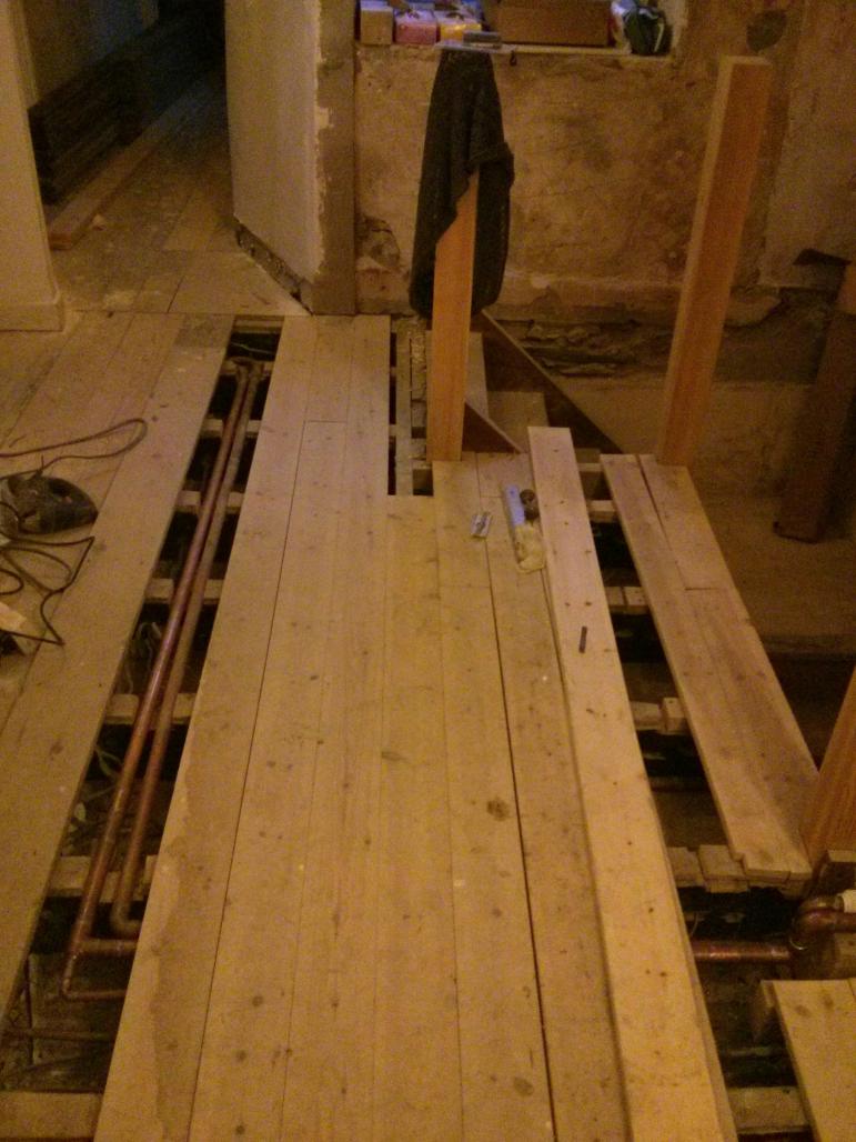

Hopefully these photos will help. So the pipes are 28mm for the gravity circuit and 22mm for the CH circuit. The system is mostly unchanged from the previous installation. The pipes run asking from the fire about 2.5m at a slight rise, then turn up to go through the ceiling. They come up in the corner of the photo that shows the floor then track along and across the floor. The gravity radiator comes off the corner nearest to the camera in that photo. The white plastic joints are where the control valve thing was. The old cylinder looked similar, pipes in roughly the same place but was about 50cm taller.
Definitely more horizontal pipe than vertical though, so breaks that rule of thumb.
The fire is a Stratford ecoboiler 16kw.
