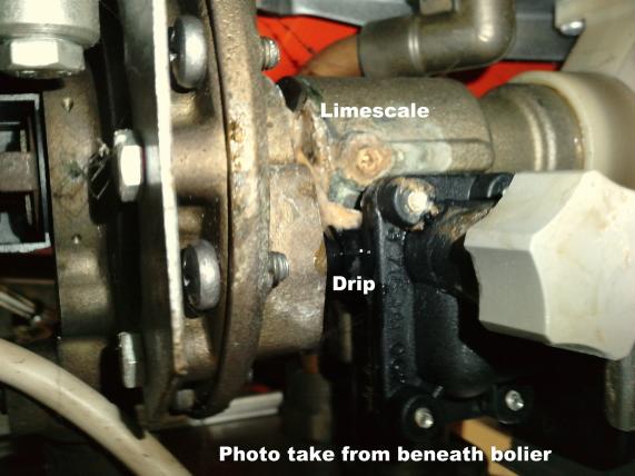

I have just been round to have a look at boiler which has a small drip.
Its a Worcester combi 24cdi and looks like the drip is coming from the where the plastic filling loop assembly mates
with the brass diverter valve assembly.
I was thinking that it could just be the o ring is gone but then i notice there is some lime scale just above it suggesting the leak is actually form the diverter valve itself. If the diaphragm was gone would a leak show out side the valve body.
Hot water supply shows no problems.
