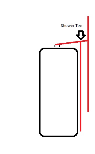

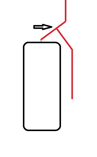

As an alternative to a flange you can Tee off the top of your tank, first connection before hot feed Tee for shower feed. For this to work you need to hot feed pipe to run at a angle and connect the shower at 45 degrees to allow the air to go up the open vent pipe and move through top of the pipe (your Tee will be at the bottom so hopefully no air will enter the pump)
first drawing is more accurate
