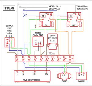

Here's a typical layout. You could have a single pump circulating through both boilers but many of them these days have their own built-in jockey pumps. Also, if a boiler fails you can put a different one in its place.
Your diagram reflects whats in the room. THanks for confirming that I can have different boilers. It provides me an escape route to non kestons and I've been suggested to look at the atags.
