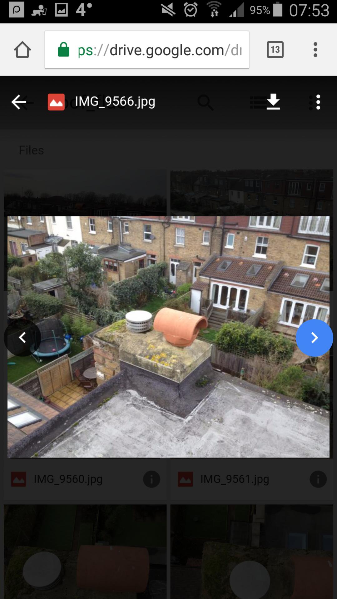

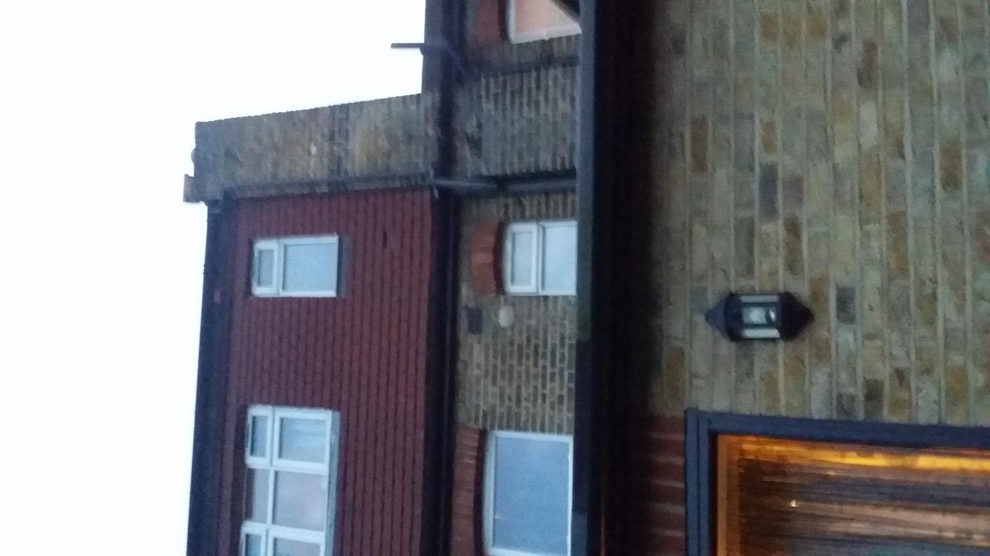

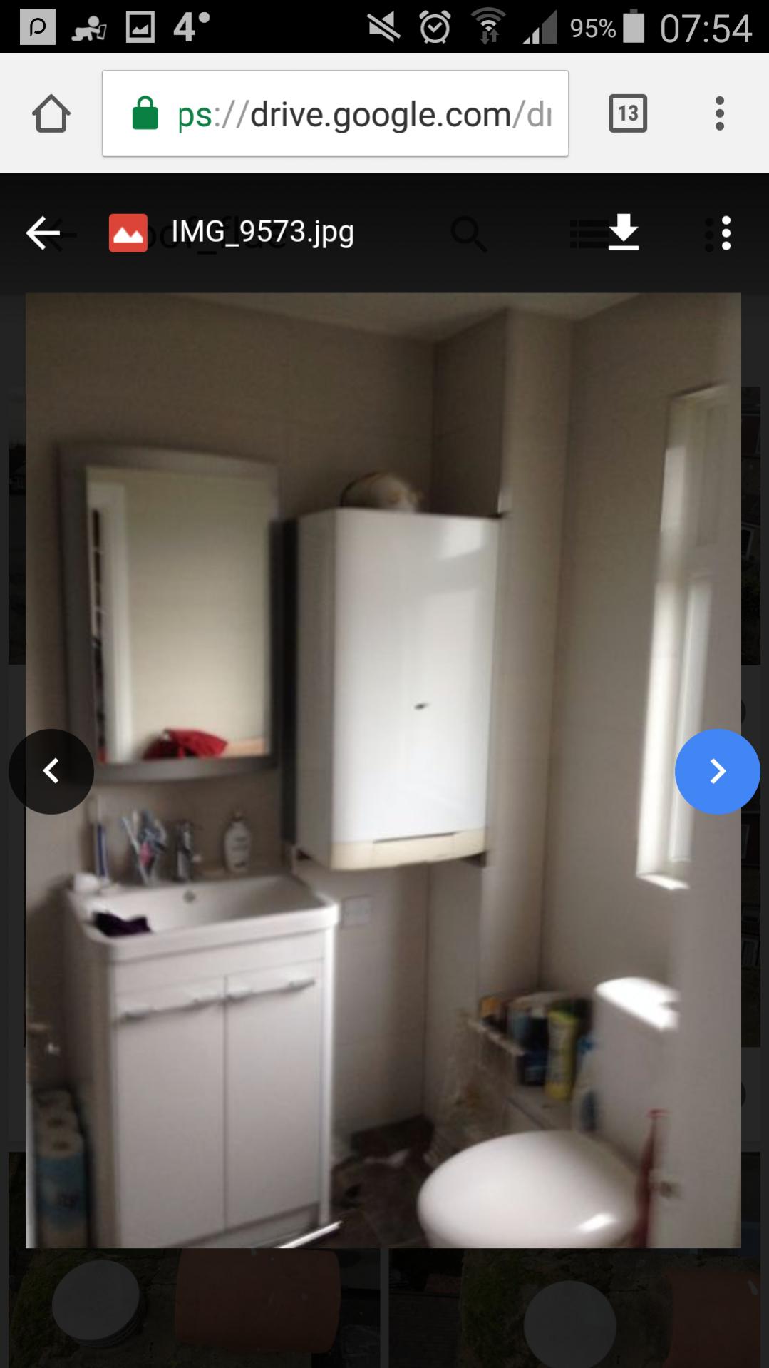

Morning guys. I have not done many vertical flue installs and am wondering what's the best way to run this flue to get the correct distance from the chimney pots. So it looks like I need to be 1200mm away from them. Is this even with the flue's not in use? Or is there a cap I can put on these If they are not in use.

Unfortunately there is no where else for the boiler to go.
Maybe you are correct. I could use a couple of elbows and go around the chimney and out by the window and then use a plume kit with extension to run along the soffit and terminate. No need for a roofer then either

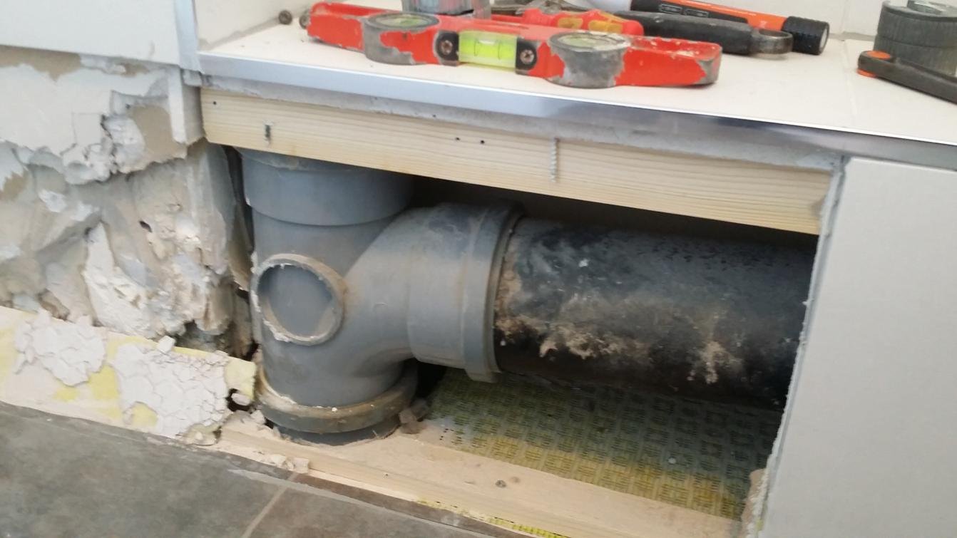

Is it possible to use a mcapline boss connector on the boss section of this tee if I remove what is left of boss connector? I really don't want to have to break all the boxing out and put a new tee piece in to be honest 20170307_114258.jpg
