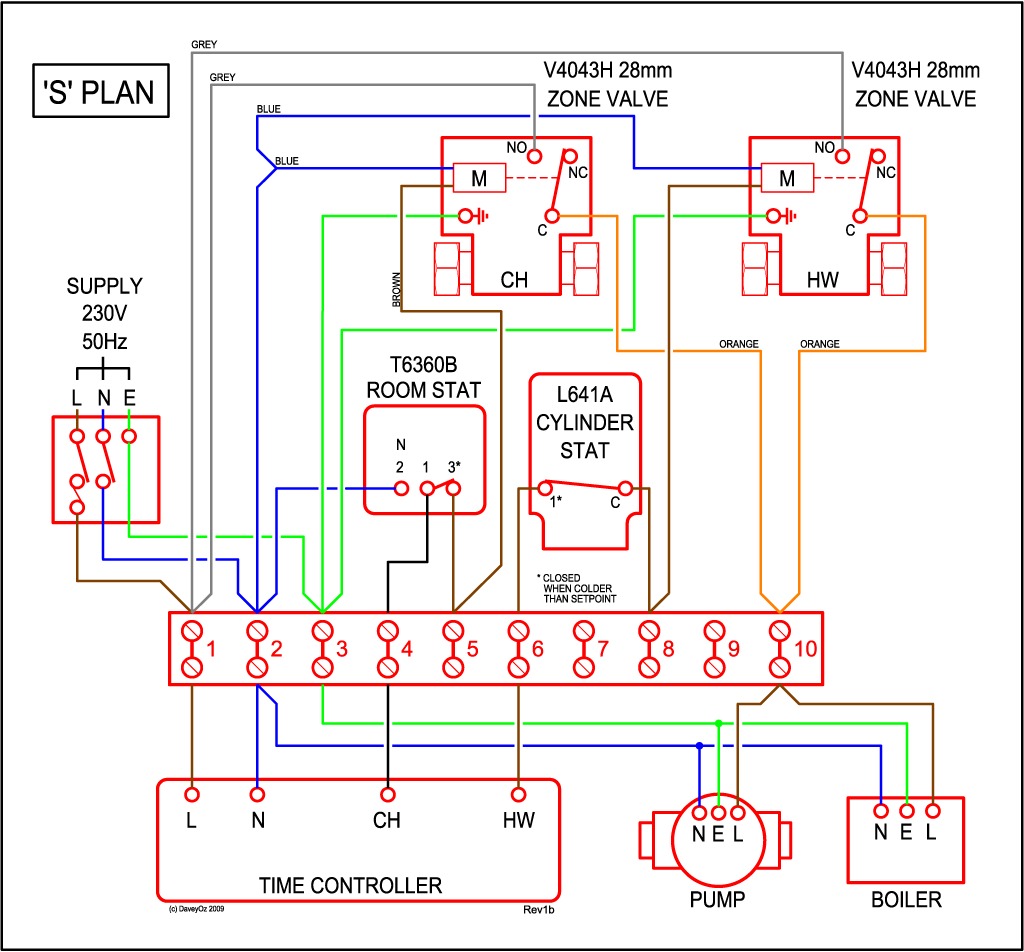

The element is the thermostat army, it will be wired to the 2 port valve to tell it to close when water temp is reached,

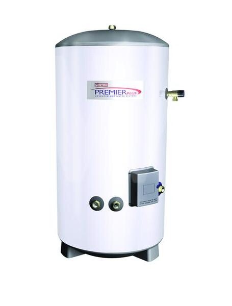

This the type of cylinder
some unvented tanks the stat is next immersion and others come with a litlle element /phiall thats inserted into a sock and bolted to side of tank but vthere will be a cyl stat

Ok that makes sense, not sure how to test, there was a reset but couldn't do anything with it. Wasn't getting voltage there though.

Sounds like thermostat , there should be cable with a pair of wires , one of the wires comes from timeclock when hw is switched on travels through the stat then the other comes out of stat down onto the brown wire of your zone valve, so check theres power coming back from stat through the brown wire, if there is then the stats fine, if not then its either up to temp or stat is gone . good luck

actually theres three stats as the immersion probably has one as well but not relevant to boiler firing i would bet on it being the overheat stat as its probably wired as a break in the orange wire hence your getting live in the junction box on orange
Going back last job tomorrow. Great, need to be in and diagnose ASAP. Will head to the cylinder and check out the stat.
i always wire the overheat stat to break the orange wire from the hot water valve ive seen them wired to break the brown to the valve but ive seen to many valves with the contacts stuck to on even when the valve is closed
if its wired the way i do it that would explain the valve working and boiler not firing
